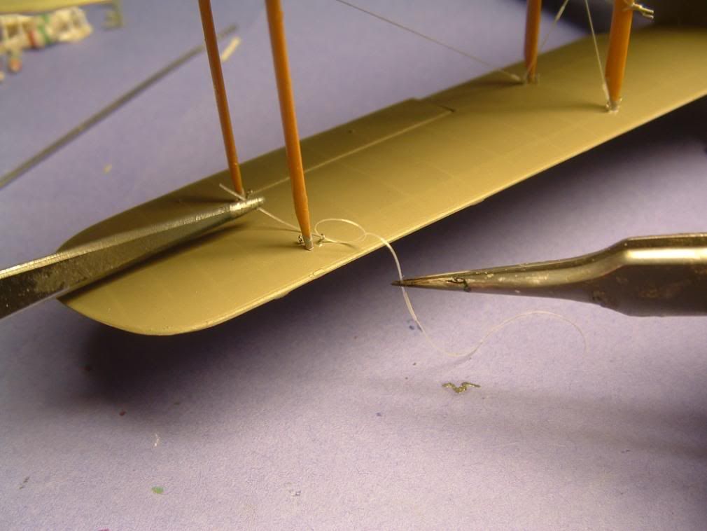

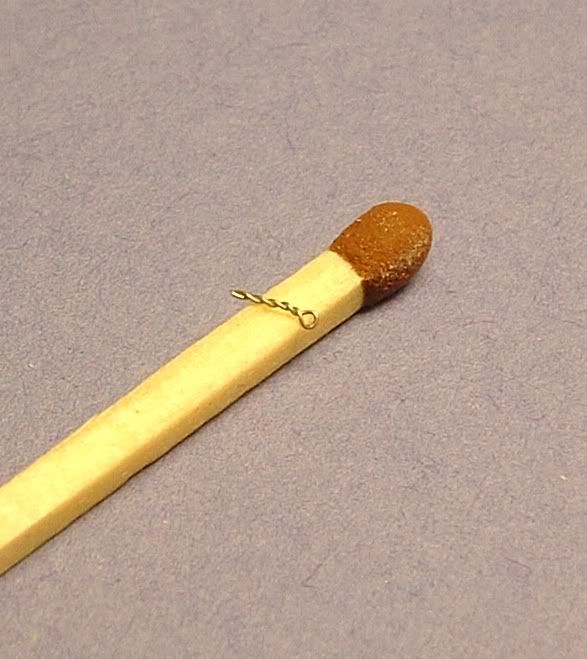

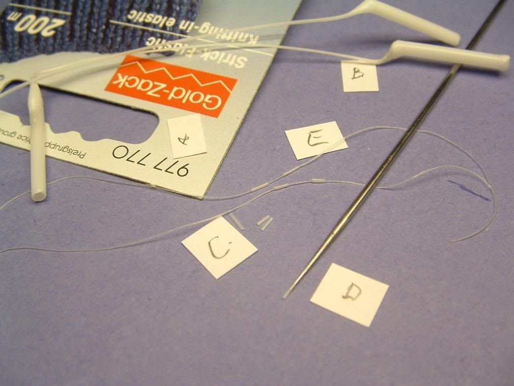

Posted: Wednesday, January 07, 2009 - 04:51 AM UTC
”Make them or break them.”
Here are those turnbuckles that make the devils in the details.
To my knowledge there’s just Bob Buckles who make these for the market. I’m always planning to get some from him, but still haven’t.
For me I’m still makes them in front off the TV. Here’s a pics off the tiny loops made from 0,015 wire twisted around a 0.20 wire.
On each model I have made about 20-30 loops. The need to feed the carpet, who’s ever that hungry.
After stretching the tube over a candle the tube itself often loses the shape off a tube, so I will every tube been cut to a 2mm length and I used airbrush needle I used to give the tube the shape again, I do this from both sides off the tiny tube.
A 10 cm long thread Gold-zack will have two tiny tubes each. The tubes is not glued until the rig is set on the plane. When the thread is secured from one loop to the other, I just push down the tube and glue them in place.
Notes the tubes just under the right tool.
When all is done just some paint to give the wires life.
So the beauty is in the details, yes, other guys have their ways to fix the riggings. This is I have do.
So the devil is in the details.
