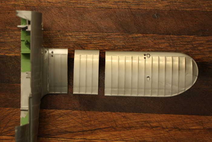

Second F3F kit has now arrived - let the cutting begin!
(Or how I extended the wings of the F3F.)
The article I read instructed us to add three ribs to the length of each of the four wings. Now someone is going to point out that my "splice" is four ribs wide. I lost one rib of the original wing in the cutting, I therefore made the splice (taken from the donor kit wing) four ribs wide. I made my saw cuts just to the side of each rib then flat sanded right up to the peak of the rib, hopefully for a good tight fit.
KitMaker: 8,345 posts
AeroScale: 330 posts
Posted: Monday, January 29, 2018 - 08:37 AM UTC

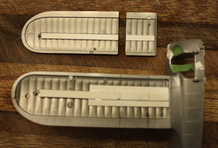

Splicing on the first wing, top and bottom halves:
Note: I had already added an extra spar to brace the lower wing (center white Evergreen strip). That was before I learned that the wing would need to be extended therefore the old bracing had to get cut as well. I then added new bracing to strengthen the spliced extension.
I would suggest making sure the splice made to the top layer of the wing is staggered relative to the splice for the bottom layer of that same wing. If the splices are staggered the overall structure will be stronger and likely also have better alignment.

One wing done - three to go!
Above one short wing and one extended wing.
I will have to do a little more smoothing to the front and rear edges of the wing then repaint.

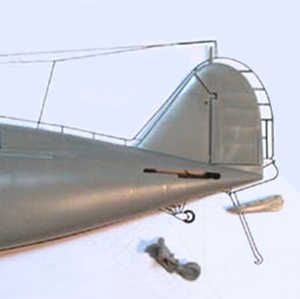

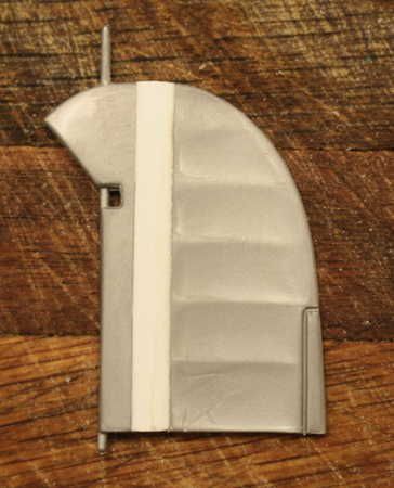

Got tired of doin' the wing thing so I thought I would get a little . . . . vertical empennage. (tail)
Right hand tail profile drawing belongs to: Rogerio "Rato" Marczak
This modified extension is certainly less than perfect as the empennage should also be taller as well as longer to exactly match the military F3F profile. As you can see, I simply cut the rudder just behind the hinge and added more length to the piece.
I plan to also extend the rear of the fuselage to match the expanded profile of the rudder.

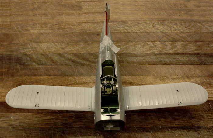

Posted: Wednesday, January 31, 2018 - 06:25 AM UTC
Here we go:
Finished - - Extended F3F wings. Here you can compare what the wings look like in scale with the body.
32 foot top wing - 29 foot 6 inch bottom wing.
