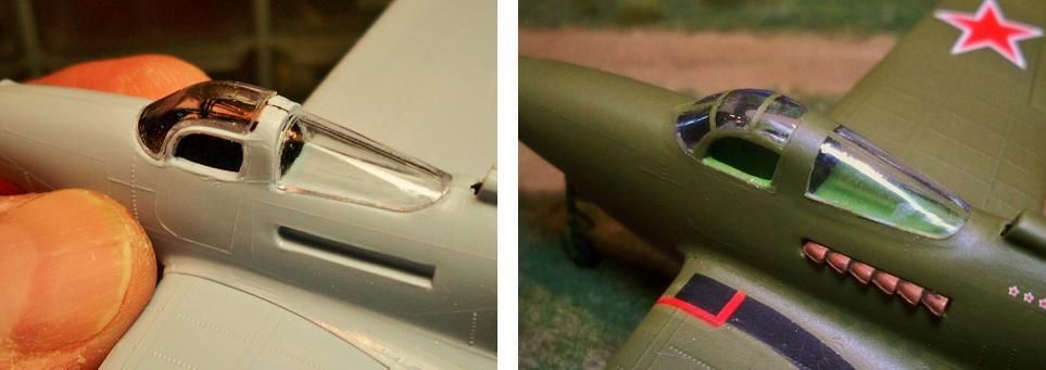

Thank you again for the advice, I did not quite believe I would be able to save those windows, they were really scratched, I mean they were completely sanded down to opaque white. I was really tempted to simply cover them up and pretend there were no windows, but decided to accept the challenge. It turned out the process took mere 15 minutes. Thank you so much! Here's the fixed part after painting:

Don't worry, all you have to do is invest the time and effort to buff it out. I put together an old Airfix P-39 with its AWFUL fitting canopy parts. I filled the steps in with super glue and rough sanded, then fine sanded, then polished the clear bits with an old cloth baby diaper until the scratches were out. Nothing fancy, just patience and elbow grease. Good luck with your Do-17!

Hi
I've made a big boo boo. I'm building an Airfix Do-17 in 1:72 scale (beautiful model by the way) and I've just realised I've messed up big time with a big clear part that forms the lower aft gun mount. It's the one on the picture (picture is not mine, i borrowed it off the internet). This part models a part of the fuselage with the round window in the middle. I've just realised when looking at photos of the real plane, that the round windiow was in fact surrounded by three smaller windows. I have not noticed that at all. Instead I've been quite liberal with the sanding, as the piece did not ft very well and then painted it over. Even if I remove the paint, the windows will be badly sanded. Is there any way to restore transparency to such a badly mistreated part?
