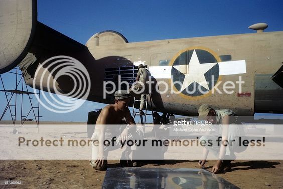

Now here is a decidedly nonstandard application of white "bars" to a national insignia with a "North African" yellow border on the insignia blue circle with white star. Interestingly, there is no border at all to the white bars (like in the Pacific theater early on) but the yellow border remains on the blue circle!
I just stumbled across this photo, and it is unique so far as I know. I've never seen an aircraft with this national insignia variation before. Maybe it's the inspiration for the decal sheet that has the yellow surround going around the bars as well as the white star in blue circle.

i dont know but in the last photo look like the white bar was added later,the star is less bright,for me the work was not finished,maybe an hour later the yellow had disappeared under a coat of blue or red,is not possible they just made a field change on a "operation Torch" star?....
