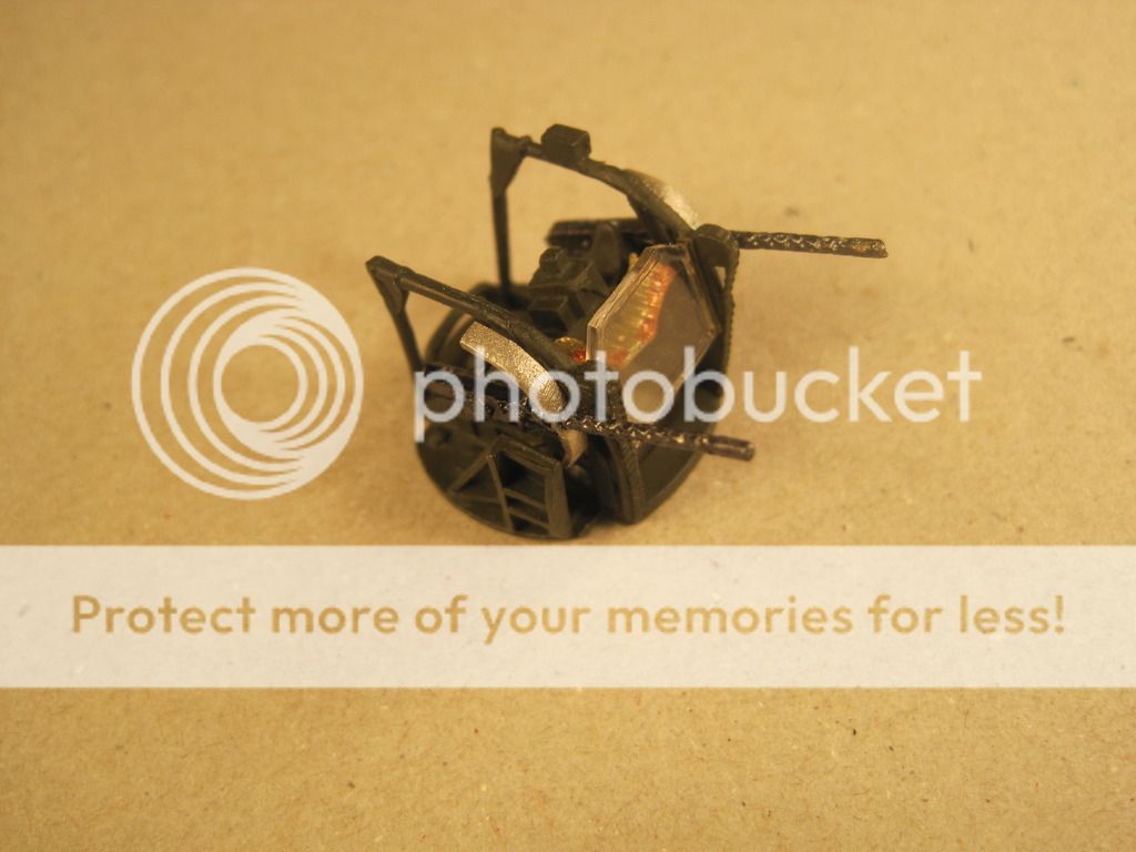

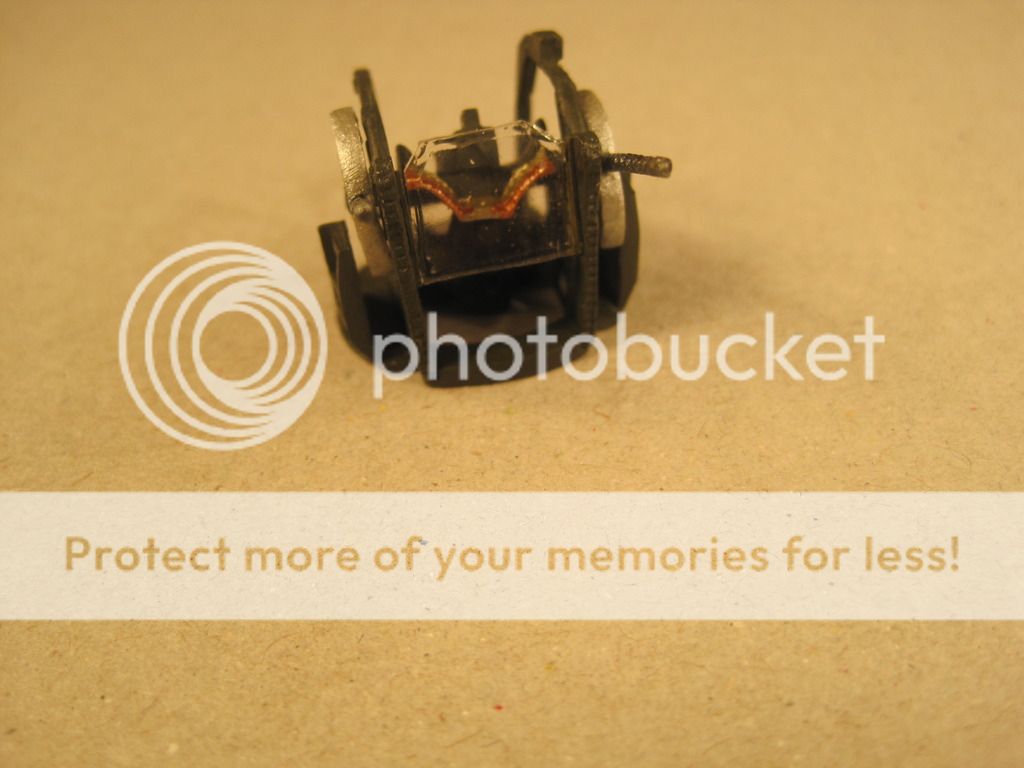

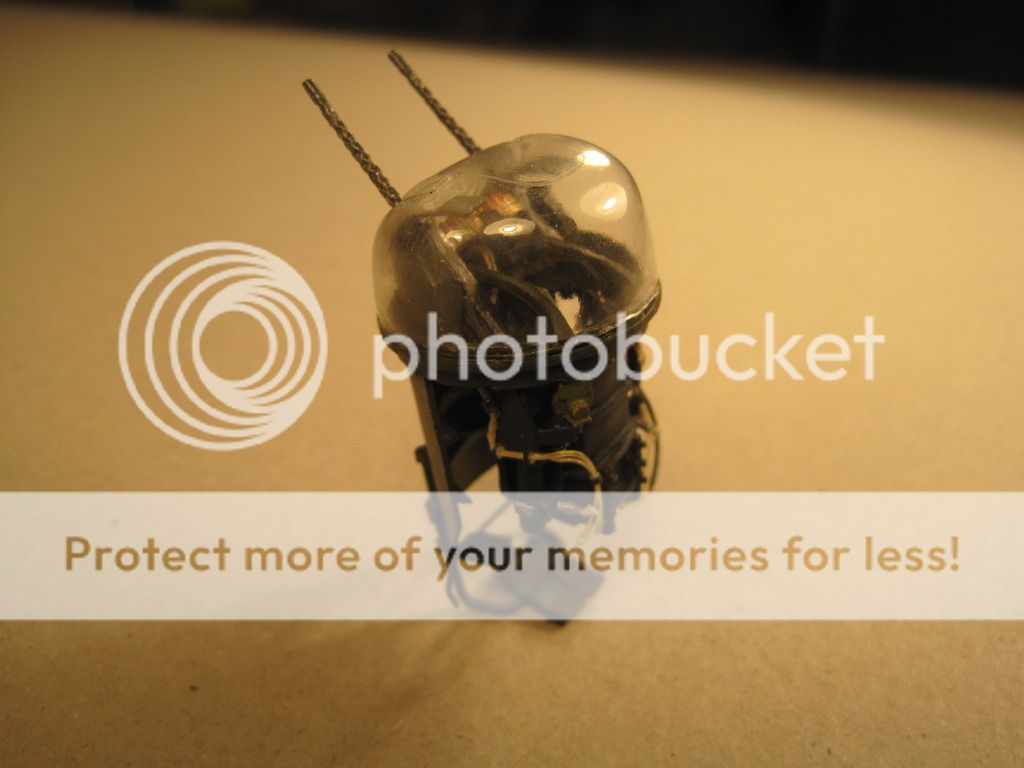

Time for an update. I haven't done too much, as I have been waiting for the Koster Conversion Kit which came yesterday. And to my delight, this kit ALSO contains the identical content as the turret kit, so I have some extra parts to work with.
I'm a bit concerned with the yellowish color shift with the photos. I think I know what the problem is, and I'll see if I can correct it with the next batch.

Tom,
The turret detailing looks really good.
the issue with your photos is your White Balance setting based on your lighting.

These are still not "true" as the resin is actually more of a grey color, but they are better. Guess I'm gong to need to get an editor program to fix the color. Any suggestions on an inexpensive program? Maybe photoshop? I already have WAY too many hobbies to get back into serious photography!

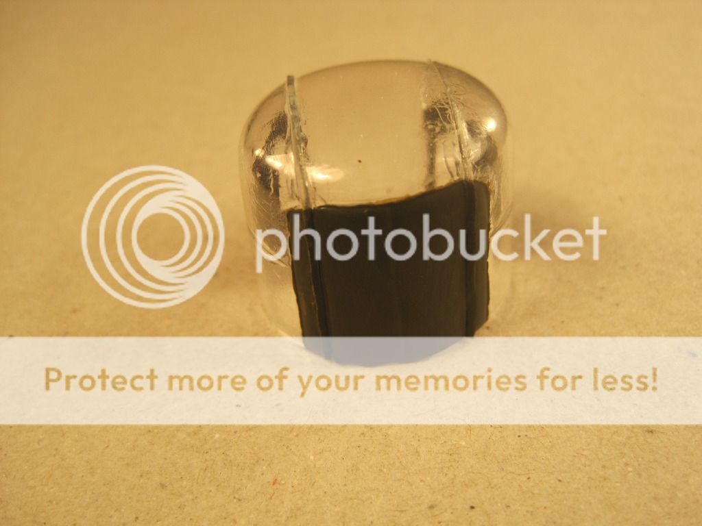

OK, so I'm using Eduard's masks for the first time on one of the turrets, and I'm a bit confused about the directions. I've applied the masking on the outside of the turret to what is obviously the part which is to remain clear. No problem. At this point, I'm thinking that I'd apply the body color (in this case OD), and then remove the masking. However the instructions have a graphic of an airbrush which says, "Interior color" then it appears to show the entire turret shaded with a corresponding block of the same color which says "Liquid Mask", and then finally there's another graphic of an airbrush which says, "Camouflage Color".
So what is all this telling me to do, because it SEEMS like all I need to do is paint OD and remove the masking.

Well you can disregard my last post. As often happens with design and construction problems, after a good night's sleep the answer bubbled up on its own. The Eduard instructions assume you are using the parts from the Revell/Monogram kit straight out of the box, and therefore, with no detail parts inside the turret, you "frost" the inside of the turret with the "interior" color" to hide the inside, cover that with liquid mask to protect it, and then paint the outside of the turret with the exterior or as they refer to it "camouflage" color.
(Insert the famous Homer Simpson: "Do'oh!")

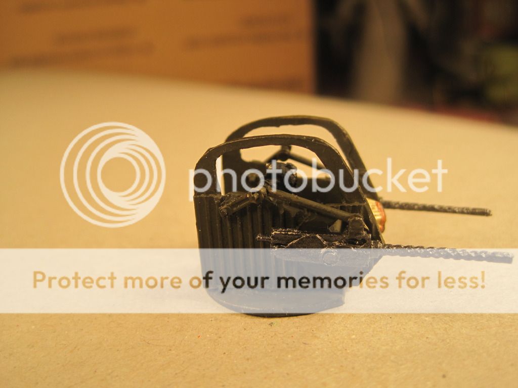

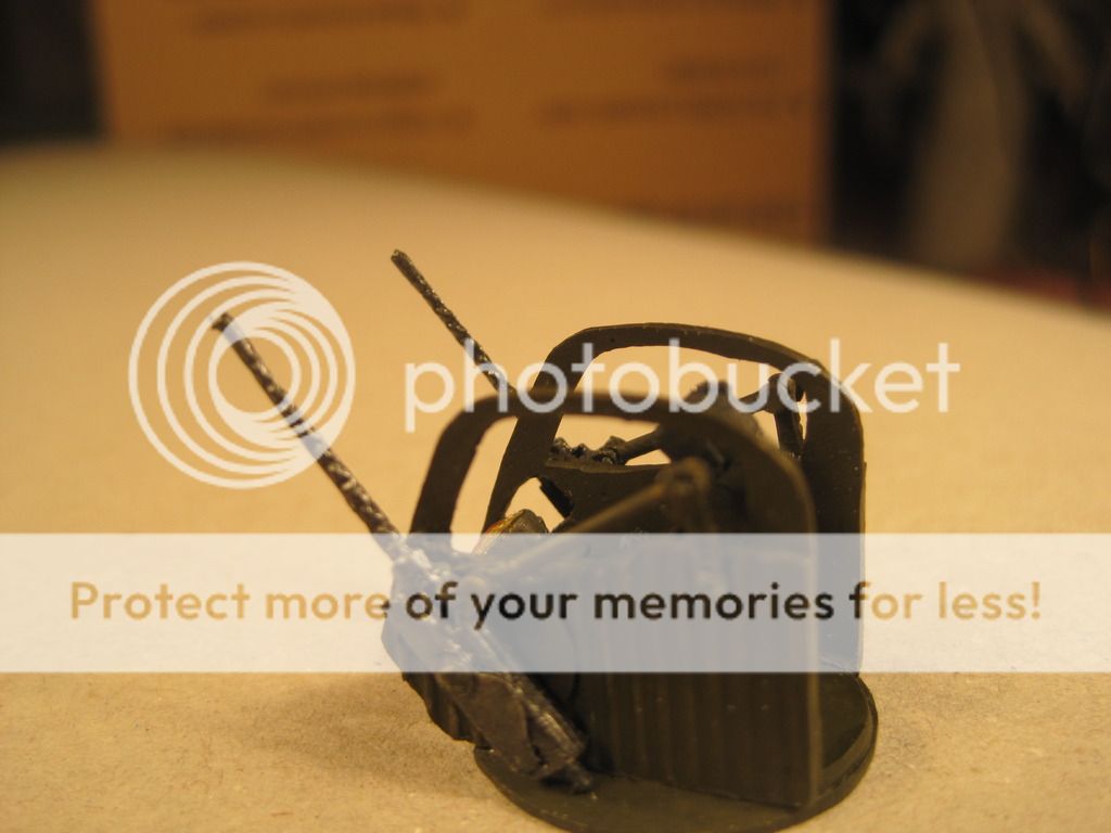

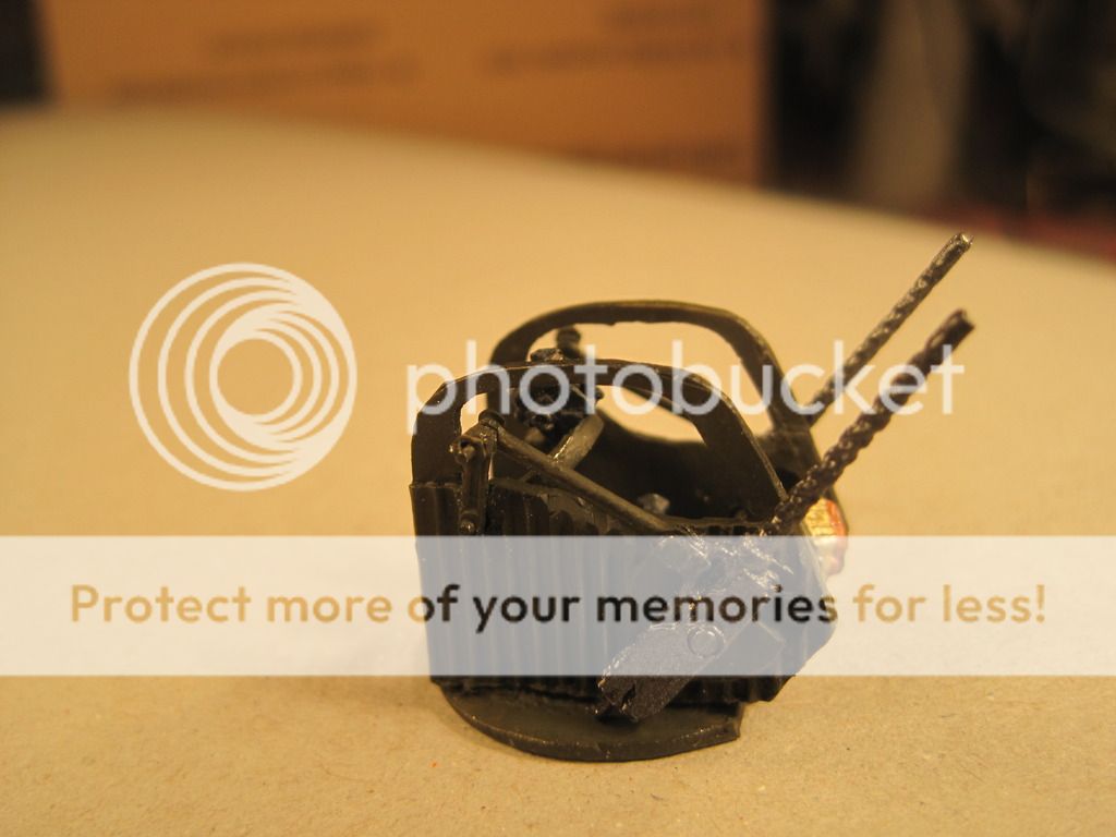

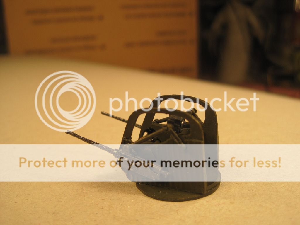

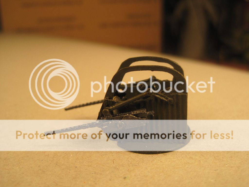

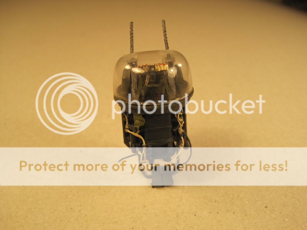

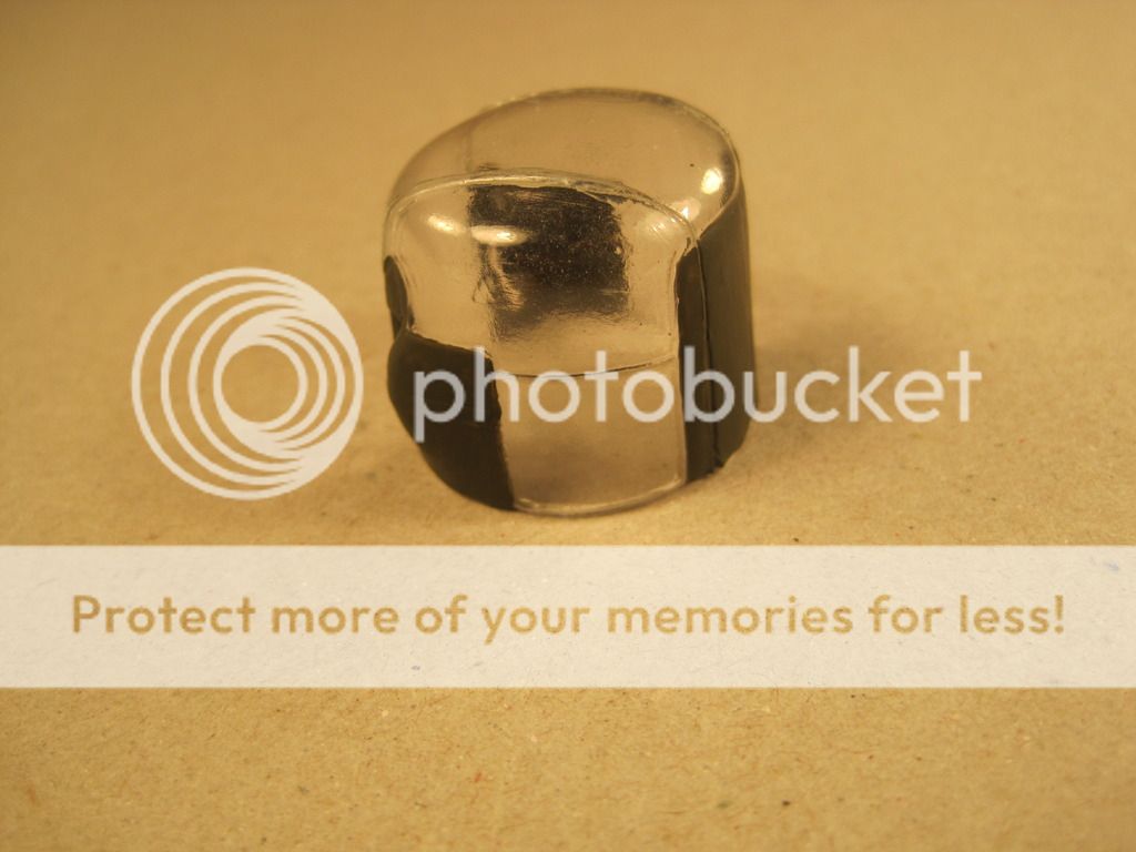

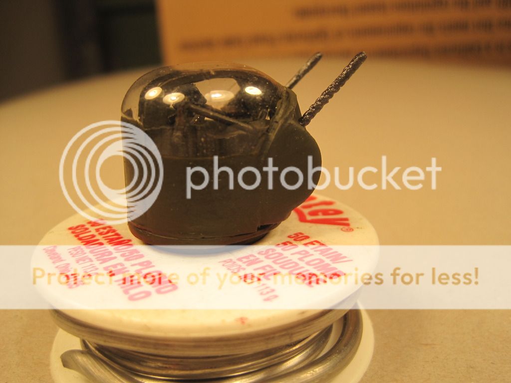

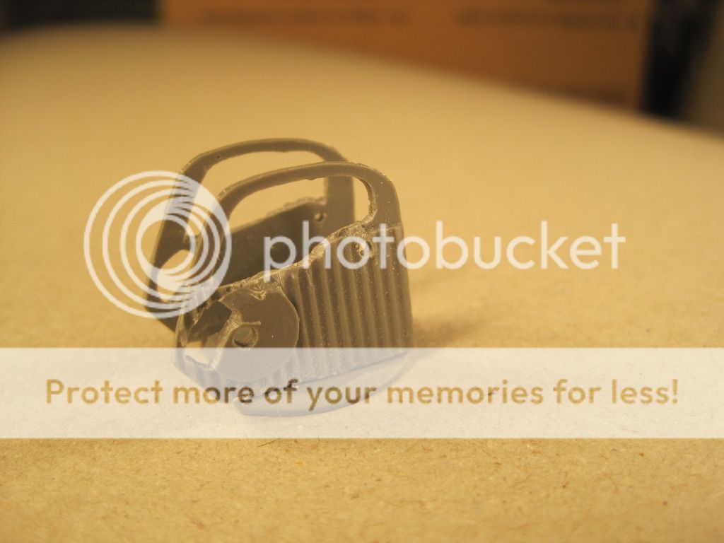

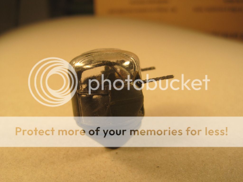

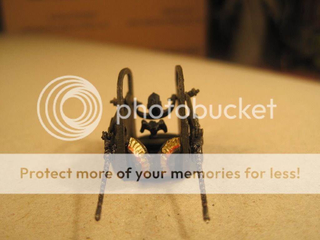

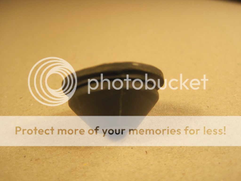

Update time. This first group shows the completed top turret.

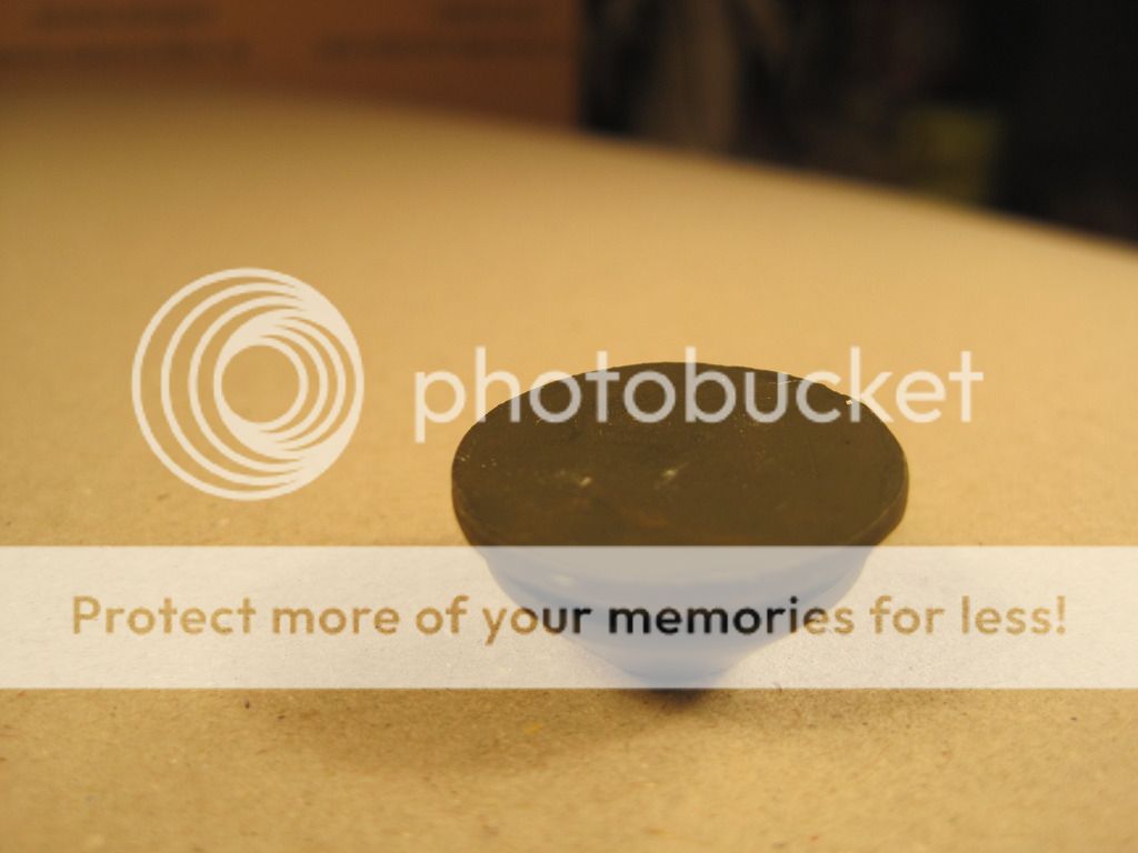

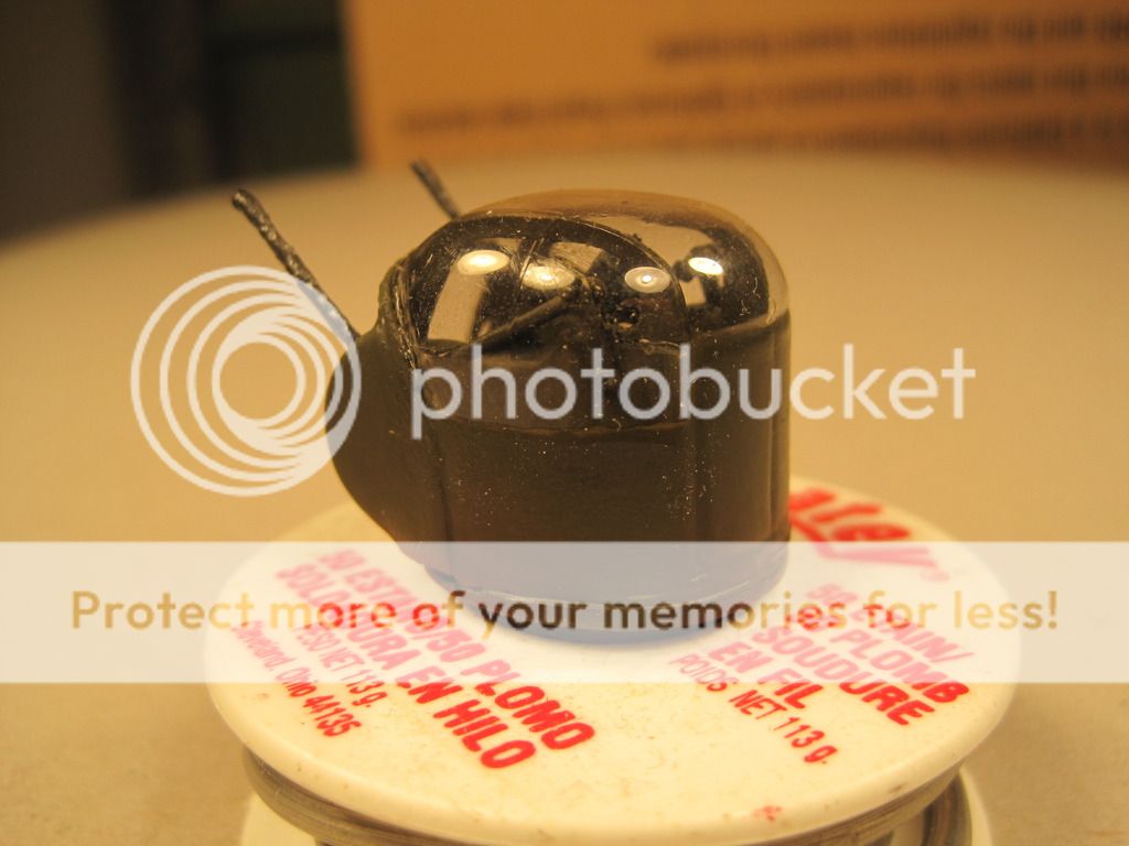

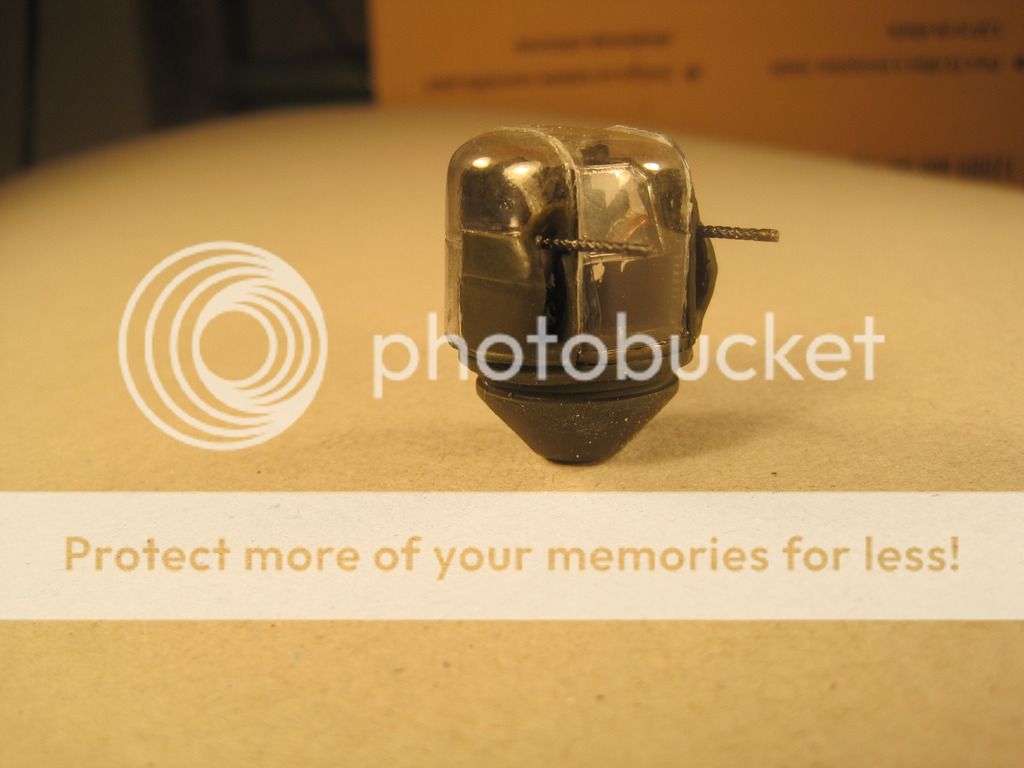

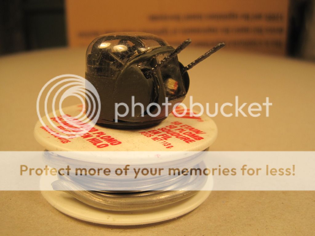

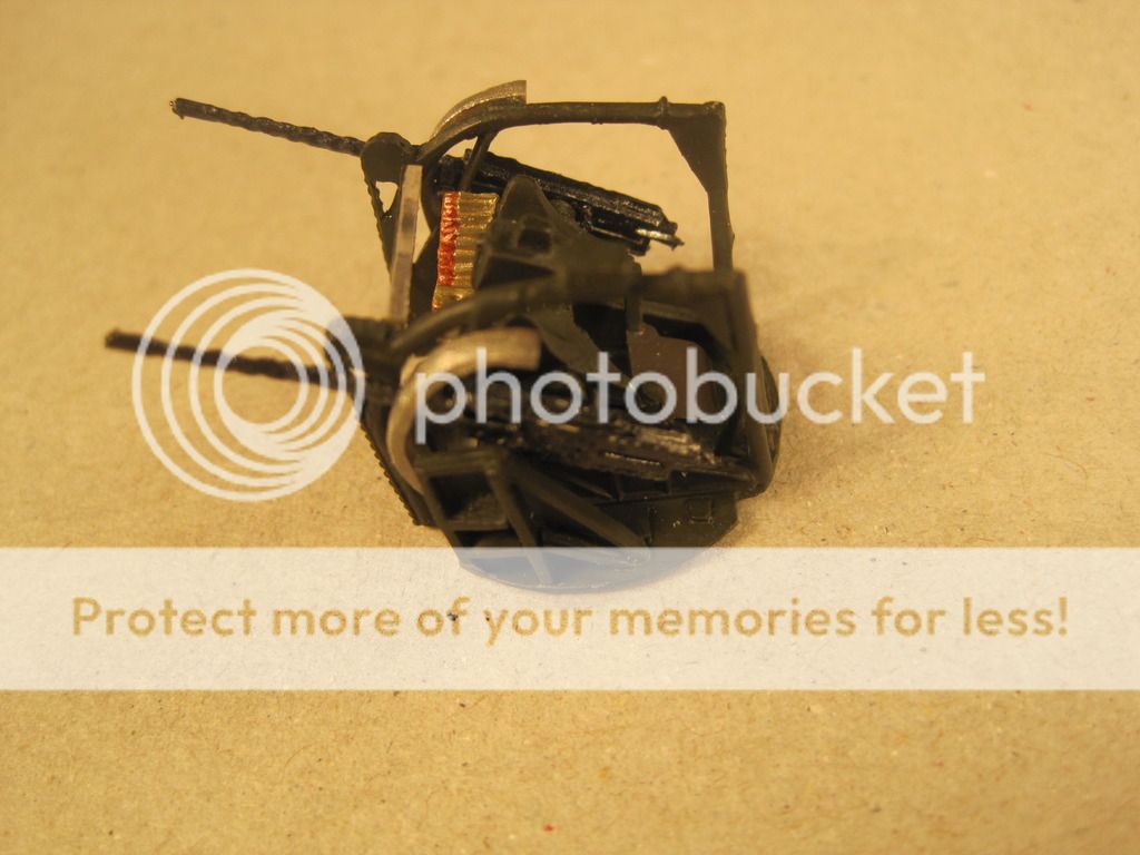

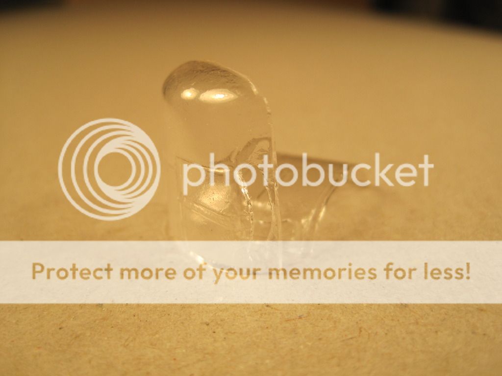

Next batch shows the work on the Nose Turret. In order to make the guns elevate and depress, the opening in the glass needs to be cut out and the guns and sight need to be glued to a single rod so they can pivot together.
In order to mount this turret, I cut off the bottom of the kit supplied turret, and knowing that weight will be needed in the nose, I inserted several nuts and washers. (I suspect they won't be enough, but it's a start.)
And here's the finished turret.

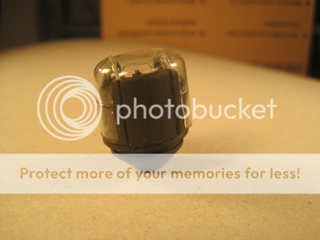

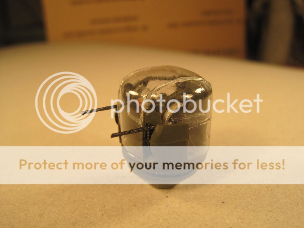

The tail turret really required some extra work. In order to have the guns elevate and depress, they had to be drilled out and glued to a rod so they would move together, and the metal rod in the kit was not long enough. Next I noticed that due to the side wall, there was no way the bullets could feed the guns. I don't know whether it's correct or not, but I cut out an opening so that the ammo feed would actually supply the guns. Next I noticed that the bell crank or drag link mechanism was fixed and clearly this was intended to coordinate the movement of both the guns and the site, so, I scratch built my own mechanism, put a bracket on top of the guns and then glued the site to it's own rod. Everything now moves together.
[/URL]
[/URL]
[/URL]
[/URL]
[/URL]
[/URL]
[/URL]
[/URL]
[/URL]
[/URL]
[/URL]
It's not visible in the photos, as I needed a "prop" to hold the turret in place, but as with the nose turret, I cut the bottom of the kit supplied turret off to make a mounting base which took a bit of finessing to make sure it rotated in the fuselage. (No weight added to the tail
