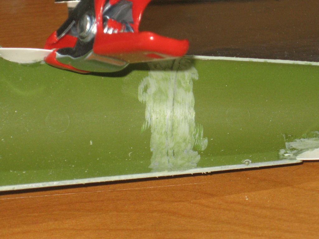

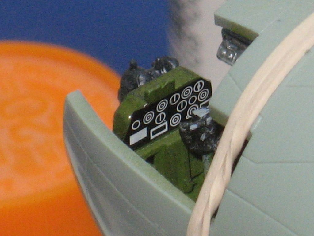

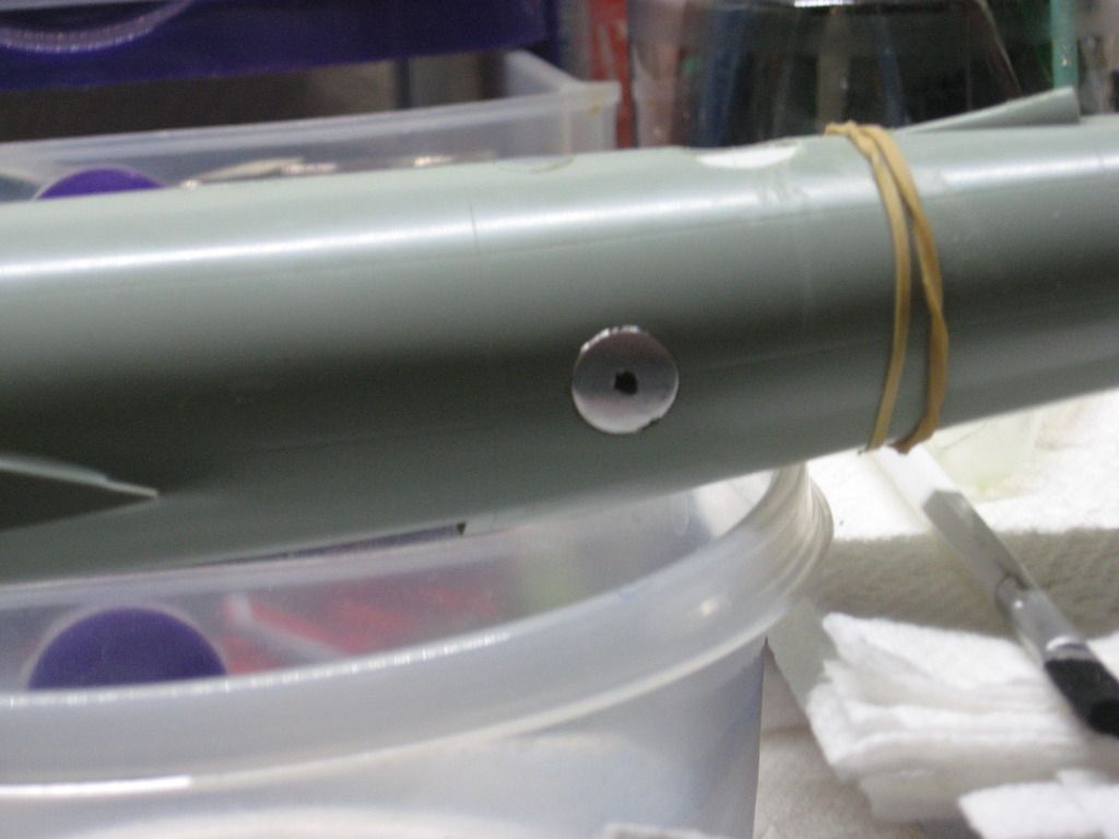

Had to leave one of the bulkheads out due to fit issues. I has about a .025 gap in the gunners area which bowed the fuselage out. The radio's didn't make it inside either. Oh well.
Pilot's side. Decals are over sized.
Co-pilot's side.
This was my third attempt at getting it together. Finally got it.

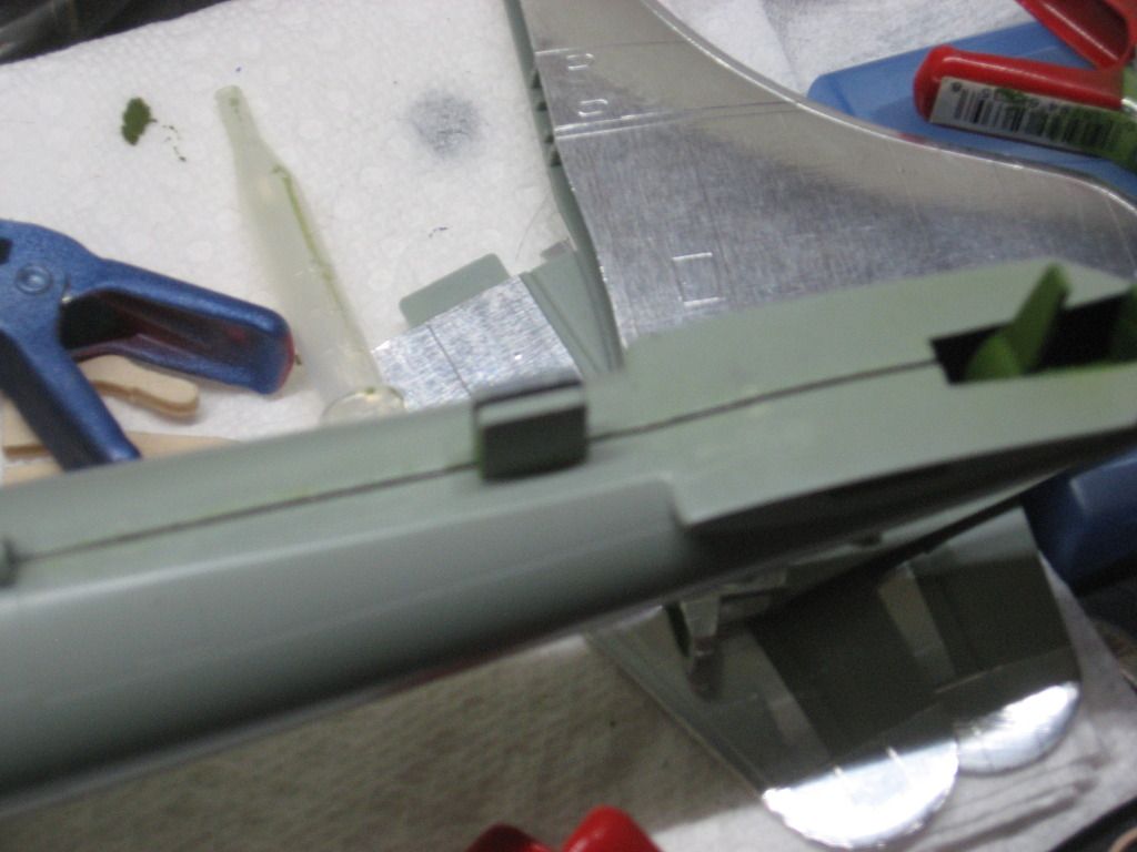

Note: When adding the turret blanks, use backing on the interior side before mating the two half's together. The blanks will come out if not supported.
As you can see in the photo's I've got many high and low spots running down the spine and underside of the fuselage.

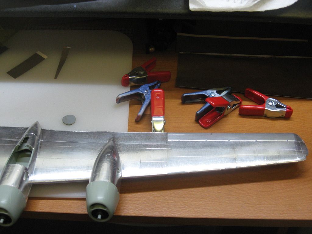

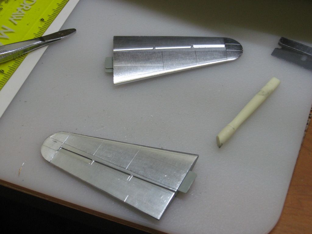

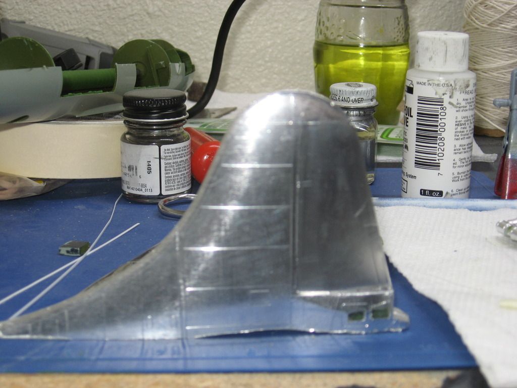

I've got a mixed update today, some good, some not so good.

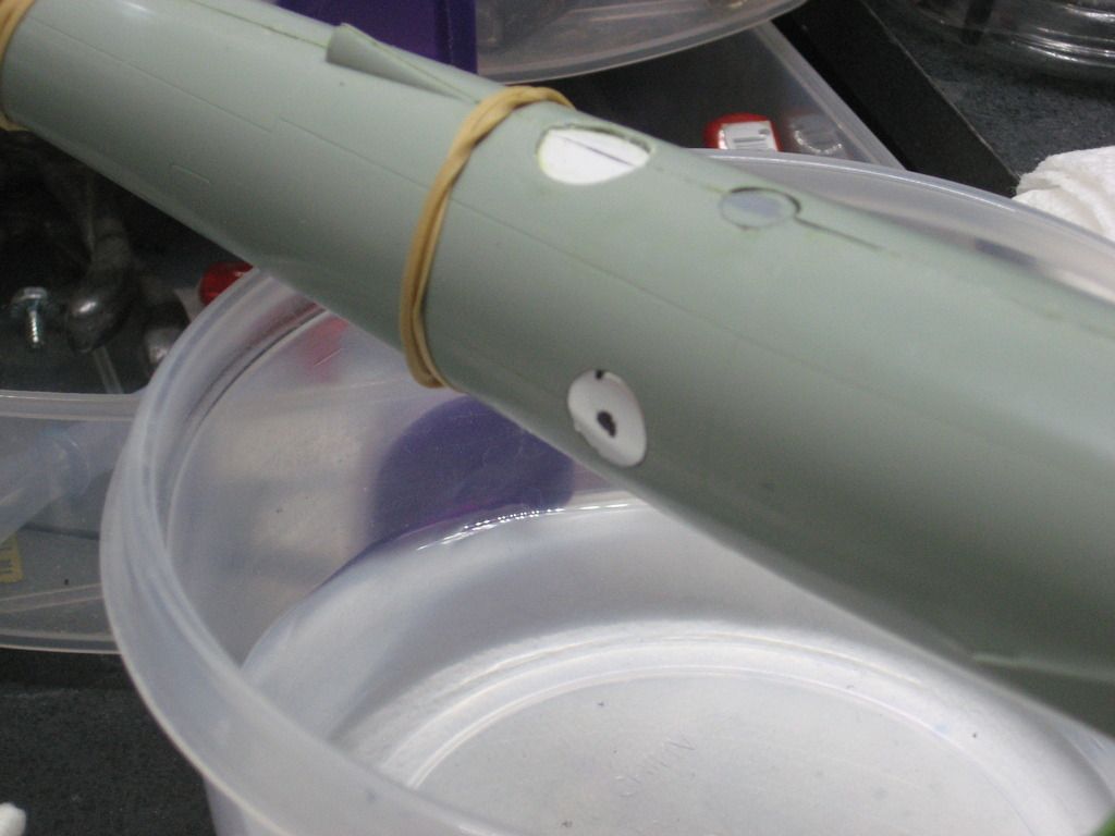

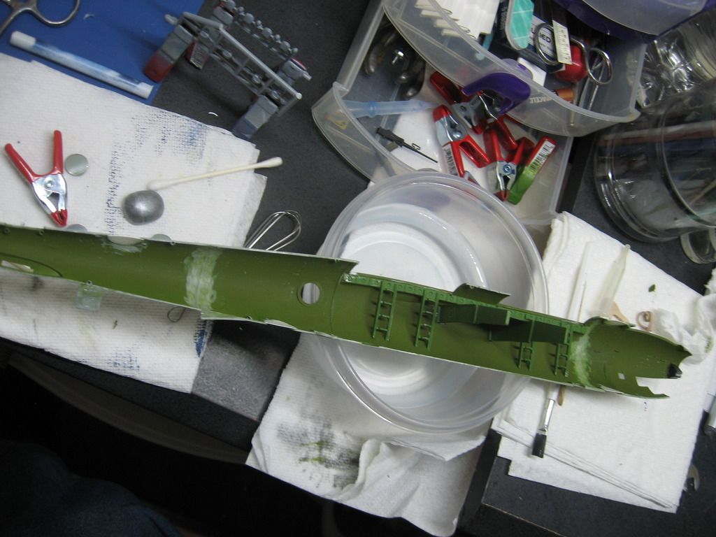

Let's start with the not so good......Once again I had to redo the fuselage after I removed the rubber bands.....it's getting a little old. This is what greeted me........

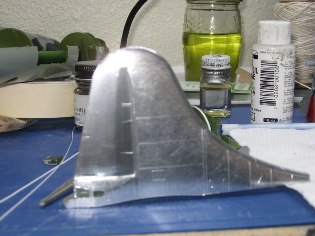

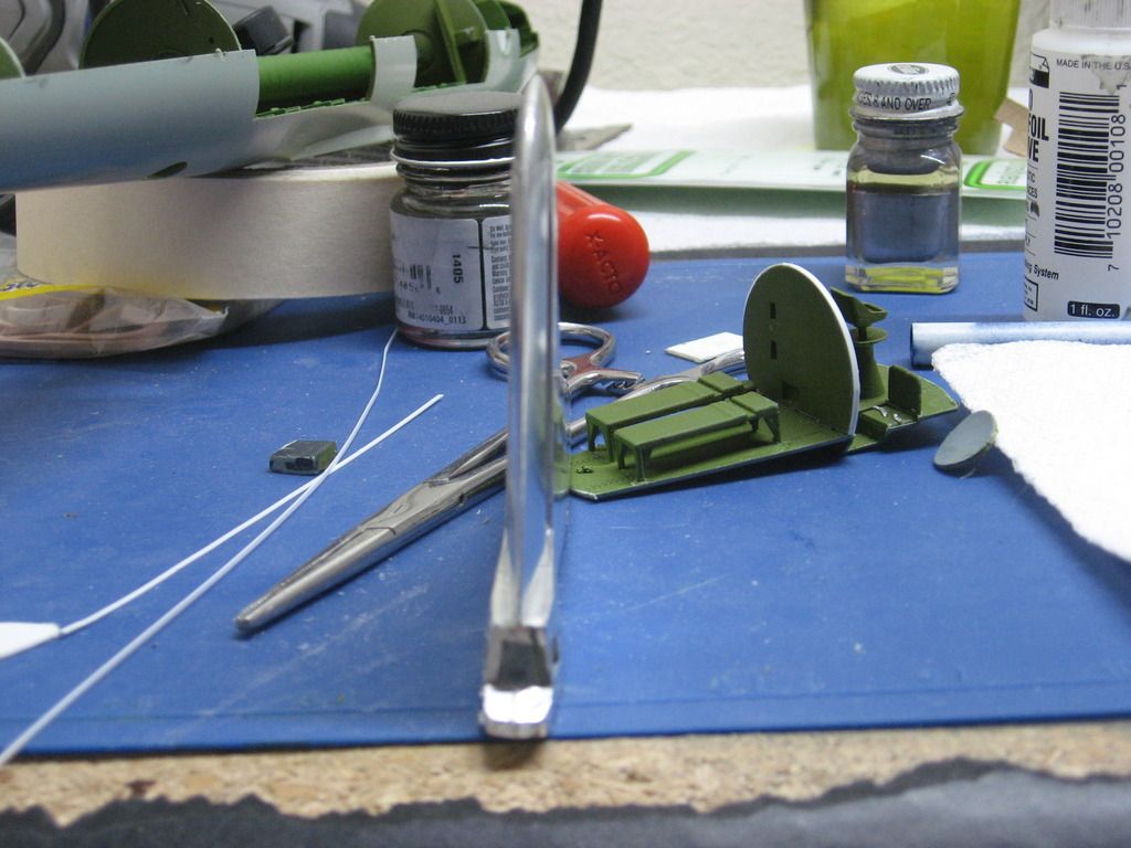

So, I switch to final foiling of the control surfaces. I used BMF on them.
I hope to have the tail, the other wing flap done and start on the larger wing areas.
I hope everyone has a safe and Happy New Year.
See ya in the funnies............

Posted: Tuesday, January 03, 2017 - 09:21 PM UTC
Hey gang,
I hope everyone had a safe and Happy New Year.
I should have some update photos later day. All control surfaces now have BMF on them. The fuselage still remains to be a bit concern with joining the half's together since any imperfection will stick out under the foil.
Now some of you are yelling at your screen about now say, "Just get on with it!" "Stop talking and build it already!" Well, I personally would love to get this build done, however, I want to get it right since this aircraft is an important part of our history.

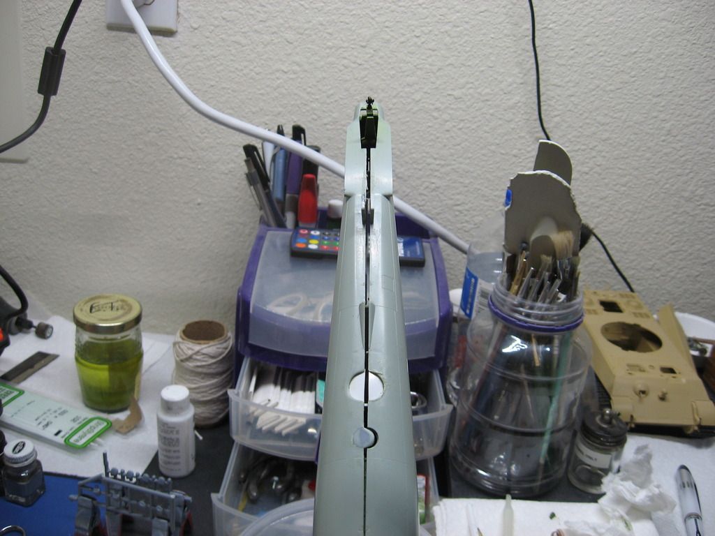

Hello Russ,

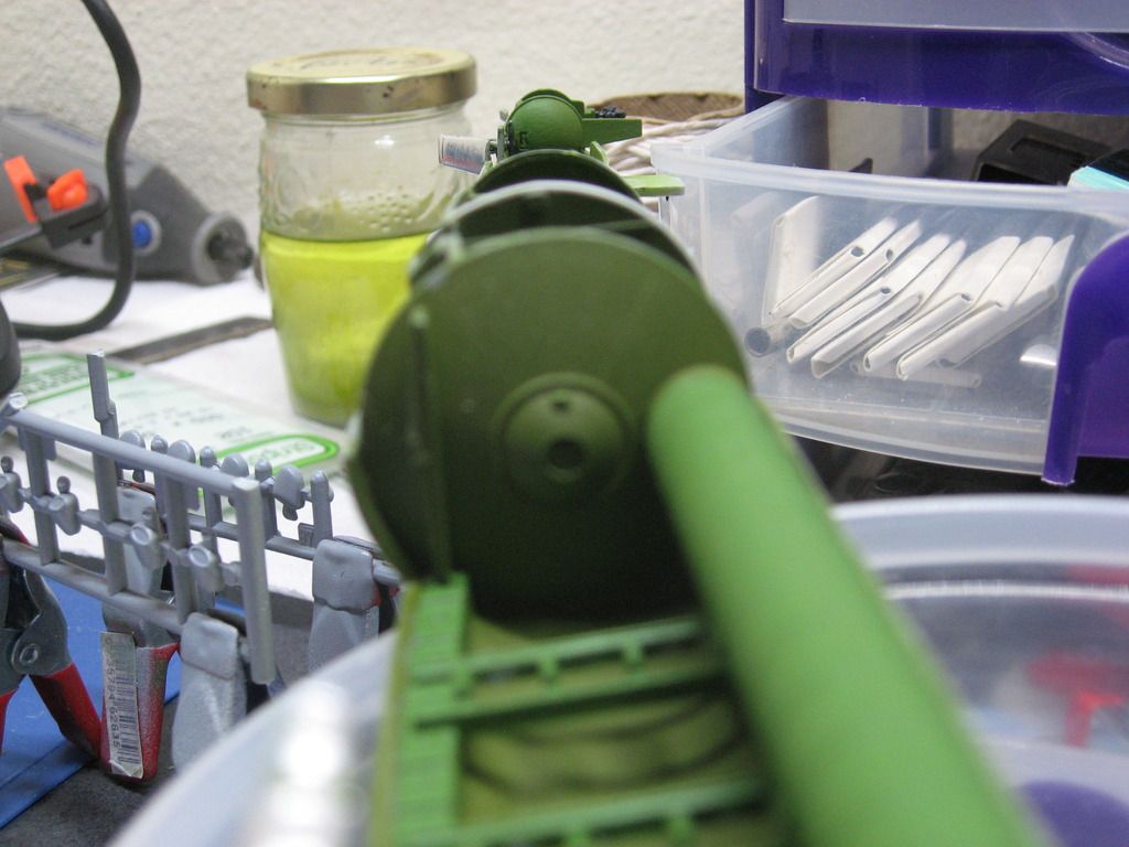

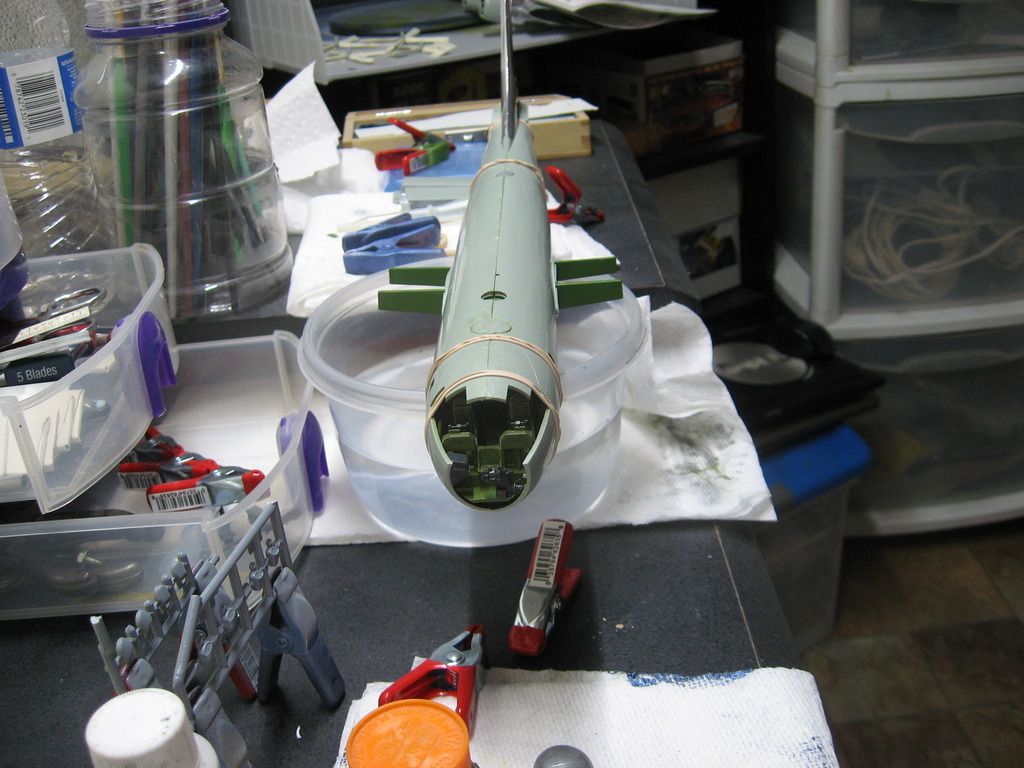

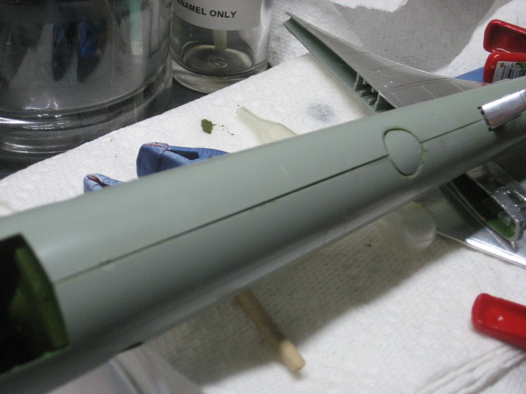

I'm not sure. All I know is that the issues are there. You may have gotten a kit that went together without any issues. I've had kits that go that way, others you have issues.

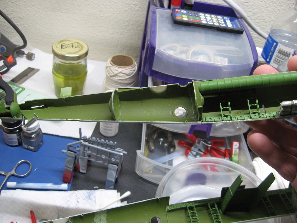

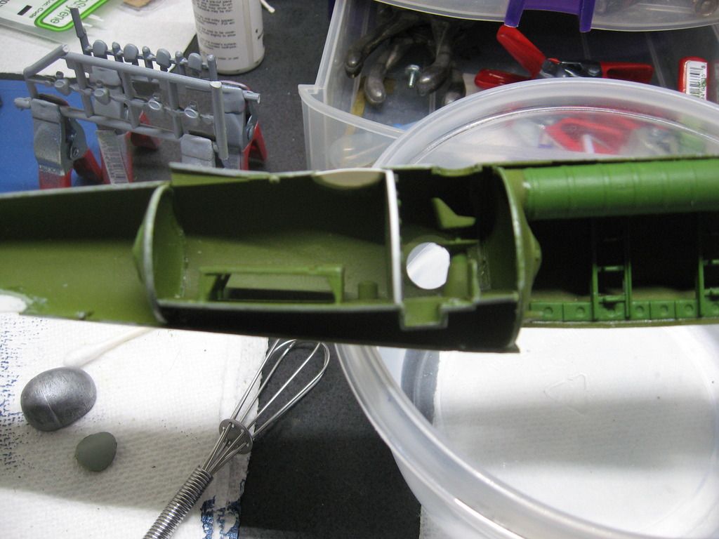

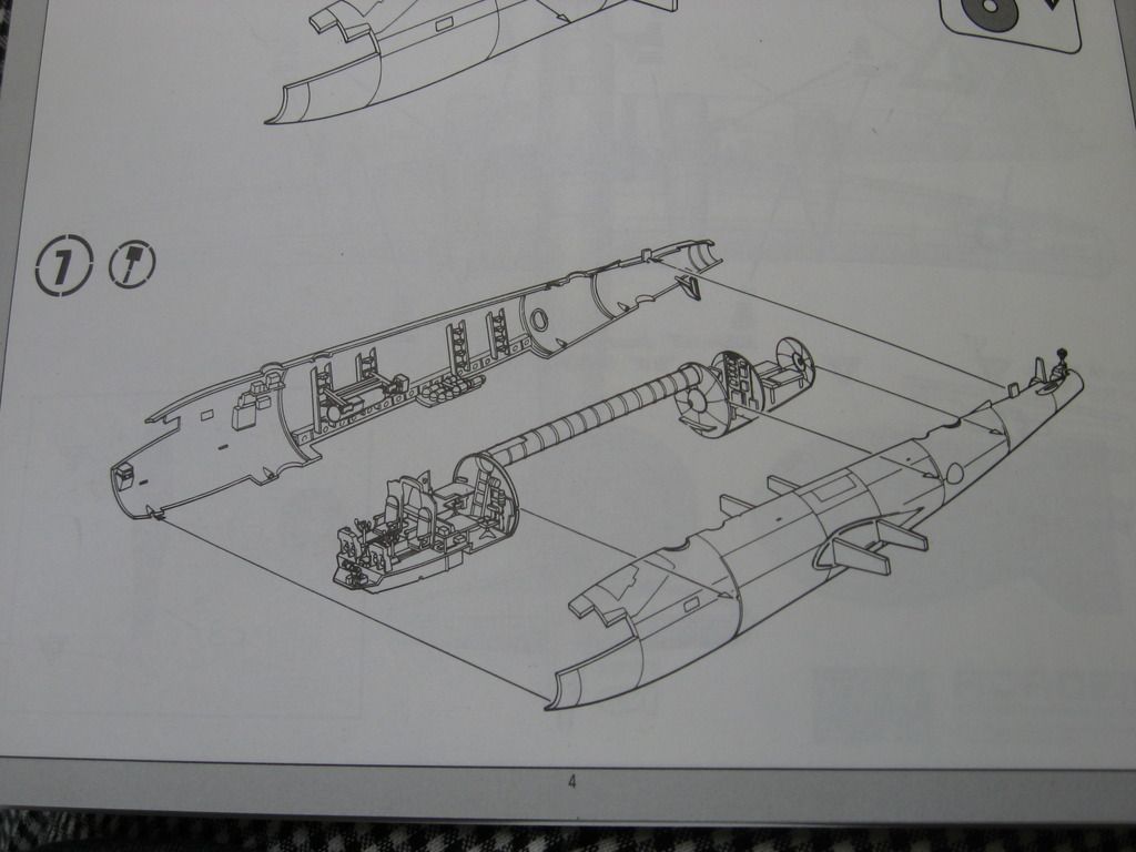

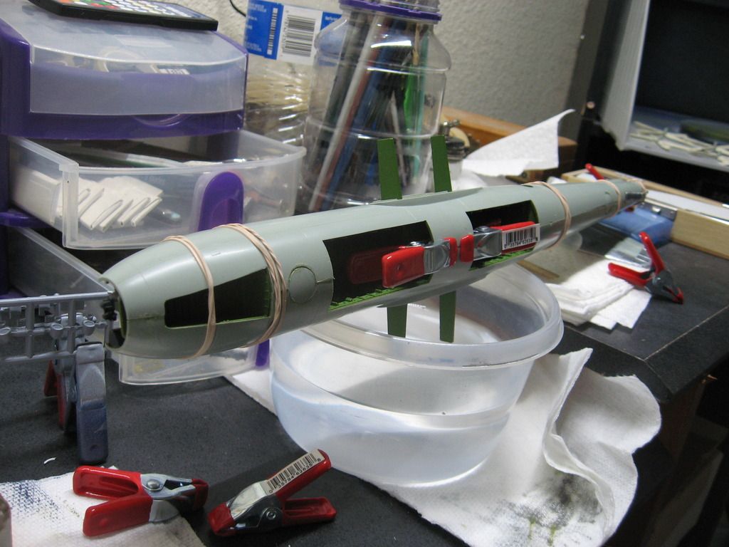

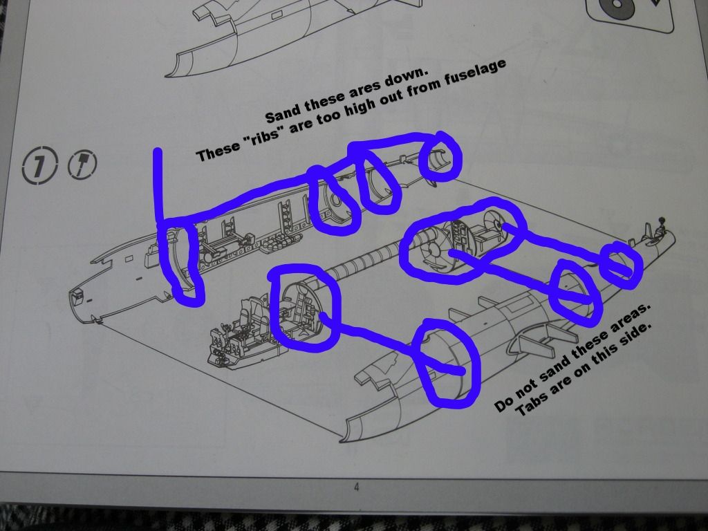

Anyways, here's whats been done. First, what the instructions tell you to do.
Is that what I did? Nope. I worked from the cockpit, back, to check to make sure if everything lined up. This is when I ran into the bomb rack and cockpit bulkhead issue. The bulkhead behind the cockpit leading to the tunnel didn't match the alignment pins on the fuselage sides. Also the bulkhead didn't match up with the floor of the cockpit alignment pins. The radius didn't match.

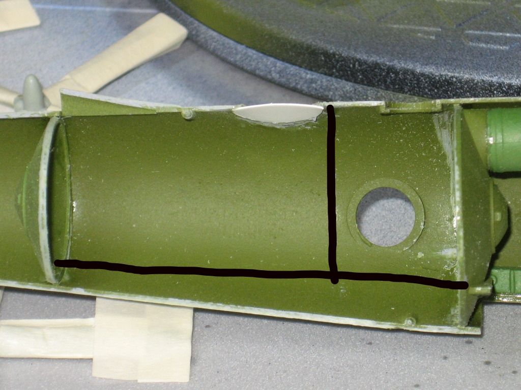

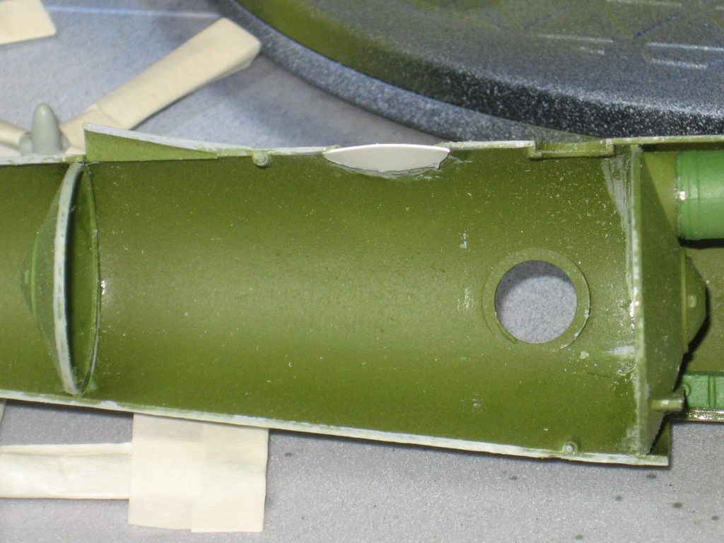

Here's the main area of the issues. The rear gunner's/crew compartment.
Note the faint line were the bulkhead needs to be......

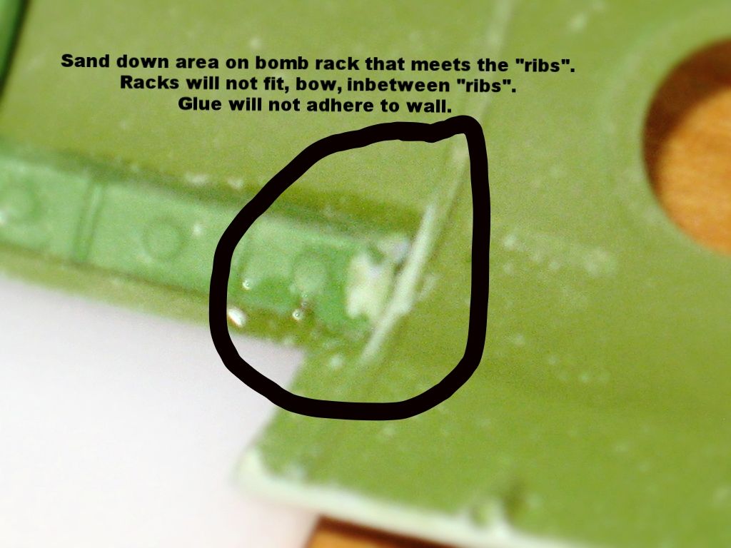

Here's some editted photo's with notes:
Here's what was done.

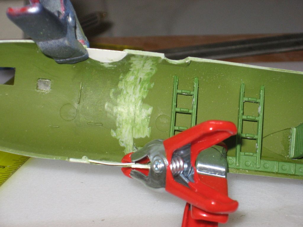

Here's an issue that just cropped up a few days ago. Note the thickness for the blanks for the turrets vs. the fuselage thickness.
Granted it's a dry fit, however in earlier photo's one can see the high spotting. Note the smaller blank has been sanded down to match the exterior and is flush.

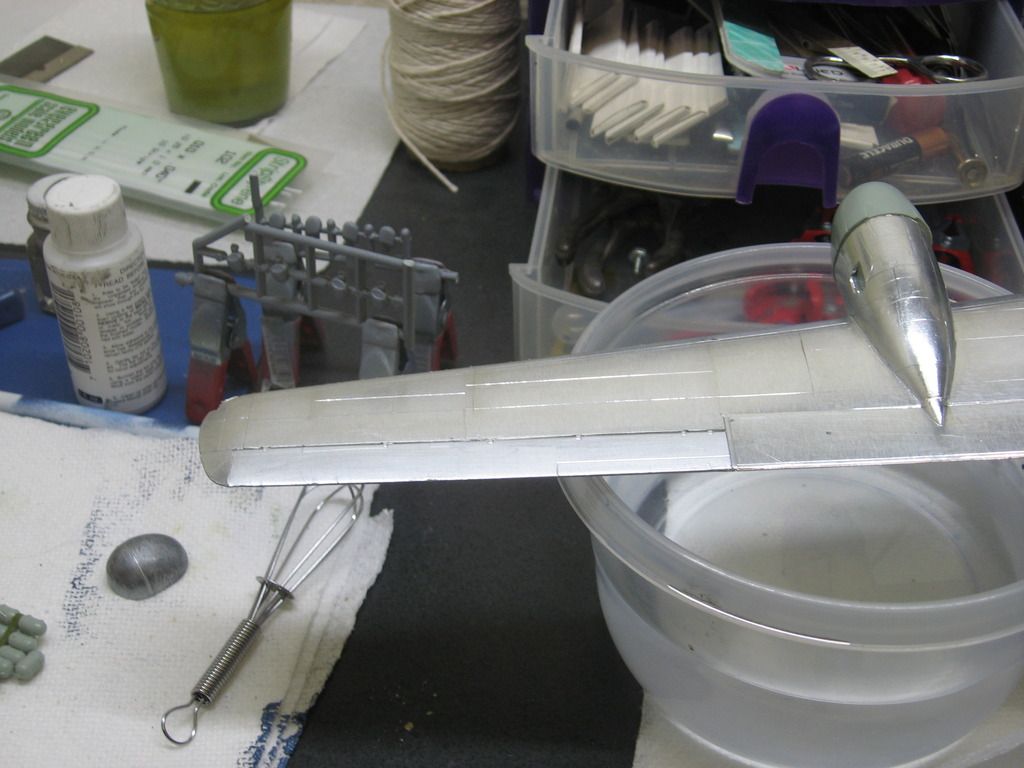

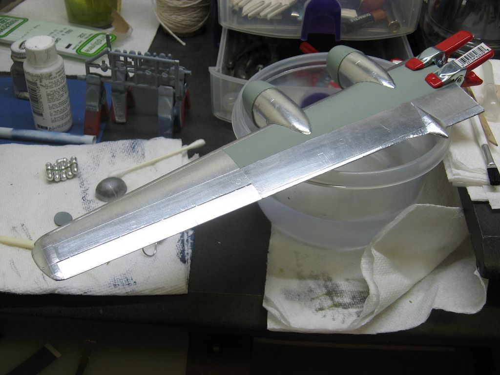

Now on to some more positive news. As I said yesterday the control surfaces were done. The gray areas on wings and cowlings are all that's left to foil. I foiled the O2 tanks.
I hope to have the issues with the fuselage figured out by the end of the day. Dry fitting looks to be promising so far.

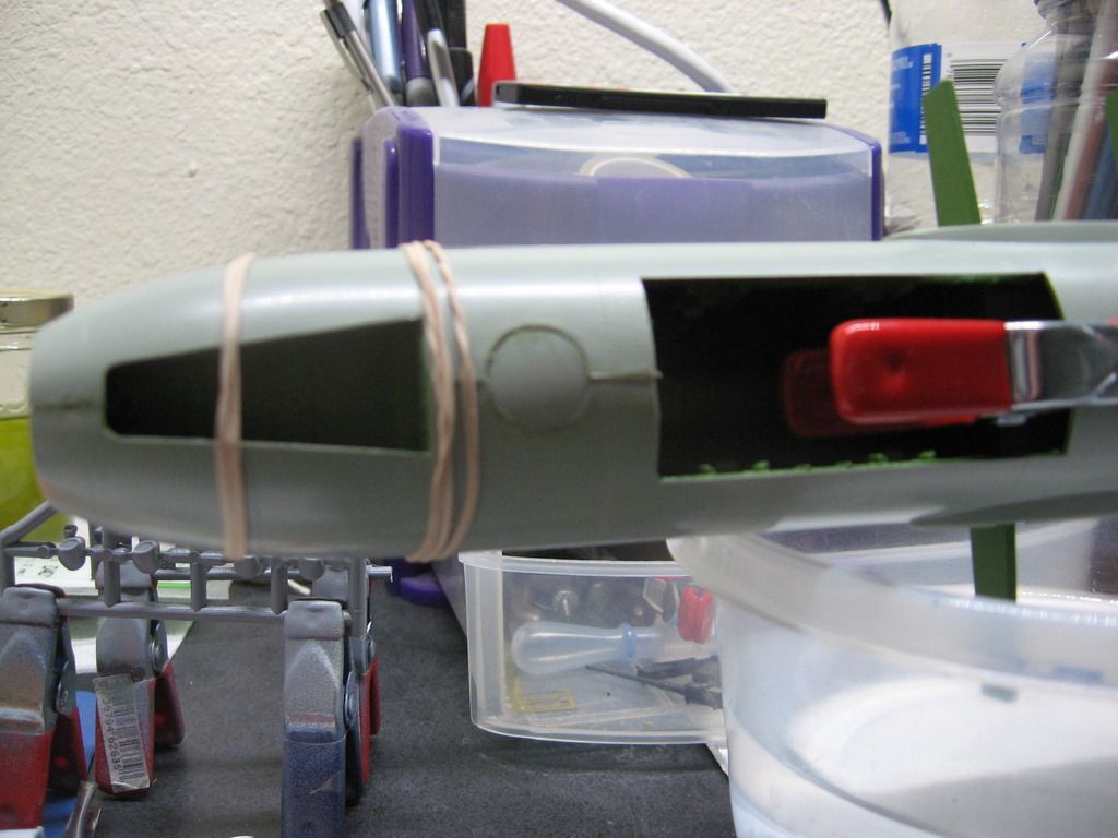

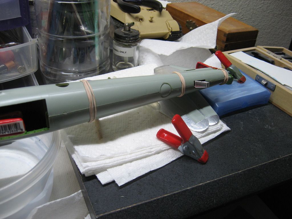

Posted: Thursday, January 05, 2017 - 09:57 PM UTC

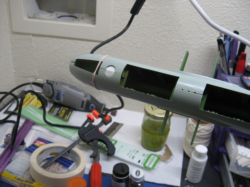

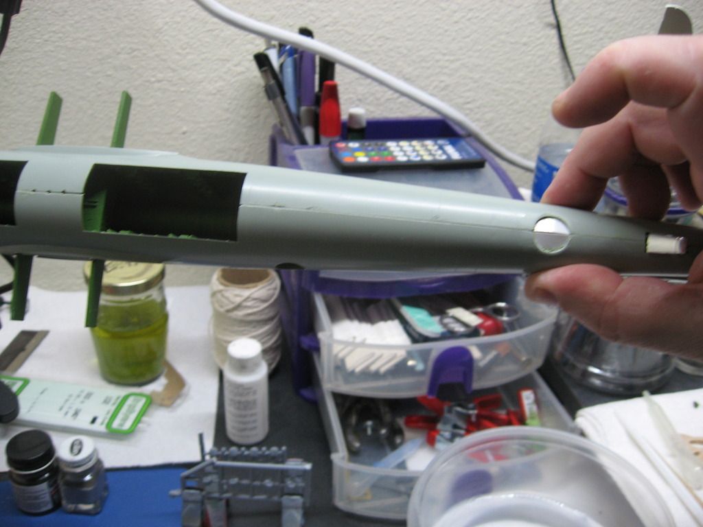

Hello Russ,

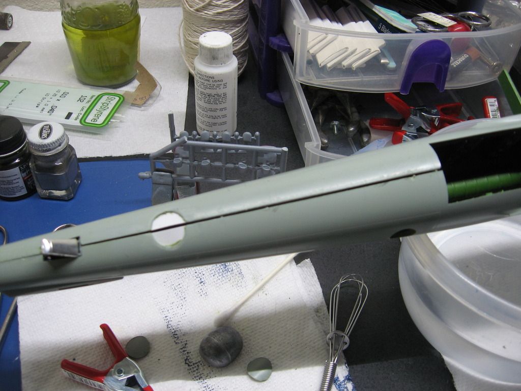

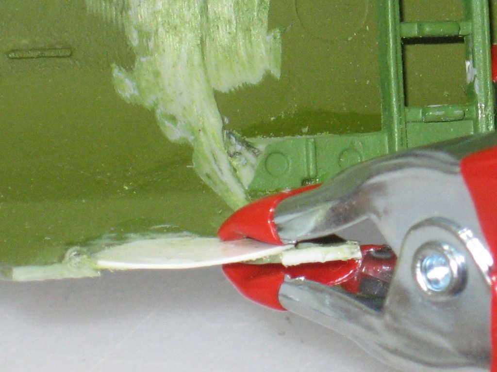

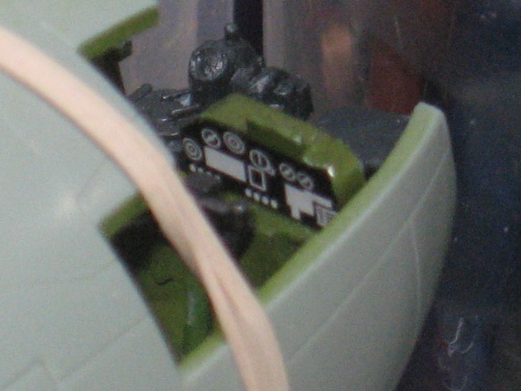

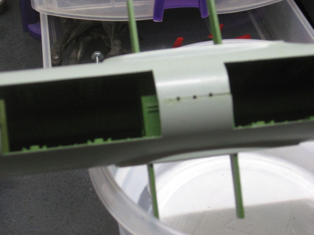

The bulkheads have the alignment pins on one side, none on the other. This makes it extremely hard to get everything in line if you follow the instructions. After yesterdays post I went back and took some more photo's of the gunner's/crew compartment area. Here's the first dry fit with the compartment in place....
Note the floor bowing........
Here's a inline view. Note there is a part of the floor that sticks out from the bulkhead in the foreground.
This shot is facing the nose.
Dry fit with the compartment in place........since the real aircraft is pressurized this would not work and the engineer would be fired.
Now the compartment has been removed....let's see what happens now after all that work of sanding off the "ribs". BTW, the first dry fit does have the "ribs" sanded down.
Look at that.....it fits now!
I can deal with the nose issue. The middle section will be hidden by the Radome.

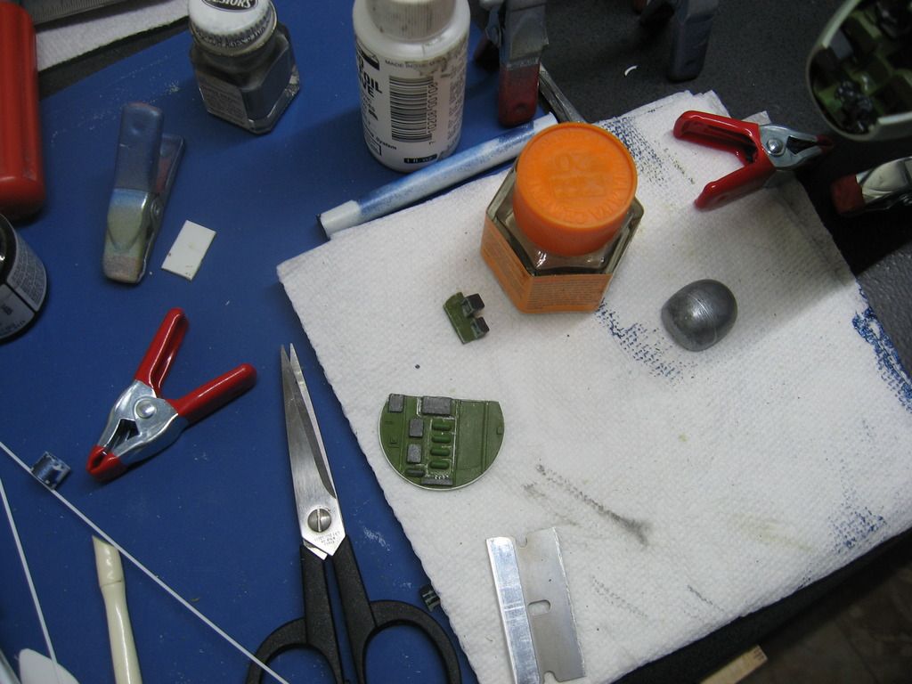

Now begins the massive amount of sanding. Not looking forward to this since some of the detail lines will be lost.
See ya in the funnies.............

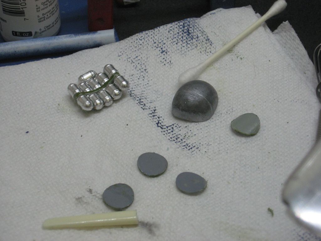

P.S. Thanks for the tip on the weights Russ. I've got some solder I can put in the nose to take care of that.

The solder is the thick type, 1/4 inch I think, I'll have to post that when I get there.

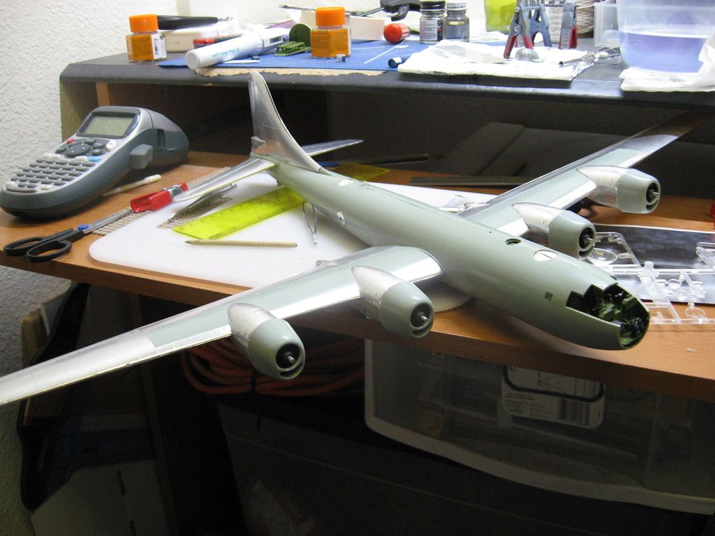

Hello everyone,

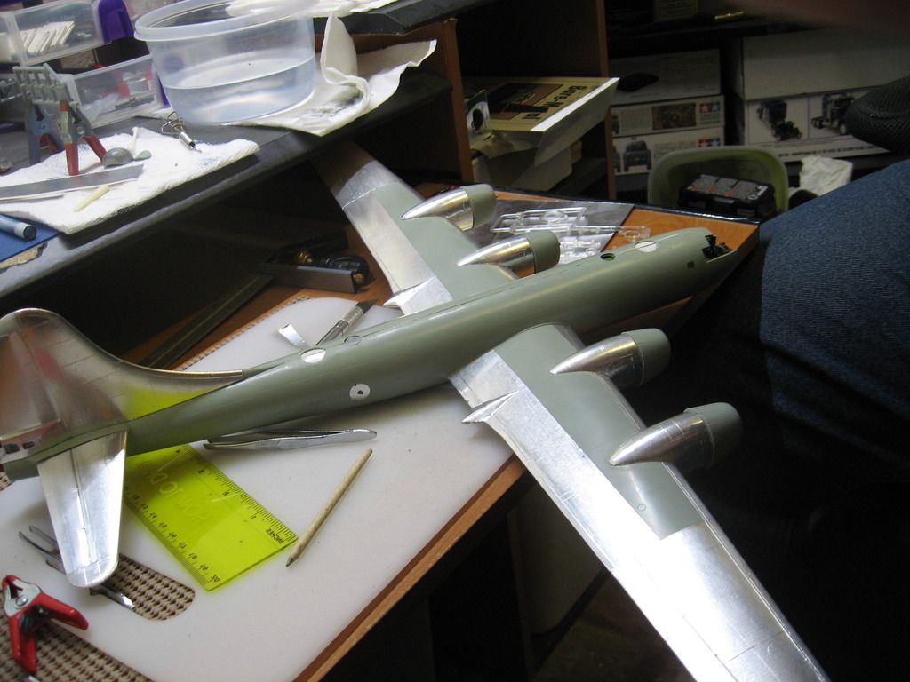

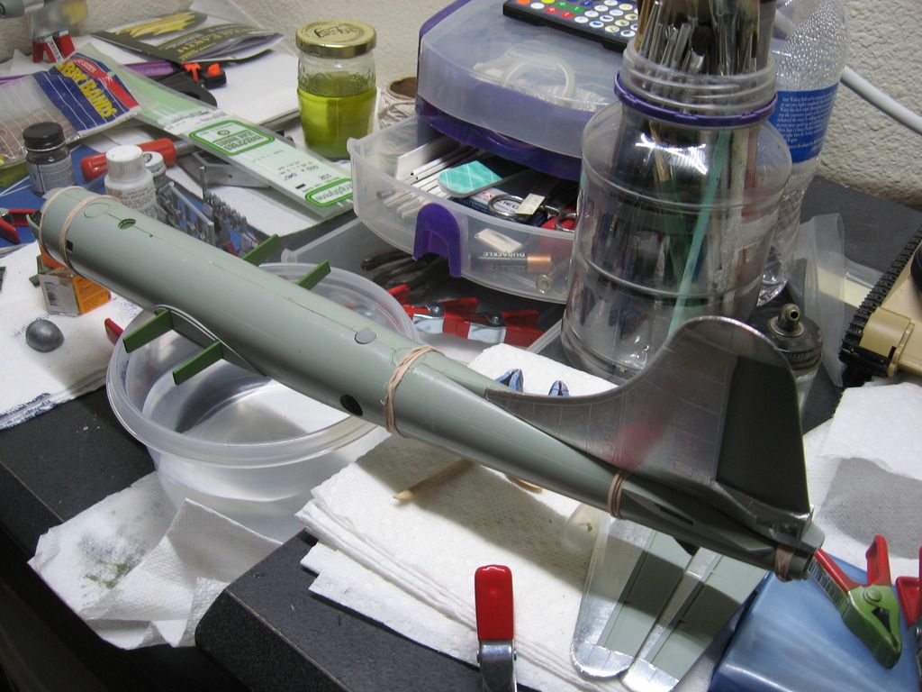

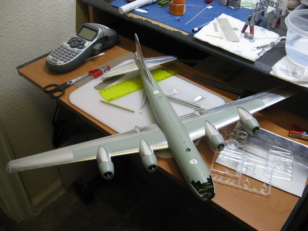

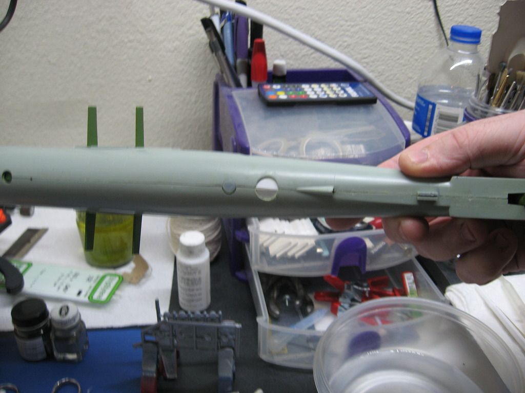

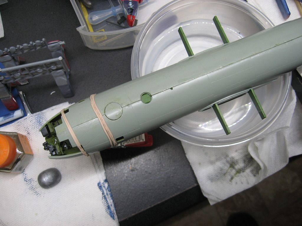

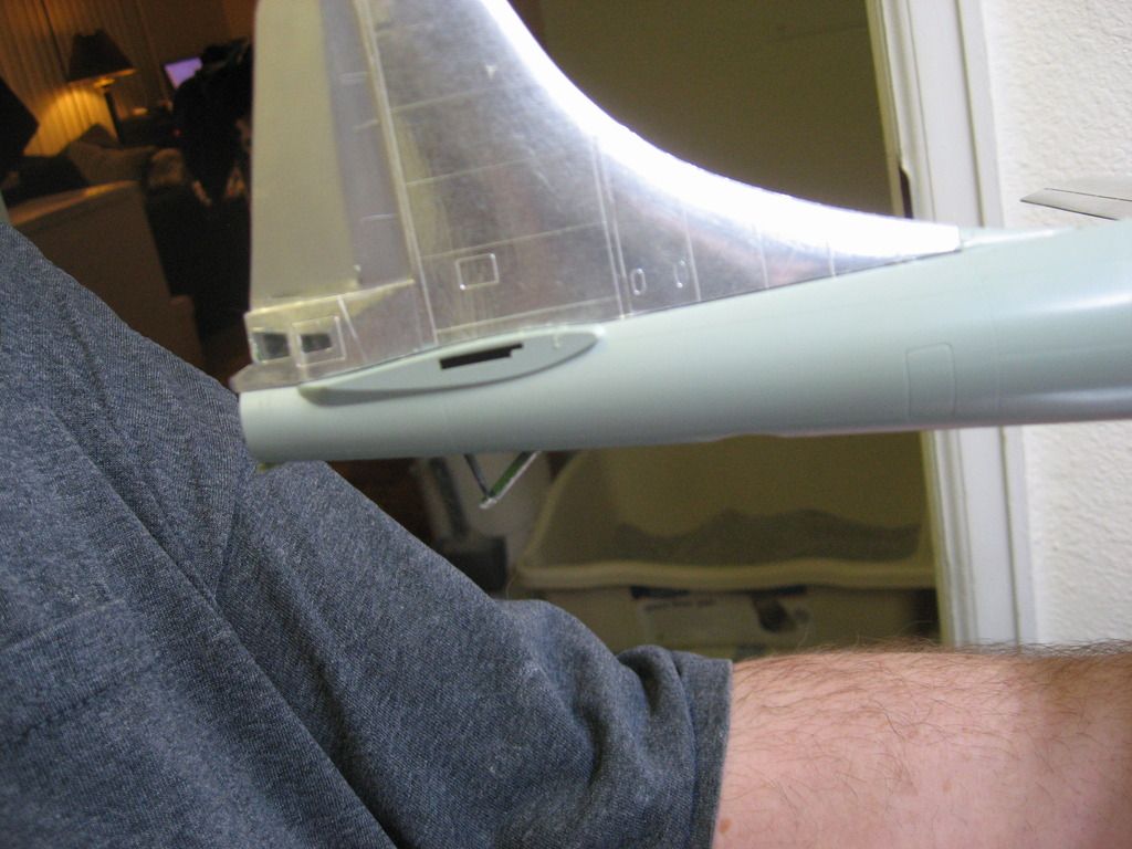

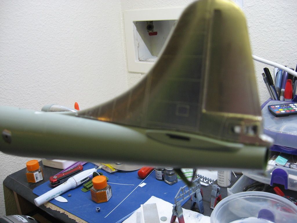

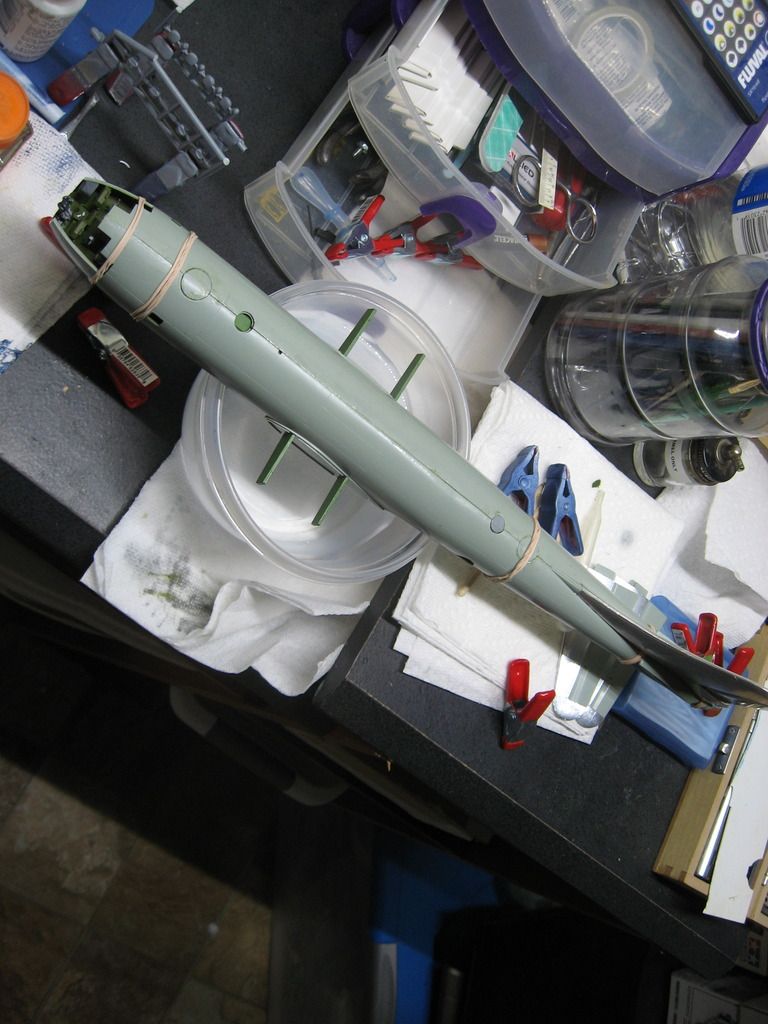

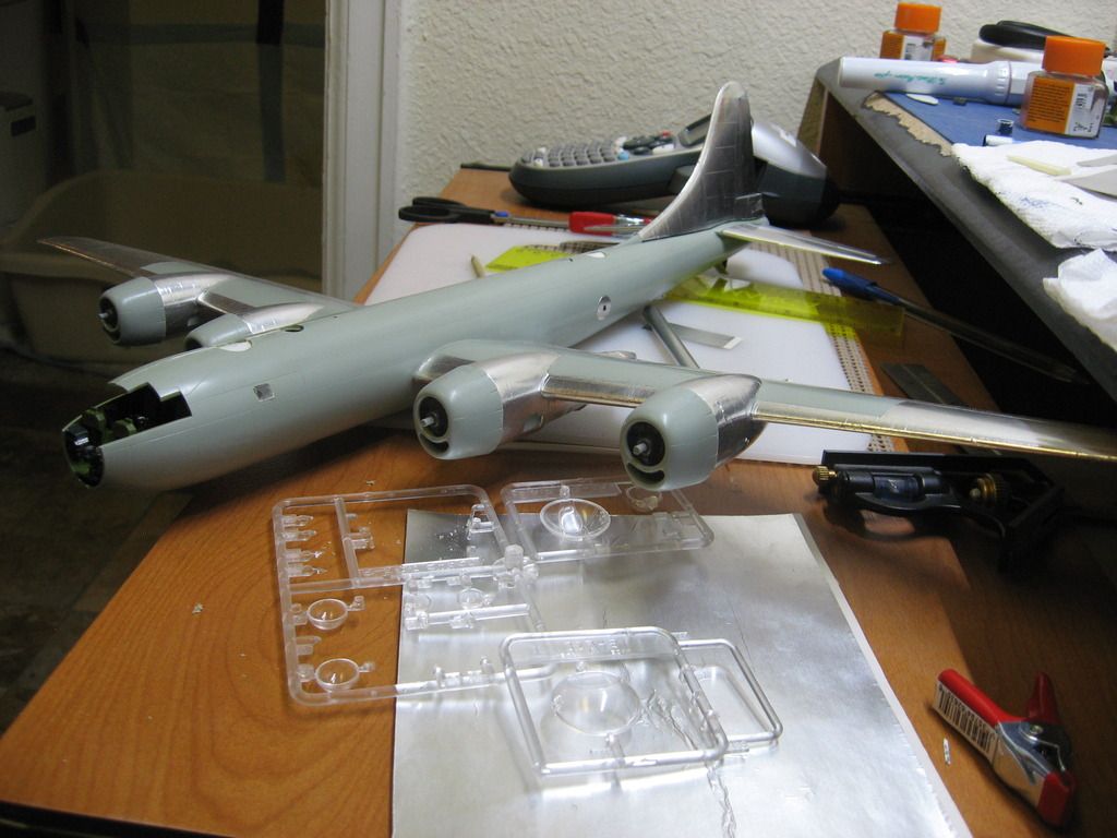

The rubber bands are off and the fuselage looks better then it was. Still have a lot of sanding, filling, rinse, repeat to do before starting the foiling.
Here's the dry fit of the wings and such.....
Note the gap. A little alignment issues with the gap for the tail section. I had to sand down the tap to get the tail to go over the tap. Very tight fit.
She's getting there..........

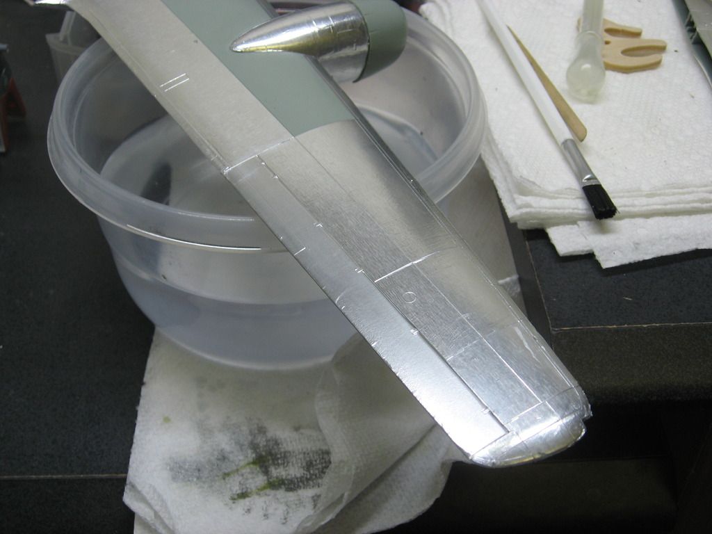

My apologize for not replying sooner to your comments. If you haven't been following the weather, we had a major wind event yesterday that knocked power out about 4 different times throughout the course of the day. 101 mph recorded gust from NORAD, which is about roughly 5 miles from were I live. Roofs/windows got blown out, trees down, 13+ big rigs were blown over. It's a mess..........Anyways.......I hope to get back on track with the build today.
Thanks Russ for the advise.
Thanks Bernd. I've been learning a lot on this build. It's is my first attempt at foiling. I must admit there are days when I think I've set the bar a little higher then what my skill level really is.....then again.
