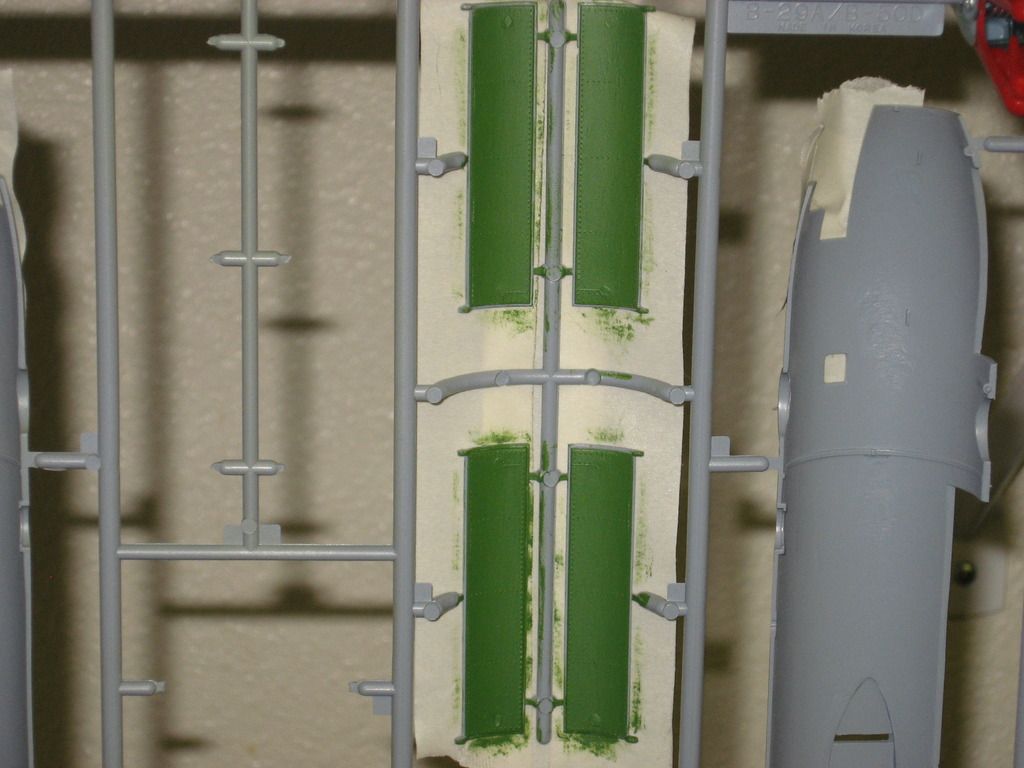

Brian,
That's some setup you came up with to prime everything at one time. I'm assuming you used a rattle can for max coverage.

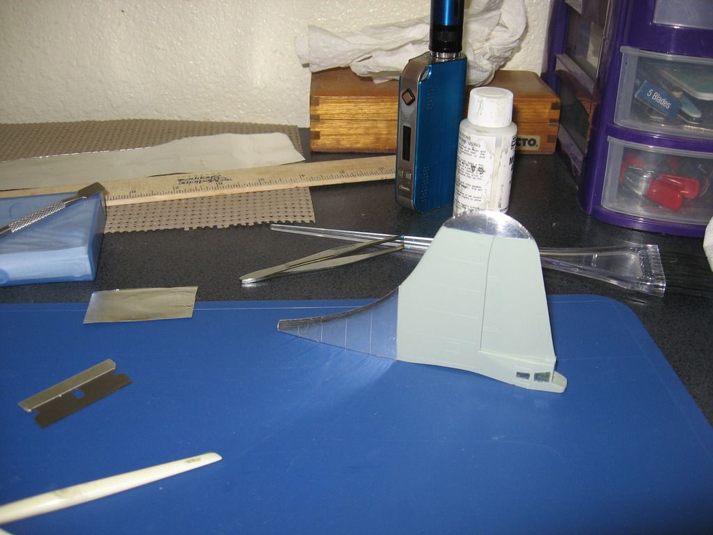

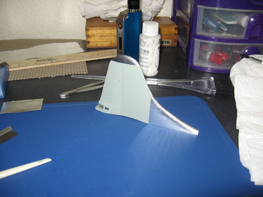

Hey gang,
Thanks for the replies everyone, I'll try to address them after this update.

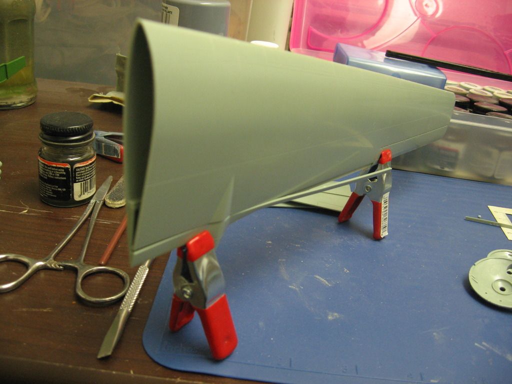

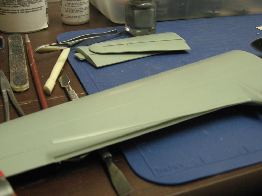

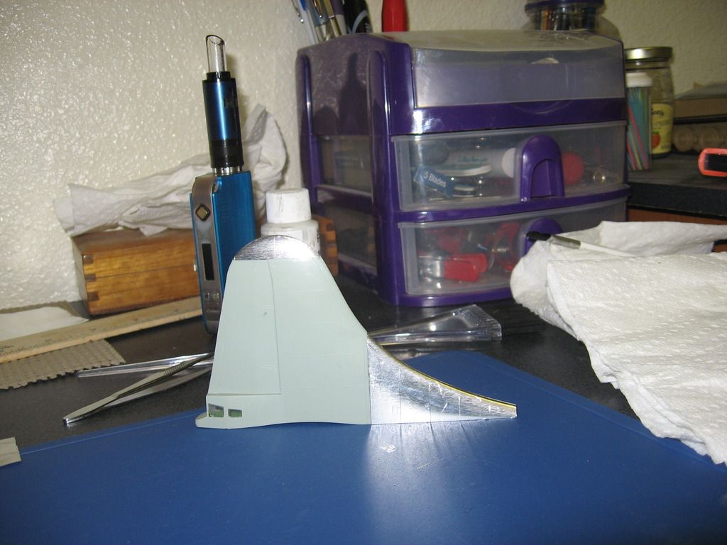

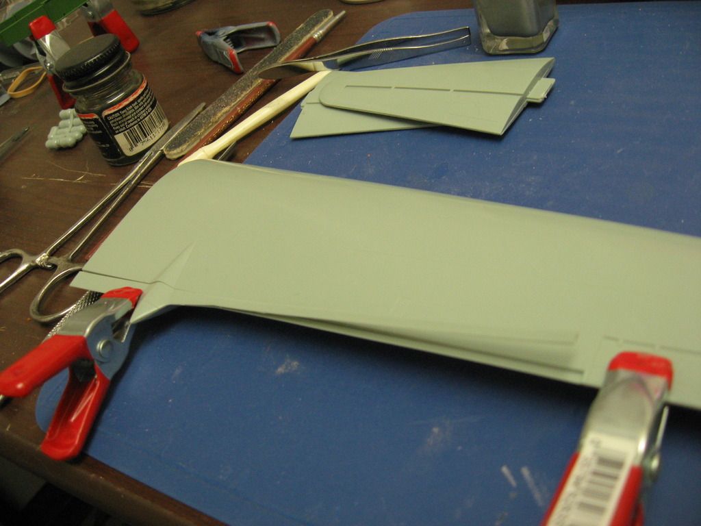

Houston, we have a problem.

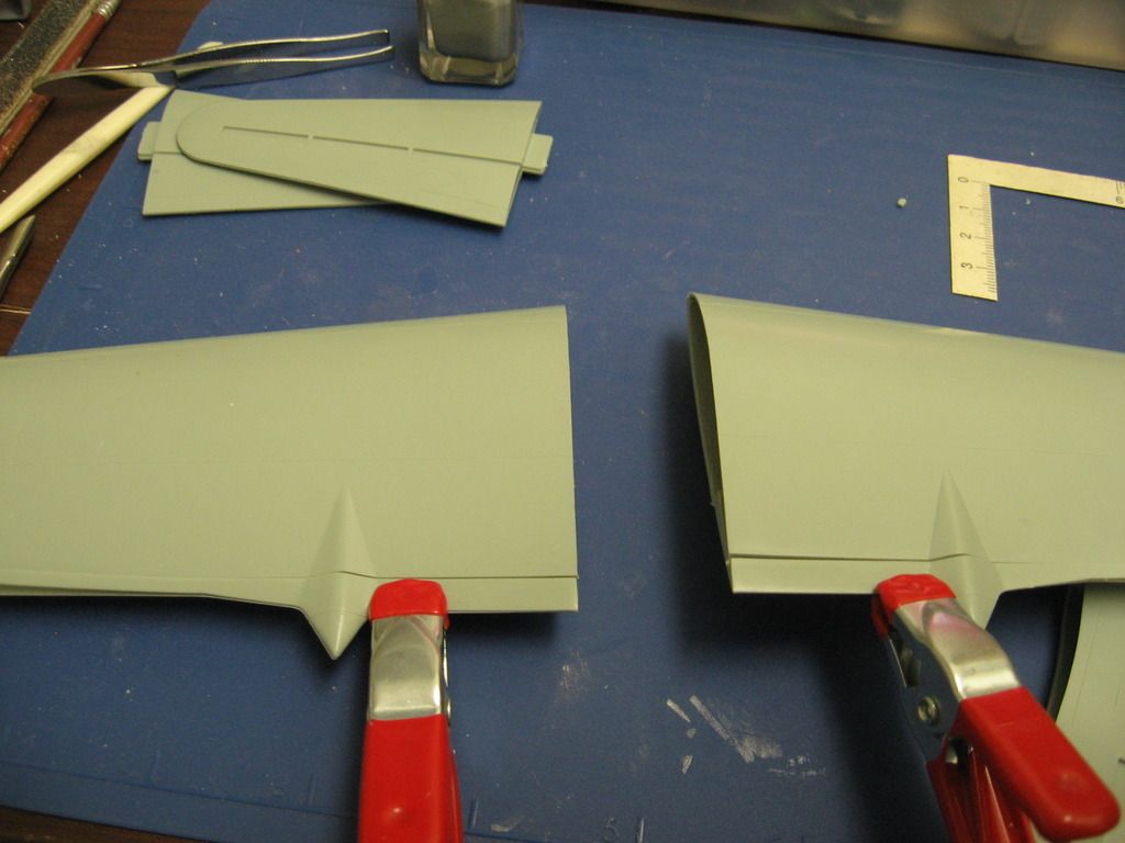

Parts E-101/E-102, are warped. This is a dry fit. Also the ailment tabs are not doing there job. This could make foiling this area somewhat challenging.

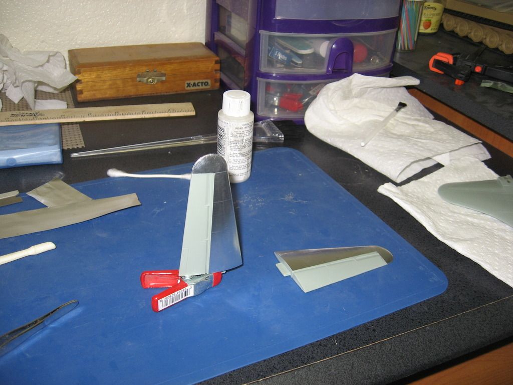

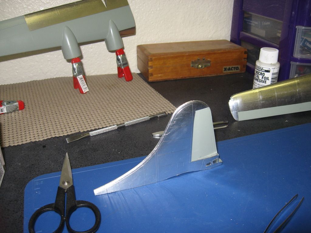

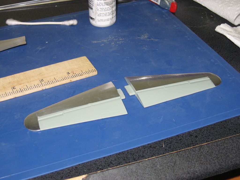

Tail and horizontal stabilizers are done. No issues so for with them to report. I'll be dry fitting the engine nacelles to the wings after I address the warped parts.
See ya in the funnies.................

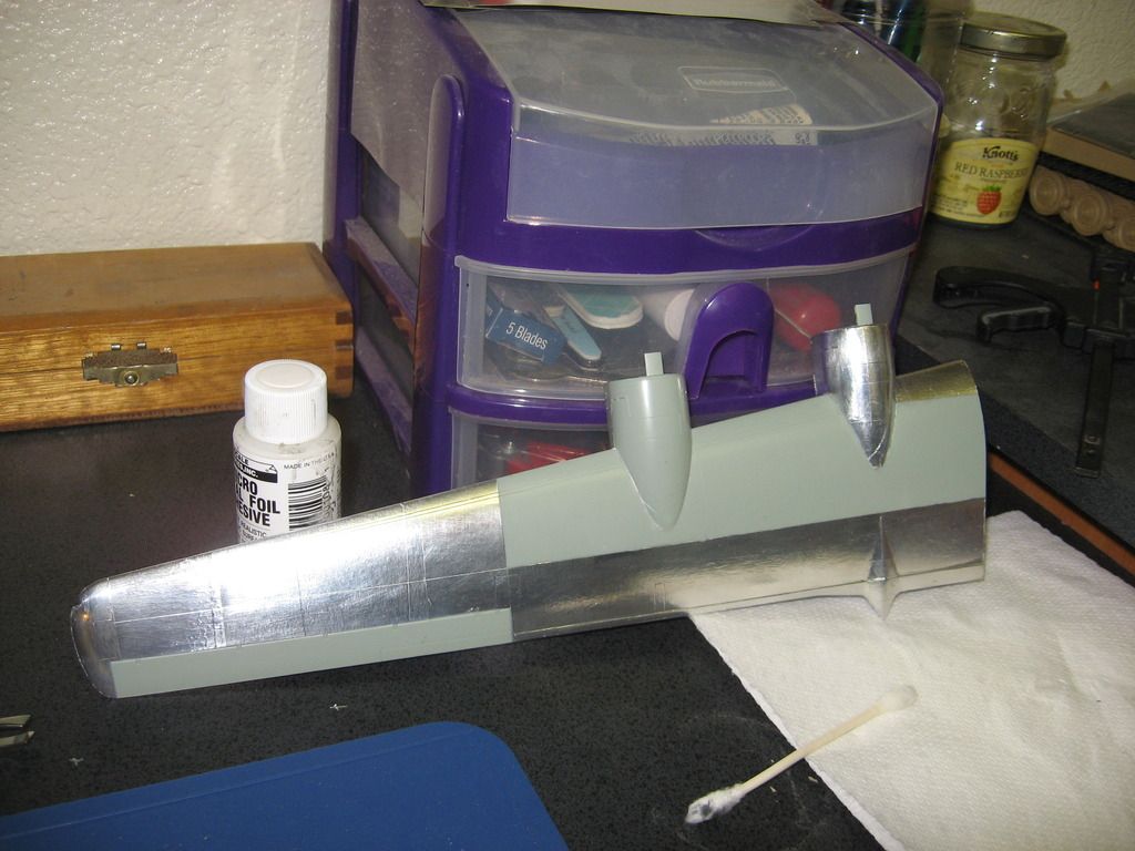

Hello gang,
It's update time.
The last time I updated, I was dealing with some warped parts issues, well I'm happy to report those parts are installed.
My wife has been on vacation from work this last week, so that's the reason for lack of updates until today.
Anyways, here's where I'm at so far.....

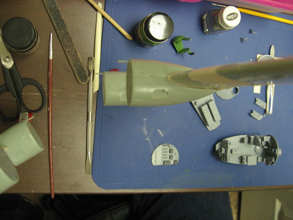

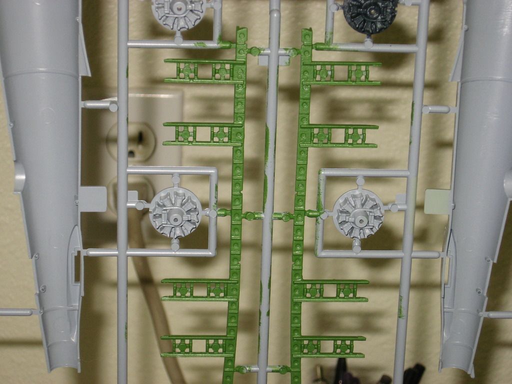

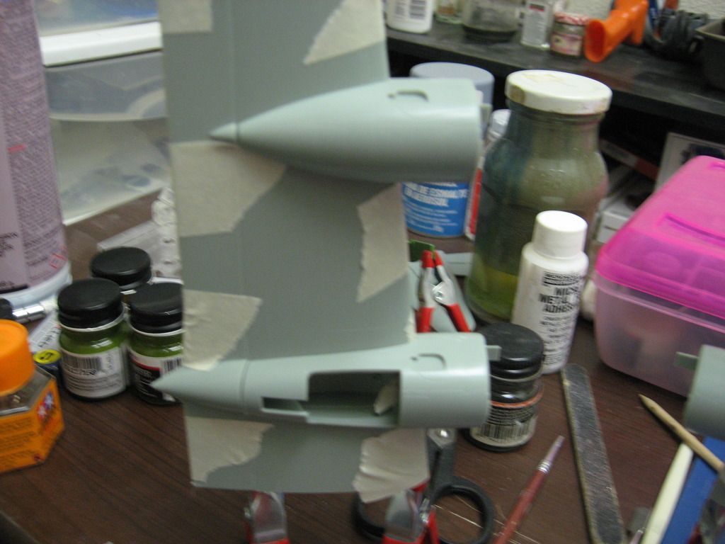

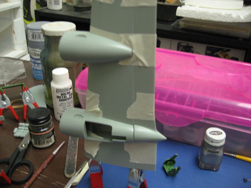

Engine nacelles done, dry fitted. We have some gap issues with them connecting to the wing.

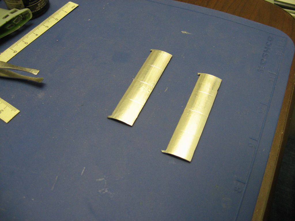

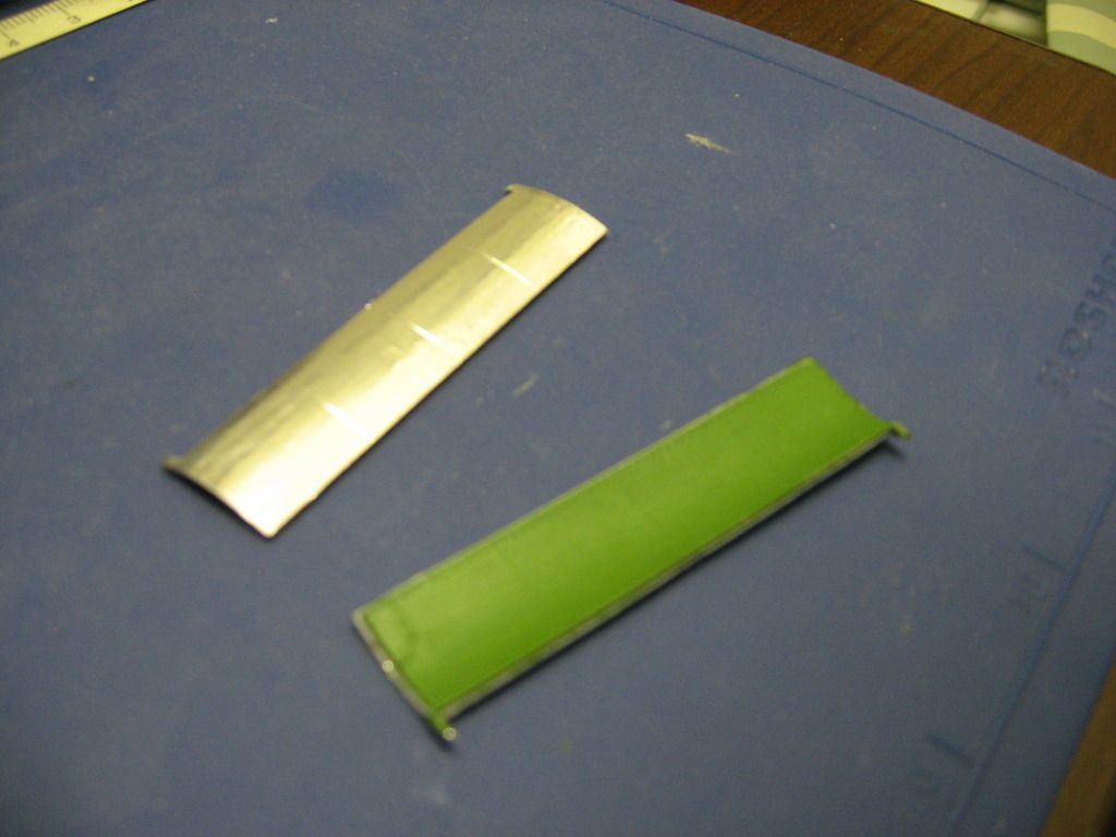

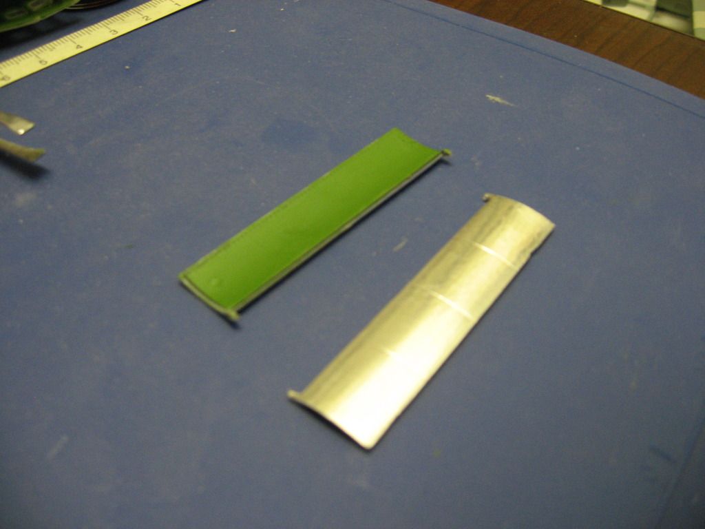

Interior paint going slowly, tunnel, rear gunners area, bomb racks, bomb bay doors, anti-tail strike gear, and all landing gear doors done.
Foiled 2 of the 4 bomb bay doors. Plan to foil landing gear door, and anti-tail strike gear next.
Here's the photo's:

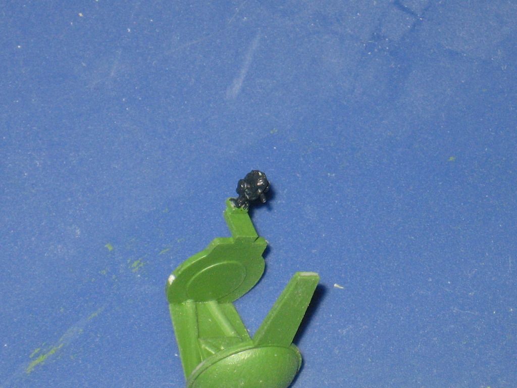

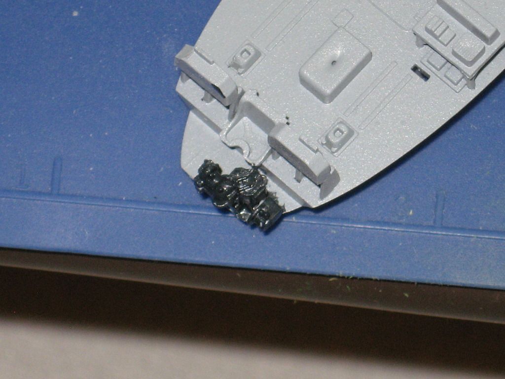

In the process of painting the interior, bomb racks, I was a bit of a noob. 90% of the Green zinc jumped out onto the floor. So I had to do a LHS run yesterday to get some more.

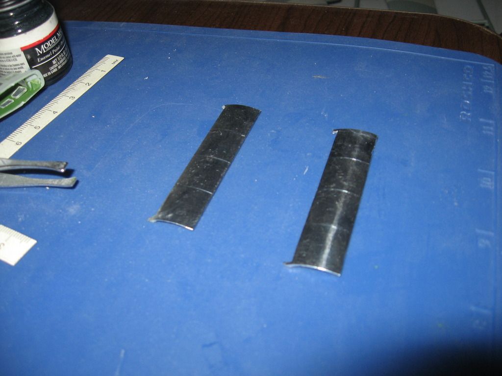

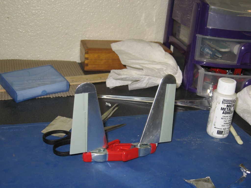

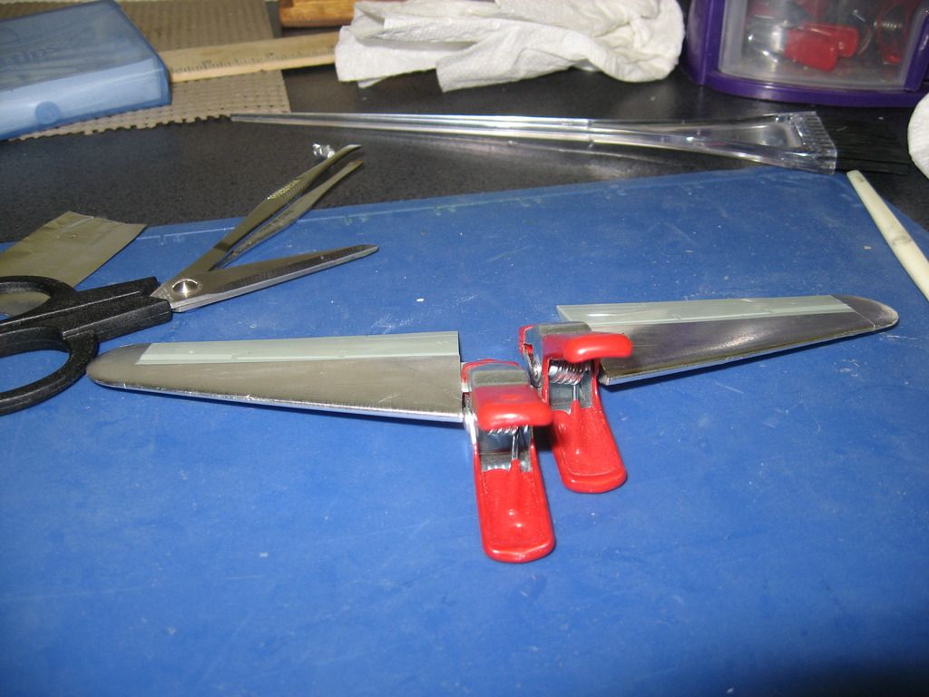

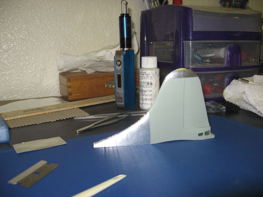

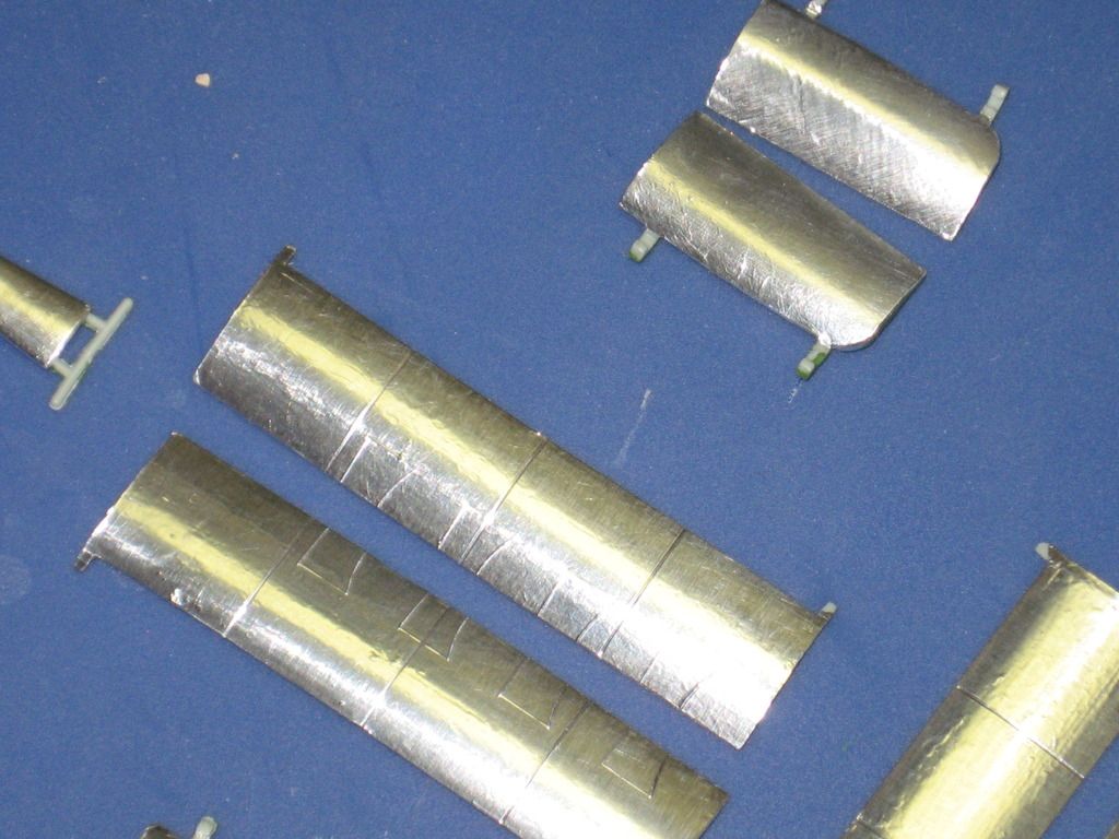

Anyways, back to the build. Bomb bays, landing gear doors, anti-tail strike gear are foiled.

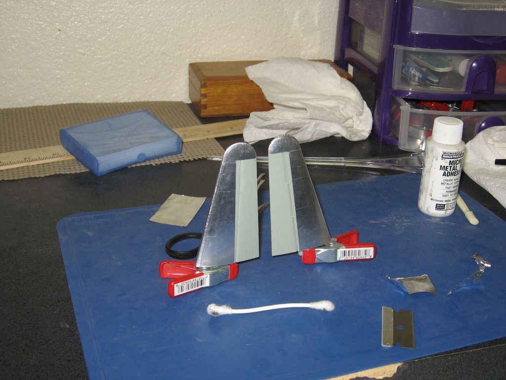

Here's somethings I've kinda picked up through trail/error and by picking others brains who done it before, I hope it doesn't sound repetitive. Everyone has a different way of foiling, your mileage may vary.
1. Practice, practice, practice. Get a donor kit and use that first. Start with the flat areas to get a grip with the application process, then move to curved areas. Here's a another trick if you don't want to use a donor kit, grab a flat baking sheet, using a sponge with water, wipe the baking sheet surface down, lay the foil down onto the baking sheet, using your hands or a tea towel, start from the middle of the baking sheet working your way out to the sides, try to get about 65% of the surface area wrinkle free.
Here's what it should look like.
You can flap the sheet over and practice that way also. This will give you an idea on how the foil stretches before you get into wasting adhesive. If you bake or cook, then you know what I'm talking about. For curved areas try the same technique on a glass.
2. Keep the application brush clean. Use a nylon brush. I've been cleaning the brush after every application. The Micro-scale adhesive will ball-up on you if you don't keep the brush clean.
3. If your type-A about your builds and everything must be "perfect" or you have a short fuss, walk away. It's time consuming, labor intensive, and will test even the most patient builders. Your always battling dust and pet hair from getting onto the adhesive side of the foil, it will show up.
So if you have a "clean room" set up, use it. Steady hands, a comfy chair("Put her the comfy chair!!!" Sorry, Python moment.) and a truck load of patience are needed. On the flip side, if you like a challenge...
4. Make sure you stock up on #11 X-acto blades and straight edge razor blades. These are your friends for cutting the foil into panels and you'll go through a lot of them. Culinary bone scissors work also.
5. Cut out panels larger then what you need. Kitchen foil is cheap, but Bare Metal foil isn't, $7.95 at LHS per sheet vs. $2.95 for a roll of kitchen foil. Micro-scale adhesive, $4.00 at LHS or online. You can order from Micro-scale direct.

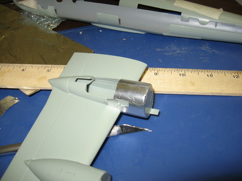

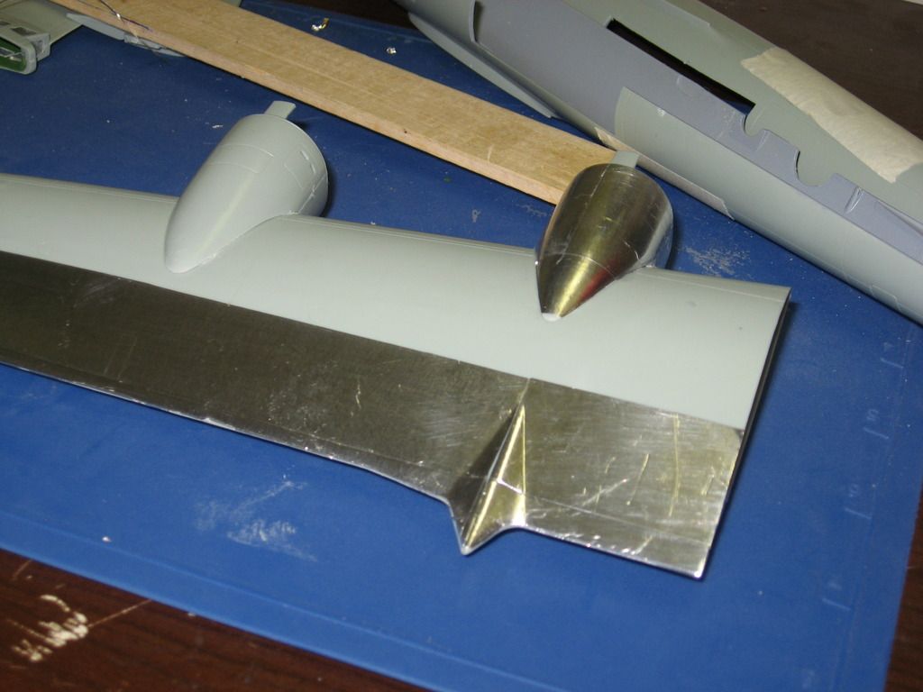

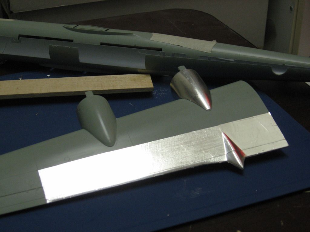

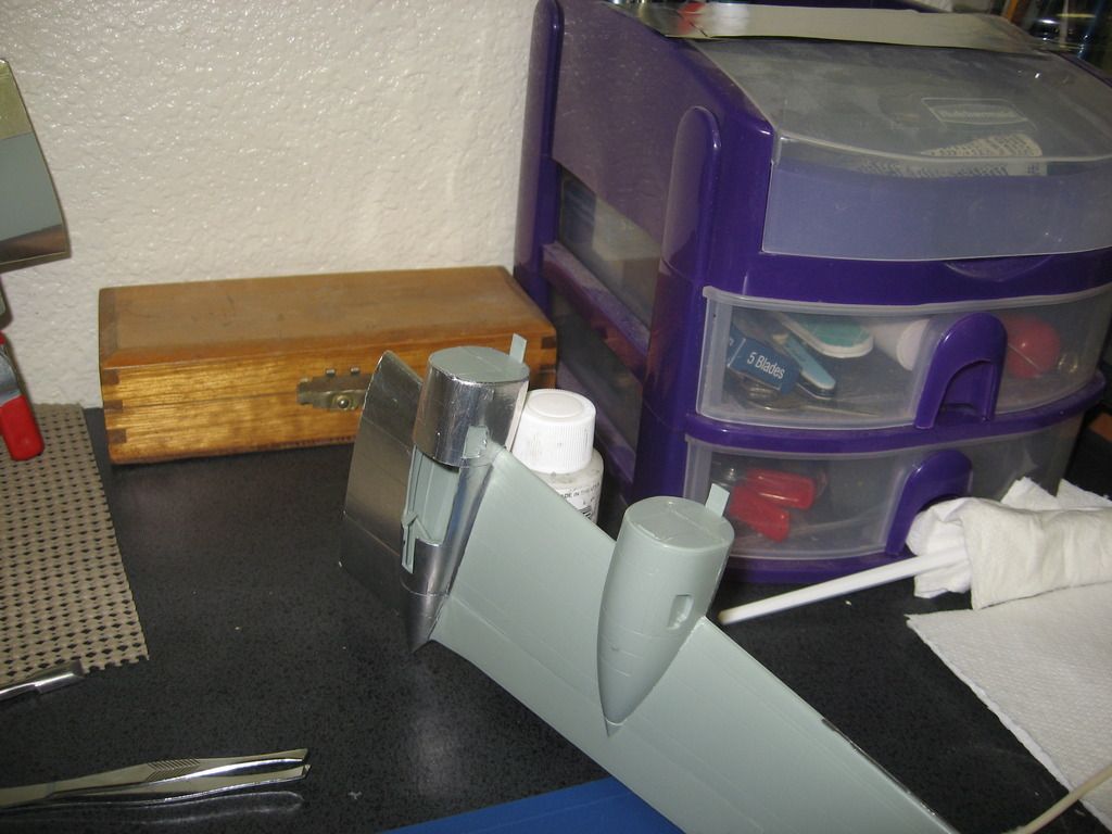

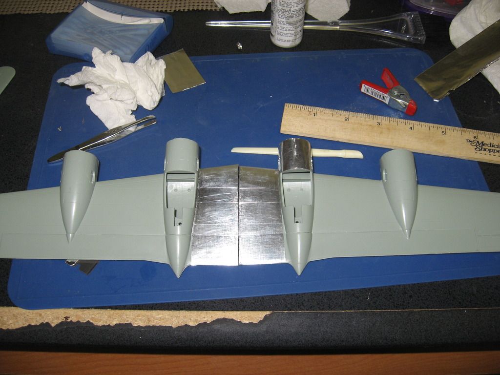

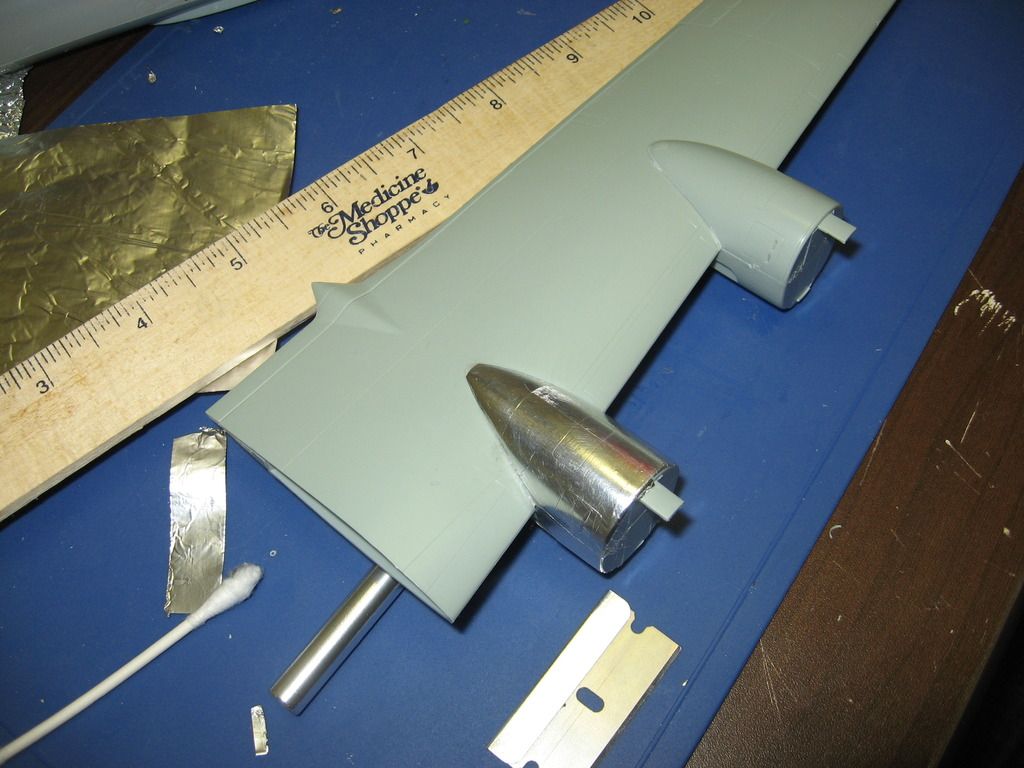

Back to the build side. Foiling the nacelles has been proving to be a challenge if not a down right PITA. After several failed attempts, I had to shift focus to other parts of the build.
Photos further coming.

Very interesting link. As far as the nacelles go, I feel your pain. But nobody said foiling was easy! It does have its advantages though-- I prefer foiling in the winter time-- as my workshop is in my un-heated garage, and that's where I have to do my airbrushing. But I can do foiling inside on the kitchen table or at my desk during the winter (unless I use spray adhesive, then it's back outside to get the adhesive down). Oh well, if model building was easy everybody would do it right?!!
VR, Russ

Posted: Saturday, November 05, 2016 - 07:35 PM UTC

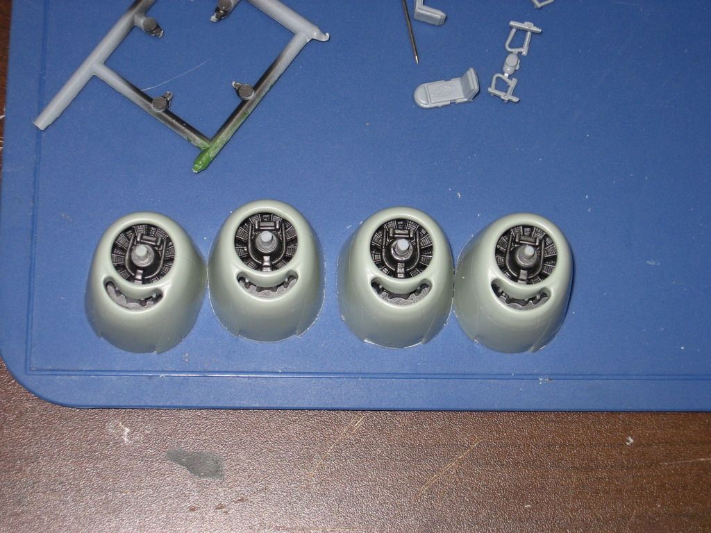

Update time.
Engine nacelles mounted.
Wright R-3350's painted. Install forth coming.

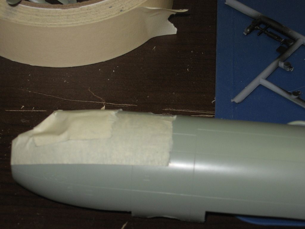

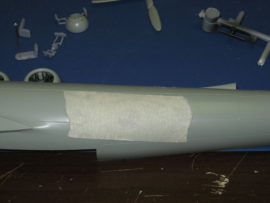

Dry fitting fuselage and removing these areas......
See ya in the funnies.......................
BigfootV
Joined: December 24, 2005
KitMaker: 1,624 posts
AeroScale: 385 posts

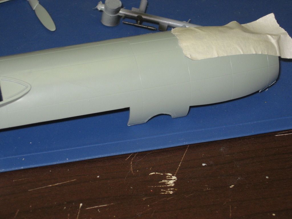

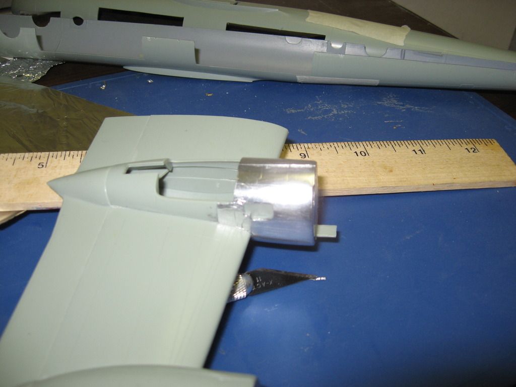

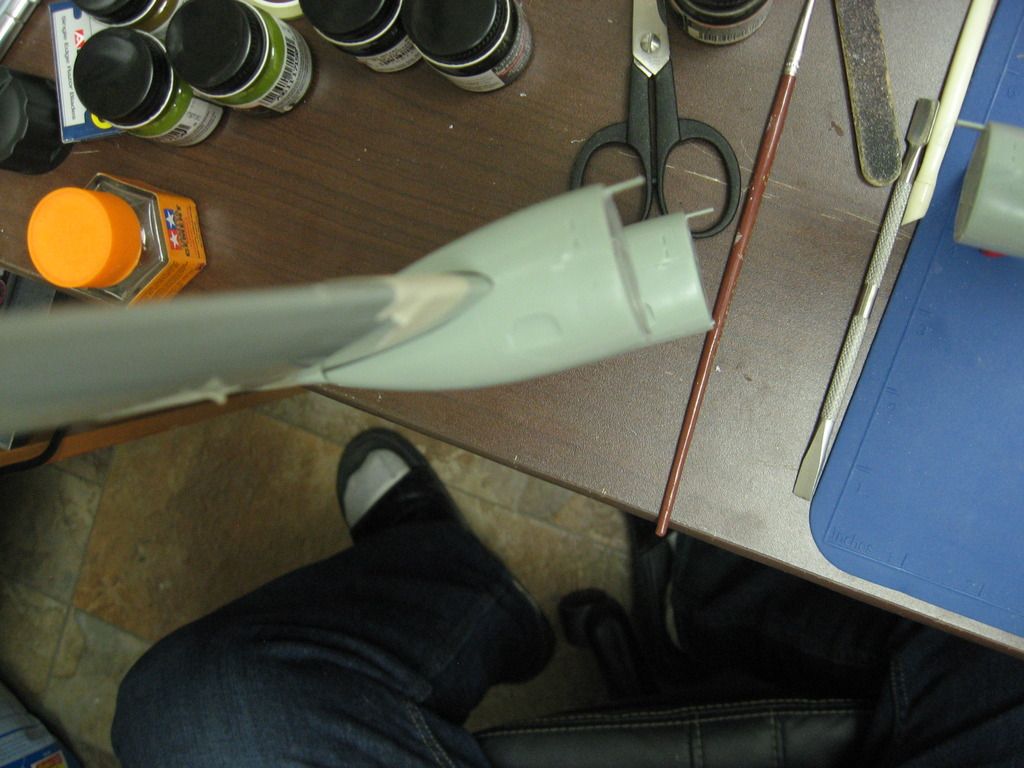

Posted: Tuesday, November 08, 2016 - 09:26 PM UTC
Remember the red circled areas, gone.
Needs a bit of clean up.
One nacelle done, three to go.
Yes, there are some seam lines that need to be worked out on the nacelle, but overall, I think I did a pretty good job. Almost like I knew what I was doing.........

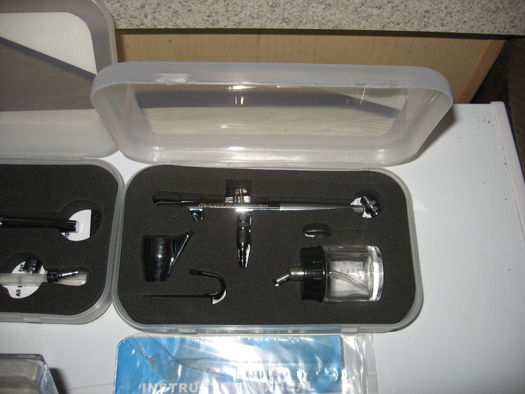

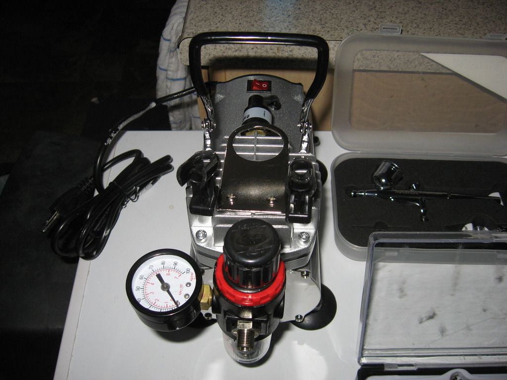

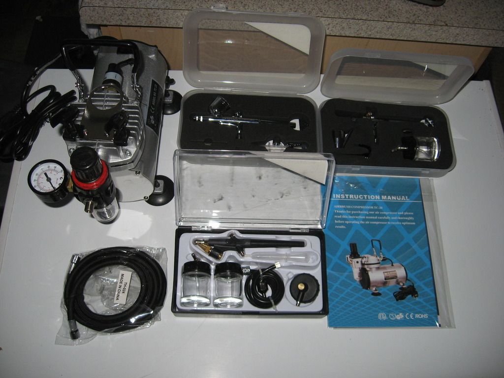

Finally today, Daddy's new toy, which arrived yesterday........and at a steal....3 airbrushes and compressor for under $100 bucks.
The compressor is very quiet.......perfect for the apartment.

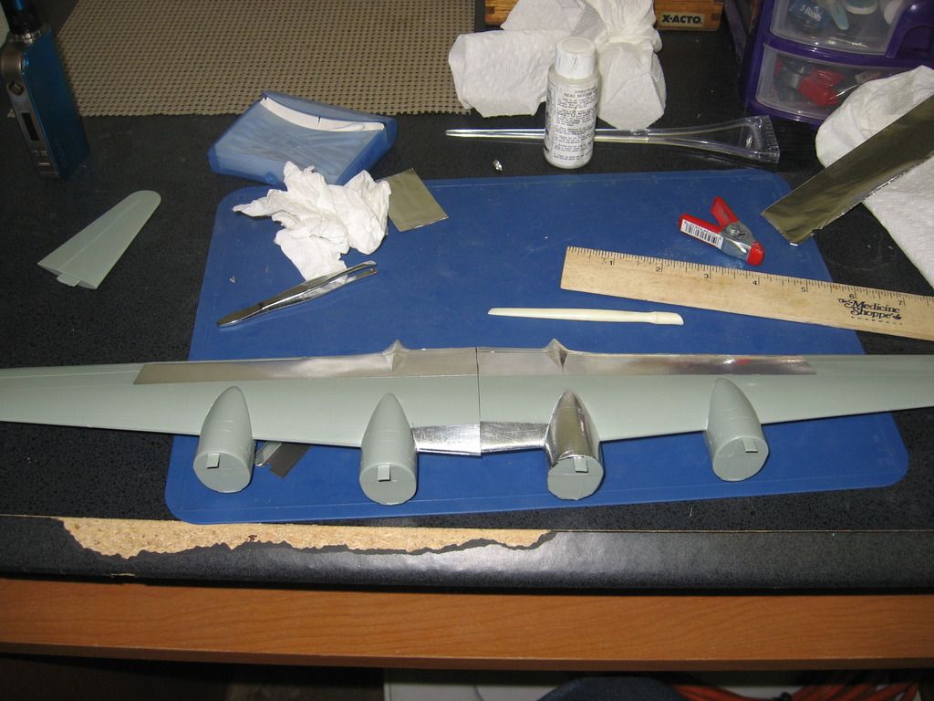

Posted: Monday, November 14, 2016 - 09:01 PM UTC
Hey Gang,

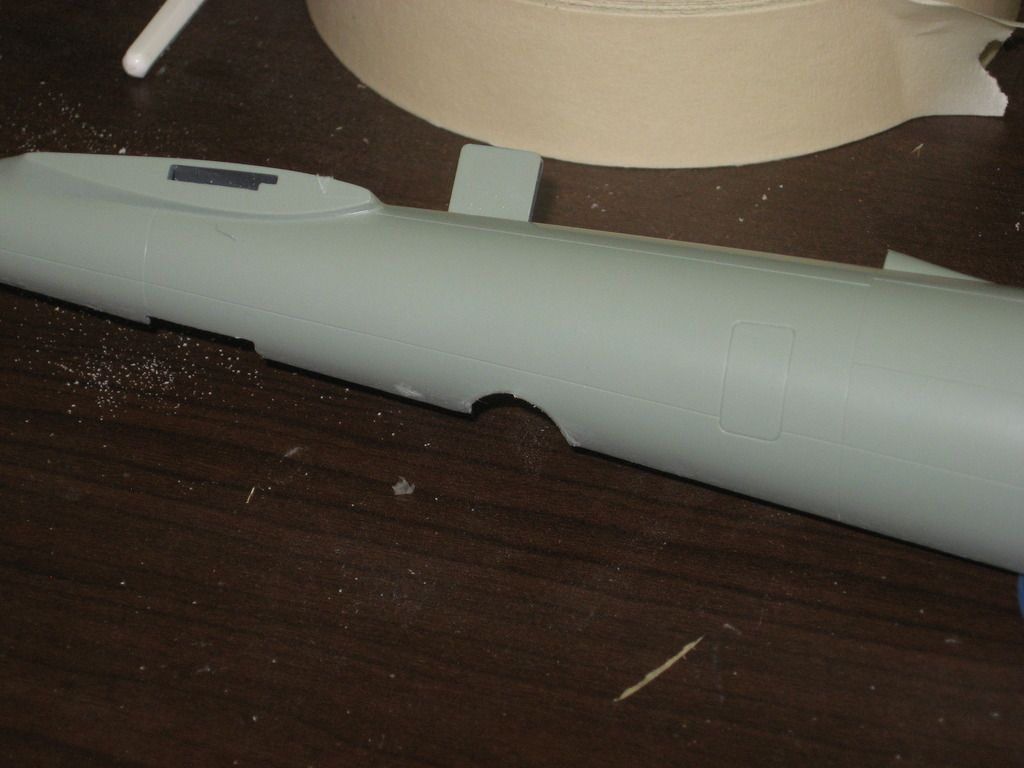

Major progress, I did about 3 hours of work last night on the kit.
Now, some of you are sitting there saying, "It took you 3 hours, to do that?" Yes, but what I didn't show in the photos is that the nacelle I was foiling earlier in the build snapped off. So, I had to re-glue the nacelle and repair the areas effected.
Also, when I was foiling the flap area on the right wing, the damn thing moved on me. Thus, causing a bubble effect to form, so I had to go back and remove the effected area.
I also went back and removed and re-foiled the left wing area that wrinkled up on me earlier in the build.
Note: The area that was wrinkled was a combination of two things.
First was the foil, I was at the end of the roll, which makes foiling it out smooth more of a challenge.
Second, there was an area that was scratched up, which caused the foil to catch and wrinkle more than it should. So, sanding and filling were needed to make it disappear.

Posted: Friday, November 18, 2016 - 03:39 AM UTC
Russ,
Thanks. Foil has a way of going were it wants to, which I've been noticing as I go with this kit. With the compressor now in the "Man cave", I don't have to worry about the weather any more.
Joel,
Just saw your reply. Thank you so much for that comment!
Complex, yes. It has tested my skill level. I must admit, I have to be in "foiling frame of mind" when I sit down to tackle it. No distraction. The only thing I've found to be a PITA is try to get the edges to line up and not seriously over lap.
More photos: Flap area that was damaged was repaired.
Tail section completed. Left wing upper surface almost done.
