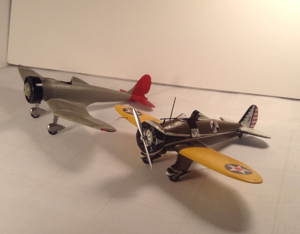

Looking good Richard! Kinda reminds me of a Boeing P-26 in a way. Has to be that Hump behind the cockpit.
This would look awesome next to a build of Finemold's KI-10 Perry biplane fighter, I think.

Brian - I agree on both counts-

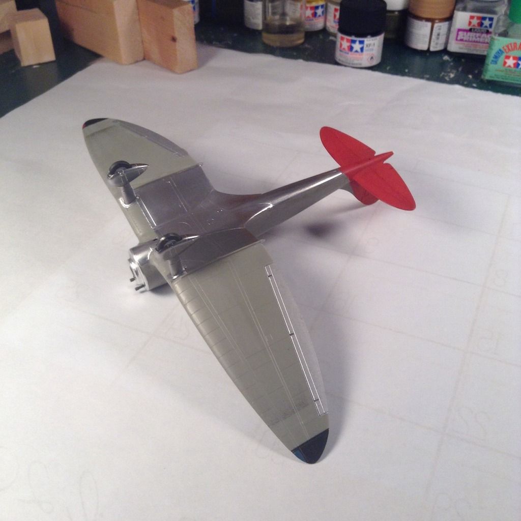

The tail has been painted red and wingtips black- navigation lights red and blue-green over silver base.
The undercarriage pants and fairings proved too difficult to foil so they were shot with Vallejo gloss black surface primer and Vallejo MetalColor
Duraluminum.
I've begun the foiling on the underside with BareMetal Foil Matte Aluminium.
Thanks for looking - Cheers ! Richard

Richard,
A very interesting concept of foil and NF Metalizer paints. I'm quite interested in seeing the results. So far the bottom strut fairings look right at home with the Bare Metal Foil sections right next to them.

Joel - this is my first experience with the Vallejo MetalColor line and I am very happy with it . Watched a couple of demos at their booth at the Nats in August and was very impressed so I thought I'd try it. The hardest thing for me to get my head around was using it straight from the bottle without thinning but indeed it shoots better that way - old habits/ideas die hard , especially for this Luddite. I think the straight Aluminum color may match slightly better- the Duralumin color is a little darker than the foil. The next thing I am wrestling with is whether to clear coat over the foil. The foil looks great alone and I would hate to spoil it but I fear the clear coat may be necessary to seal the edges as the want to lift every time you handle it.

I haven't used BMF in several years since my 1/20 scale McLaren MP4/4. I did find the foil to be rather durable as long as you don't rub an edge. I do seal all my Metalizer paints with Testors Metalizer Sealer, which isn't a gloss nor a matt finish. For those I do use Alcads Clears.

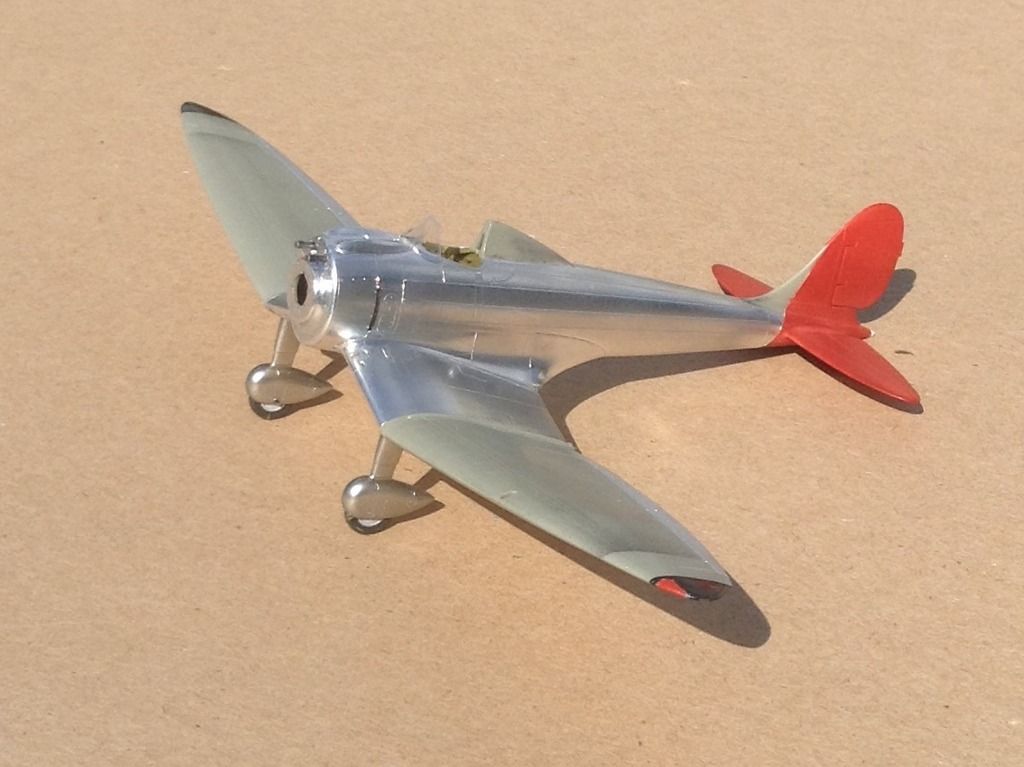

The foiling has progressed to the upper fuselage/inboard wings-
If I were to do this again I would paint the wing root fillets as well. These were very difficult to get the foil to conform to, especially at the leading edges. I wound up having to torture several small pieces to get the foil to take the shape. More to come and thanks for looking.

Richard,
The foiling looks mighty impressive. You've certainly joined that exclusive club with Gary.

Richard,
She's looking quite nice! Wing roots are always the hardest area on a plane, so I always do those first and work my way outward.

Gary - Thanks for the compliments and the pointers. Aside from the root areas the next problem for me is the trailing edges and the fragility of the foil here - even with the most careful handling I inevitably brush the trailing edge and lift/tear the foil ap tiny bit . With the benefit of hind site perhaps I should have lapped the upper surface foil down and around the traililing edges in a " hem" fashion. I assume a clear coat will help this situation but I am reluctant to do so because the bare aluminum looks so good . Any suggestions ? Thanks - Richard

Richard,
Clear coating your trailing edge won't stop it from being curled if you brush against it. I have two rules about edges, both trailing and leading. 1. Do them last. 2. Always wrap around the edge if you can.
Foil has some stretch that you can exploit with patient burnishing. Here is a mini-tutorial I've done in my N1K1 thread: foiling a curved wingtip ...nearer the bottom of the page.
I've only used a little BMF. I think the sheet I have looks a little pebbly when I burnish it down...plus, it's expensive! I don't mind wasting a ton of kitchen foil. For only 2-bucks a roll, you get a lot of coverage.
If you can find some good close-ups of your wing areas for that bird (I know...finding useful images of Japanese warplanes is hard!) you can use panel lines that the manufacturer may not have included.
