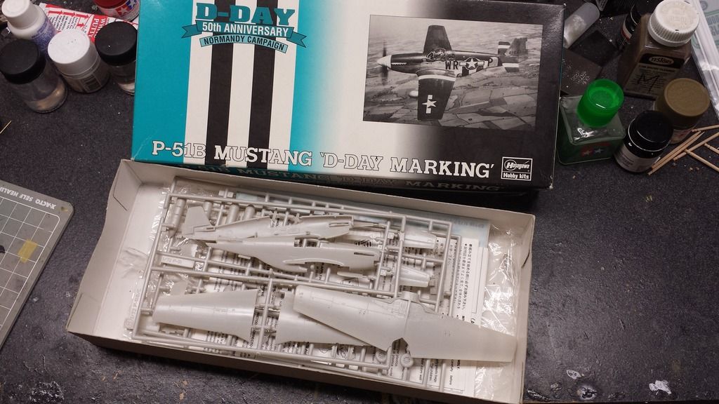

Work has kept me from the bench for a bit but I'm finding some more time so I thought I might try to get a build done for this campaign. Ive had a 1/48 p51b under construction since last fall but as that is pretty far along Ill see if I can get this hasegawa 1/72 p51b done in what time remains.I see no reaspn to complicate this one with any aftermarket and the main pieces fit very well so I see no obvious obstacles to getting it done. I think i may even use the kit decals (not the stripes though)

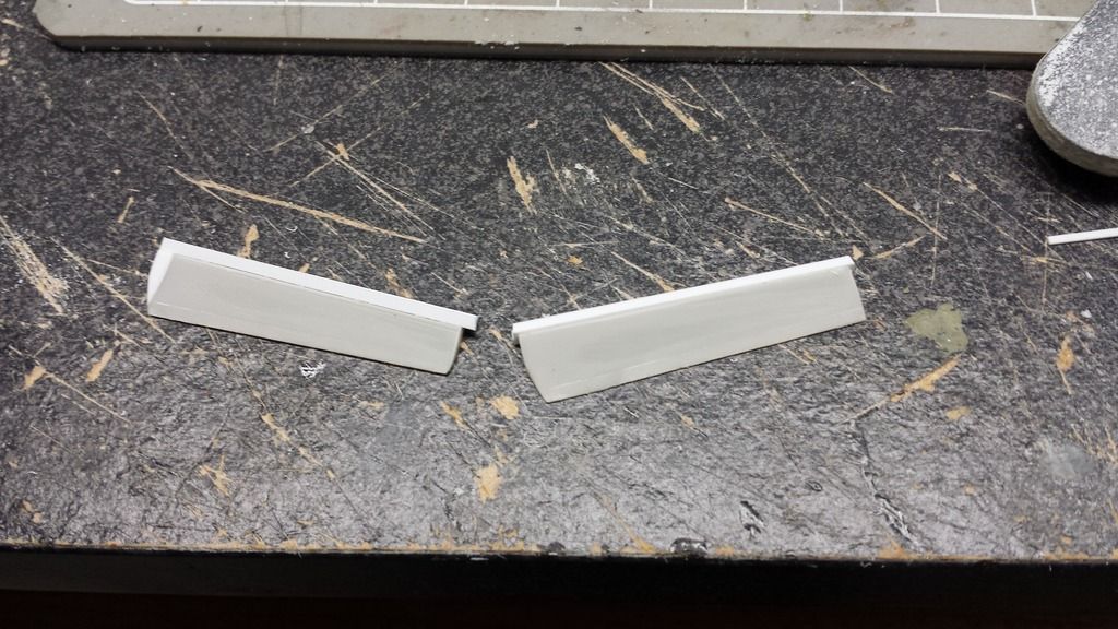

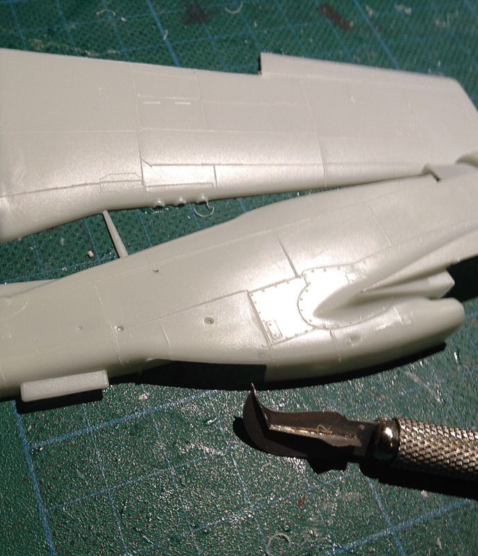

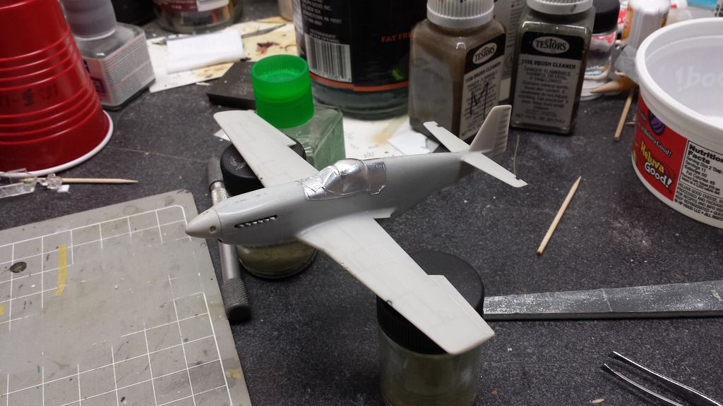

The first day of my p51b build was quite productive. Inspite of my declaration to keep it simple I couldnt help but to cut out the flaps so I can drop them. Im using styrene to fill out lost portions of the flap which will be sanded to shape and scribed.

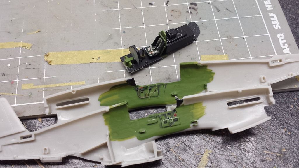

I then filled and sanded most of the wing panel lines and then got to work on the cockpit. Since im planning on using the kit canopy with its inherent distortion the cockpit doesnt require any uprages as far as physical detail. I added thin strips of tamiya tape for the harness, used the kit decal for the dash and then used paint and colored pencils to detail the cockpit. I think it turned out well, just some finishing touches before the pit is done

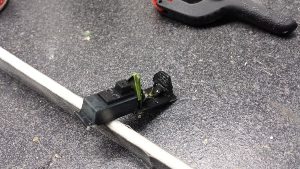

After dry fitting my fuselage and cockpit I made some minor cockpit mods to address some obviously missing details. The missing rollover frame behind the armor I can forgive but missing med kit/headrest is pretty prominent imho. I made both from styrene strip. The med kit was cut and sanded to a rounded rectangle with paint making up the rest of the detail. My appologies i didnt realize how awful this pic was, but you get the idea.
The A frame was just 2 strips glued to the back of the armor and chopped off at the top. I painted the shadows and highlights which really gives it a more realistic depth and hides how out of scale the strips I used were. Using thicker pieces complicated installation, im going for quick and easy here!
I also got some work in building the flaps back up, they're coming along well. I'm glad I took the time to cut these out.

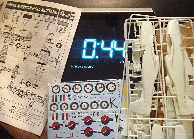

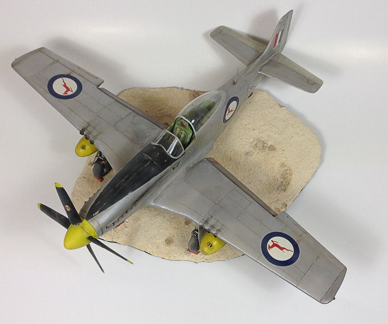

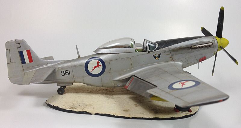

1/48 Revell P-51D that I bought dirt cheap but as this is an old kit it's,.. Well it needs some TLC, the decals (with a nice looking canopy) are hasa bought at some point fair also cheap
Still having problems finding my way with re-scribing so perfect practice

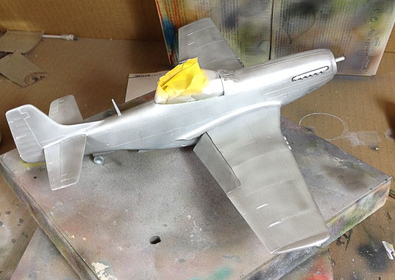

Took off the flaps in order to give the model a more lively look and added scratch detail in the interior
After priming flat aluminum which I flattened more with oils after this I added some aluminum rubbing compound to make the aluminum skin more worn but that does not come out on the photo's
Made a simple base and scratched the blocks and inlet caps and that's it a SAAF P-51 that served in Korea

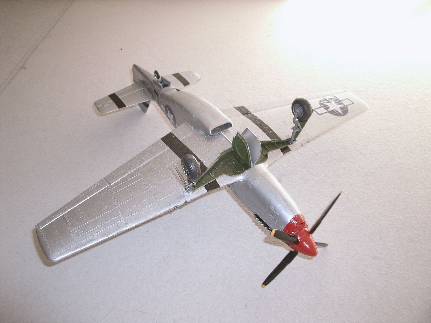

The fastest Mustang ever to fly, has reached the finish line at last

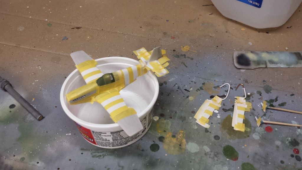

Some D day stripe masking action!
Glad this bit is behind me, 2.5-3 hours of masking that mess, tail ID stripes too. I've done alot of mental flip flopping over the NMF between using tamiya as12 and alclad. Ive not done a NMF build yet and with the clock running down I decided to stick to the original plan of using as12 but with a slight twist. Im going to preshade the panels immediately around the exhaust as these always appear darker. I think this is the only variation in the BMF I need, the rest is pretty broken up by the OD, markings and invasion stripes or is on the underside

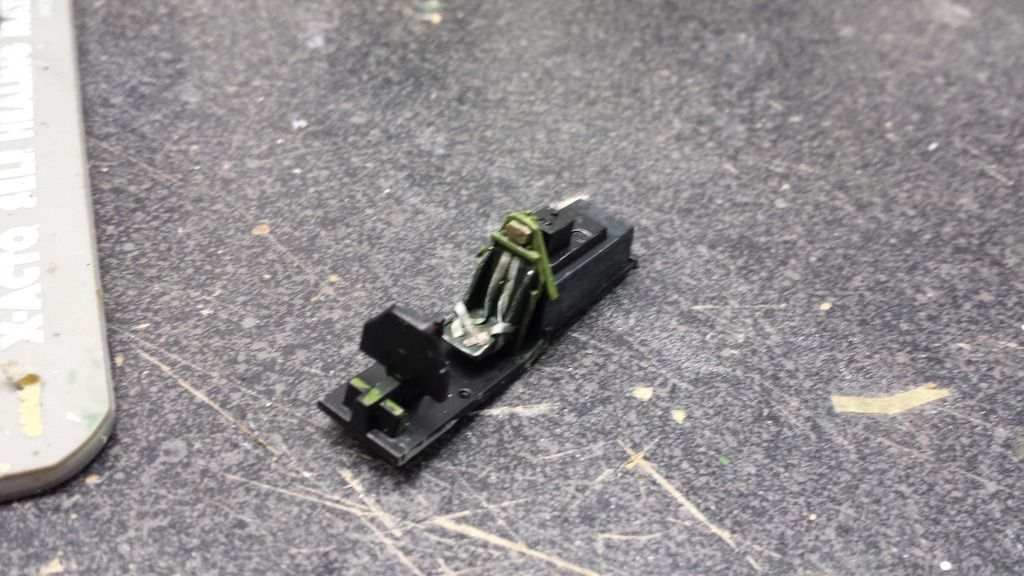

I´m began the P51 giving some details to the seat,

The seat finished,
