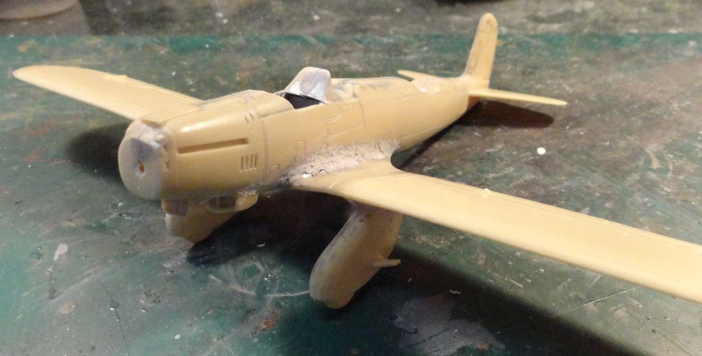

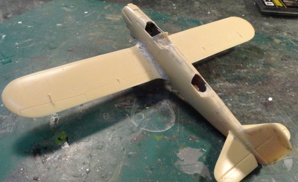

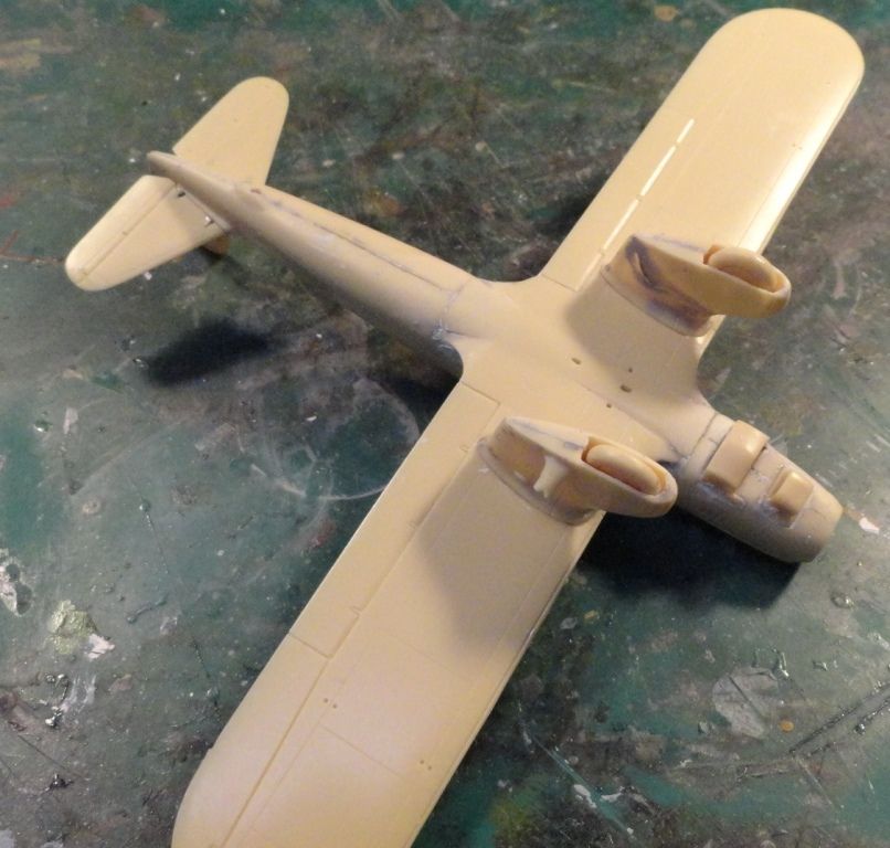

Finally made some more progress on the Curtiss A-8. Yard work/gardening is taking more time. I have the air frame together . Required a lot of Milliput in the fuselage/wing joints. As can be seen in the photos, still smoothing those joints. Need to blend in the wheel pants into lower wing.

Another try to get larger photoes for your viewing:
I have been having problems with consistency when loading photos from my Kit Maker Album. Sometimes small other times large. Photos in the album are all generally same size. Any recommendations?
I used Photo Bucket for this set of photos.

Oh good, we have some airframes coming together. Both wonderful rarely modeled prototypes.
Ranger74 - the Shrike kit looks to be a good representation. You have some bondo fairing work ahead, that is certainly part of the game for both vac and resin kits.

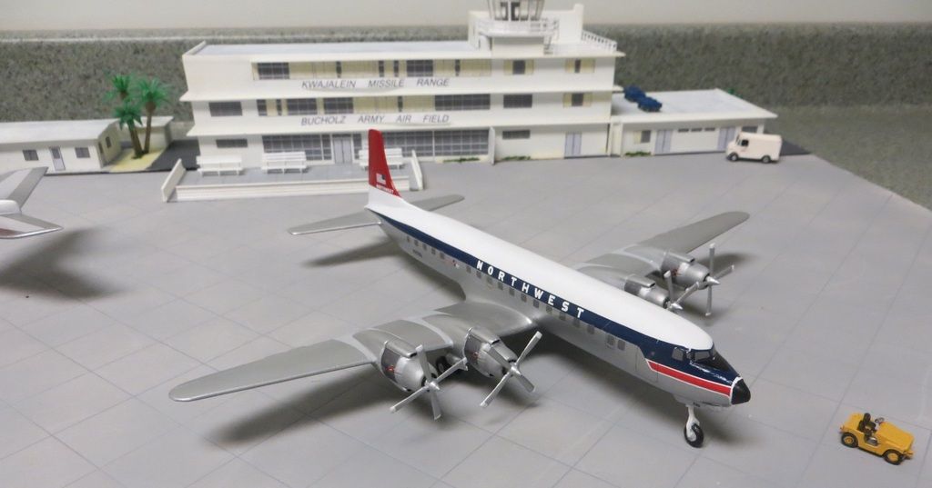

Finished
The kit was as good as a vacuform kit gets. the decal was difficult to work with, but ended up ok.
Northwest bought eight DC-7Cs in 1957. Two of them crashed in the ocean with loss of life in 1962 and 1963. The rest were sold off into freight service. the last one, also the first, N284 was off the roster in 11/68. N288 seen on Kwajalein in this bit of film left the roster in 5/68.
I believe but cannot prove, that my family and I flew on this aircraft at least once between Kwajalein and Honolulu in 1967 or 68.

Really Nice Jonathan!
I hope mine comes out as well.......
I know what you mean, this may be my "First" and "Last" Vacu-form kit....even though I have 2 more in my stock......
BTW, I like the Terminal and small diorama.
Is that kit or scratch?

The diorama is scratch built from Evergreen styrene.
you can see more of it here.
It's a model of a real place.

Jonathan;
That is awesome work and way nice terminal scratch, good job BZ

Fantastic build Jonathan. It's a very smart looking aeroplane. And I like your airport terminal too. If space was no problem I'd love to do something like that to display my builds.

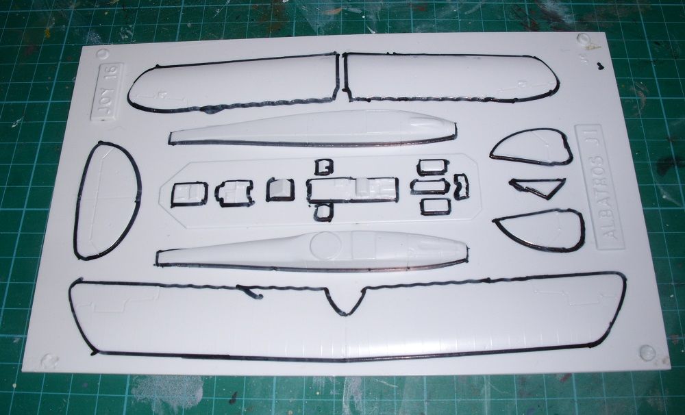

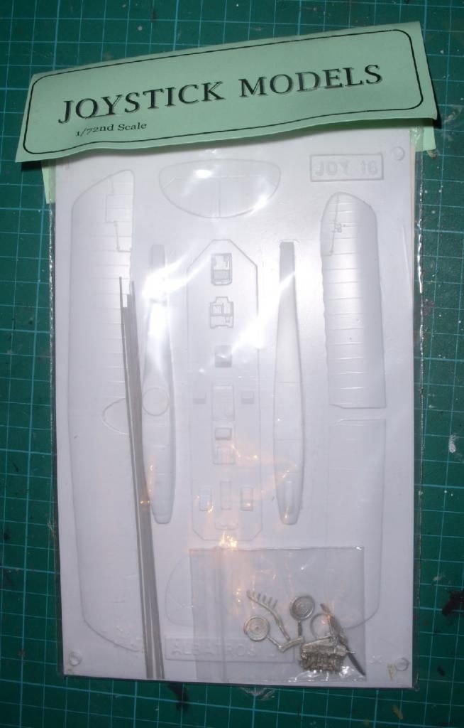

Here's my build.
The Joystick Models 1/72 Albatros J.1.
The J.1 was an armoured battlefield support aircraft introduced in late 1917. The cockpit section of the aircraft was covered in 5mm steel plate to protect the crew from ground fire. Only the rear gunner was armed with a Parabellum machine gun and grenades. A handful of aircraft had the machine gun replaced with a 20mm Becker cannon and were among first tank-busters. Although successful, the lack of armour plating around the engine and radiator left these areas vulnerable. Albatros later redesigned it as the J.II with more armour plating and even fitted 2 downward firing MG08's for strafing missions, while a few had a belly mounted 20mm cannon on a flexi mount.
So, an interesting type that the mainstream manufacturers have not touched. So far anyway. I can certainly see Wingnut Wings doing one if they continue their trend of kitting the more unusual types.

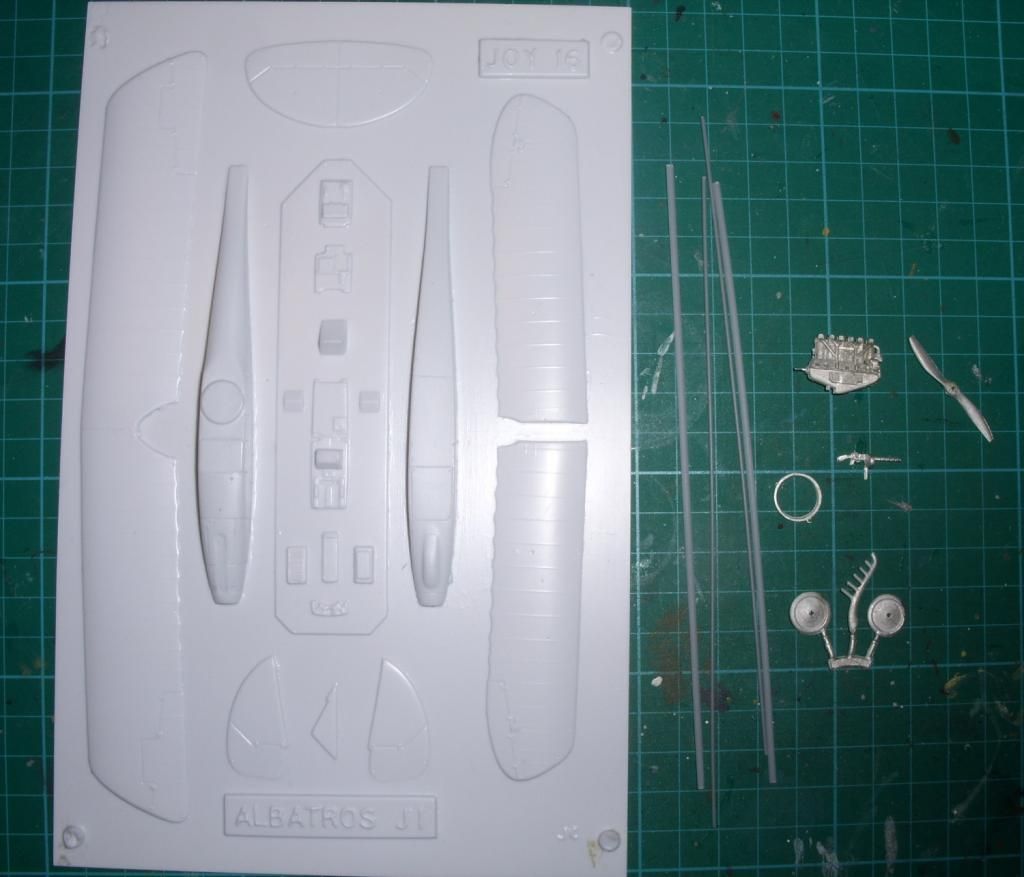

So onto the plastic.

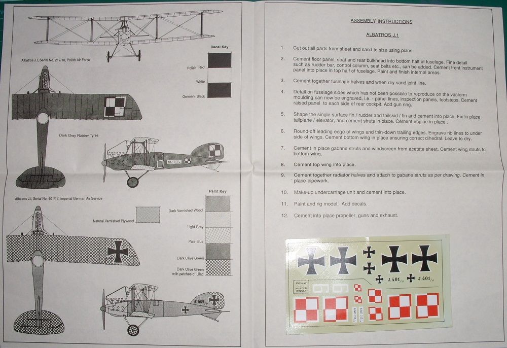

And that's it for the instructions. 2 small sized plans and a written instructions. The decals are quite nice though and give the option wartime German or post-war Polish air forces.

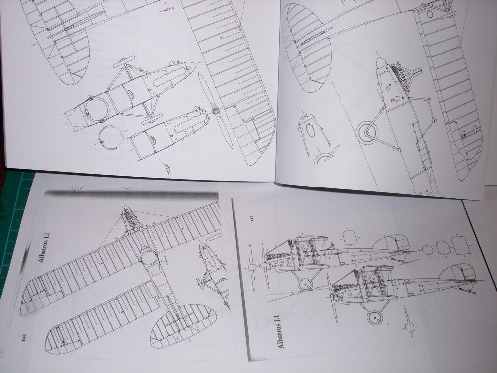

My main reference is Jack Herris' German Armoured Warplanes of WW1, which contains sets of 1/48 plans for the J.1 and some very useful reference photo's. I was able to scan, reduce and print a set to 1/72.
Now, the struts seemed like they could be a problem, but using my new set of plans I compared them against the spare struts in a couple of Roden Albatros kits in my stash. To my amazement the V-struts and longer wing struts, intended for the D.1 boxing, are exactly the right size! Problem solved.
First step tonight has been to mark out the parts. I'll start cutting tomorrow.
