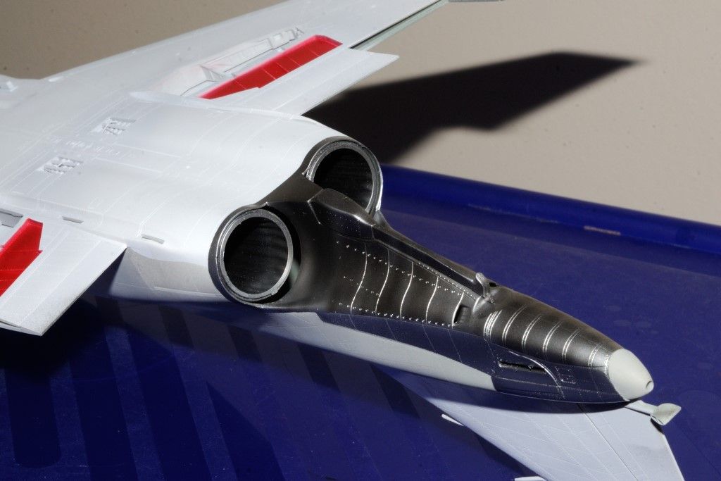

Here's a picture of my F4B exhaust that I also posted in my build blog. All the various panels started with a Gloss Black Base color.
