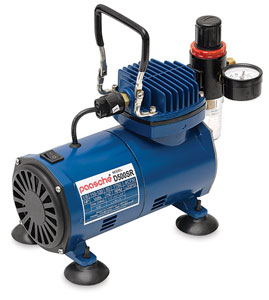

Hi Joel, sorry for the delayed reply. Thanksgiving, holiday shopping, etc.
I am using Testors Modelmaster enamels, with Testors' brand thinner. I only use the paint cup that came with the brush, I've never tried to use the jars. Thinner/paint ratios is about 50/50.
Now, as for PSI, here's where I'm a bit confused. I have a PSI indicator. When I initially turn my compressor on, it sits at about 60 or so PSI. When I start to spray the airbrush, it drops down to about 25 PSI. Which level is the brush actually spraying at?
This photo is the assembly I use, it's a Paasche compressor and although I don't remember the exact brand of the PSI meter and moisture trap, it's the exact one pictured.
In my humble opinion, 25psi is twice what you need for air pressure with enamels.
I use enamels a lot and never go over 10-15 psi. Try it ,you have nothing to lose....
Jake
Aaand this is where I bring up that I'm not exactly sure how to adjust the PSI on my compressor.

60 PSI is way too high. Drop it to 15 or 10. When you see your gauge drop when you are spraying is because whatever your setting is, is what is going out your airbrush. The meter will drop because there is no pressure to measure as you spray. That setting is what is going out your airbrush.
KitMaker: 6,740 posts
AeroScale: 6,035 posts
Posted: Thursday, December 05, 2013 - 03:03 PM UTC
It appears that the pressure adjustment is made using the black knob just beside the pressure gauge. Compressors like that are the reason I like using one with a tank. It's much simpler to get a consistent pressure out of it.
KitMaker: 9,799 posts
AeroScale: 7,326 posts
Posted: Friday, December 06, 2013 - 02:45 AM UTC
Kevin,
It's been a long time since I used a compressor without a holding tank. Your compressor motor is always running in order to pump air, the psi is usually regulated by a knob on your moisture trap, as your compressor doesn't come with any valves to adjust the out psi. The longer your compressor runs, the hotter it gets, and that changes the psi, but the out valve should still keep it within it's acceptable range. With a tank system there are two gauges, one for the internal psi, and one for the out psi. As Jessica said, with a tank the pressure is regulated and consistent, & the air is at room temp.
The other issue, and it's a major one, is that with a tank the flow is smooth and constant. With a continuous running diaphragm compressor, the flow is not smooth, but rather pulsates as the piston forces air out of the top of the chamber at the top of each compression stroke. You can actually feel it if you shoot air at your hand from up close. That pulsation does effect the smoothness of the flow of paint. But not to the point of your examples. Like I said, I used one for more then 10 years, and could do free hand camo paint schemes without any issues.
Your 1:1 ratio of thinner to MM enamel paints shouldn't be that much unless you're shooting blacks or very dark colors. Mid colors and lighter should be 2 parts paint to 1 part thinner, as the MM enamel paints are on the thin side compared to acrylics.
I mostly paint these days with either Arcylics or lacquers, and each has their own psi ranges for my painting system. Enamels are right in the middle. Start with no more then 15 psi and test with it. Your compressor isn't very powerful, so that's why I suggested 15 rather then 12 psi max. If you find that opening up the cone doesn't help the flow rate, then increase the psi a little at a time till you're able to shoot a smooth line.

Thanks for the info, Joel. I've tried looking around for a compressed air tank and I've found I have no idea what to look for. The compressor I have is a 1/8HP Paasche D500. I'm seeing a lot of compressor/tank combos online for ~$150-200, but considering I spent about $110 on this compressor just last year, I'm not interested in buying a whole new one just to get the tank. The thing is, I can't seem to find any smaller tanks online. The smallest I can find is a 5 gallon, 135psi Craftsman holding tank (which seems like a real steal at only $30), but I'm not sure if 5 gallons is overkill, or if my 1/8HP compressor can even fill up 5 gallons in a reasonable amount of time.
Jessica is absolutely right about the adjustment knob. the black knob will turn lowering or increasing the pressure. On the pressure gauge you will have two scales, one red which is psi and one black which is BAR. Use the red gauge to adjust your psi to 15PSI

Kevin, The holding tank/compressor is sold as a unit. If you ever decided to go with a separate tank, Buy a used tank and gauge from a dive shop, and use CO2 to fill it. The tank will last a long long time. Your compressor is fine. Just that the air is delivered in pulses. By the time it gets to the gun itself, there shouldn't be any issues to be concerned with.
The issue now is to get to the point where you can airbrush a consistent line.
Posted: Monday, December 09, 2013 - 01:22 PM UTC
Kevin, have you turned the top black knob so that it reads 12-15 psi, then tried to paint? I'm pretty sure that will solve your issues. Thin the enamel paint 1:1 to start with.
