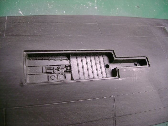

ok so I manged to get some work done finally. finished the main landing gear have a little body work to do on the center spar.but its mainly complete and I will start working on the forward landing gear next.as you can see in the last pic all of that will be cut away.
sorry to keep everybody waiting life has been hectic.if anyone else is building one feel free to post and share

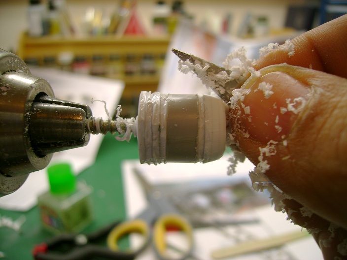

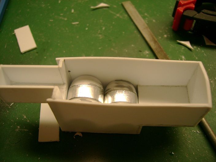

started creating the front landing gear compartment.first I boxed it in...
then I cut some sections from an f-16 fuel tank to begin creating the two nitro tanks which I then stacked plastic card on until I reached the desired length...
I then attached them to my drill and used it like a lathe with a hobby blade to get the desired shape...

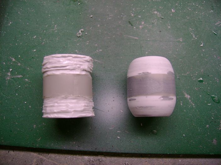

Here is the differance after smoothing and filling..
And here is the end result I will be detailing this and post soon...
