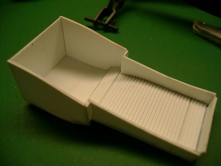

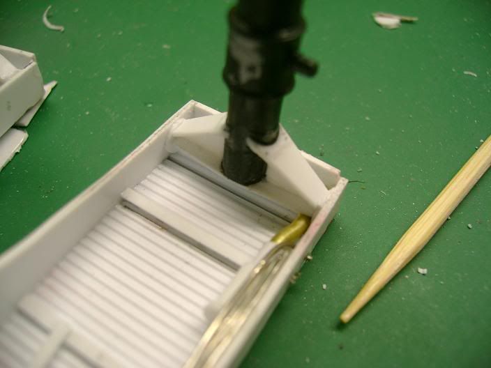

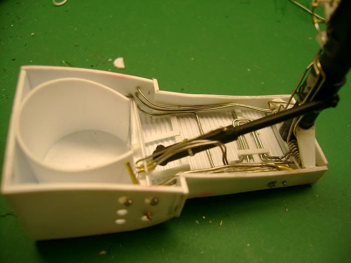

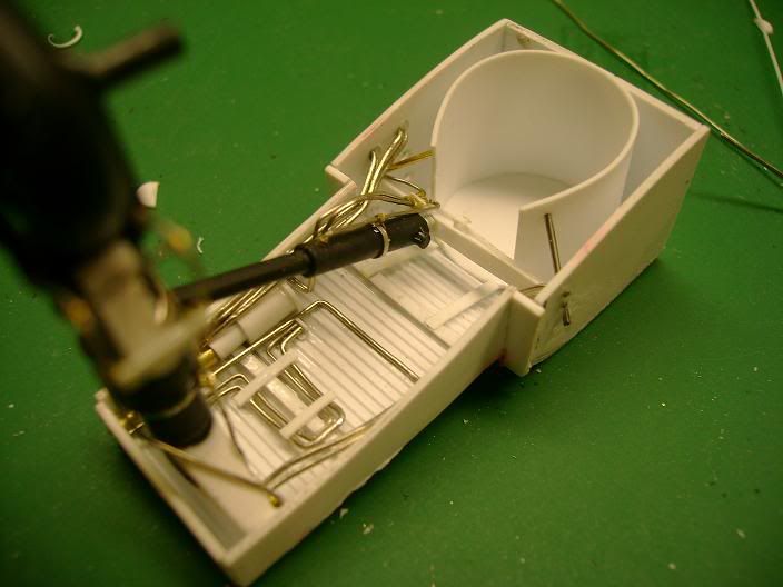

finally an update but you will be able to see what is taking so long.I had to bend and use a pc.of corrugated styrene to simulate the ribs on the inside.I also re worked there shape a bit to fit more into scale.I softened up the sheets with my wife's hair dryer

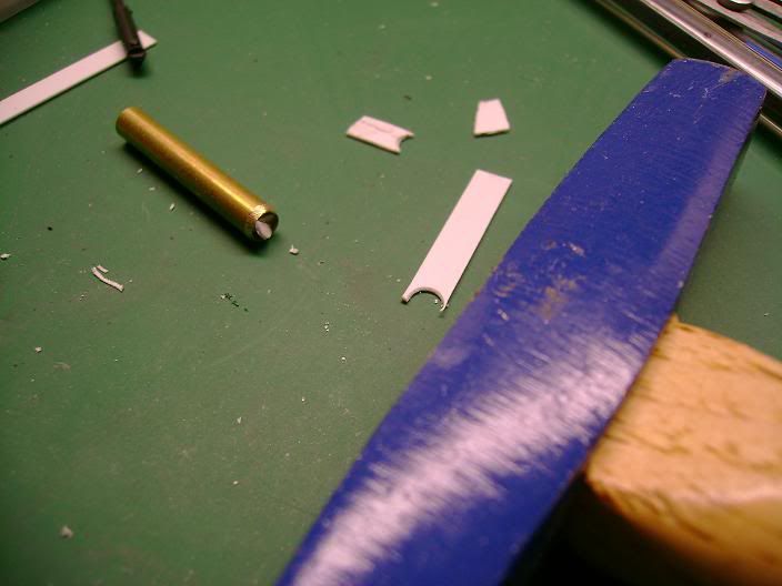

I came to need disc so I made my own hole punch with a pc.of brass tubing and sanded the end sharp and walah DISC!
now for the part that is taking to long lol.the wheel bay heat shields are under scale but im still thinking of replacing these I haven't decided yet.I completely redesigned the struts and so on.
that's all on this shot more soon

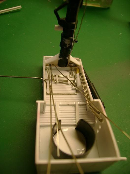

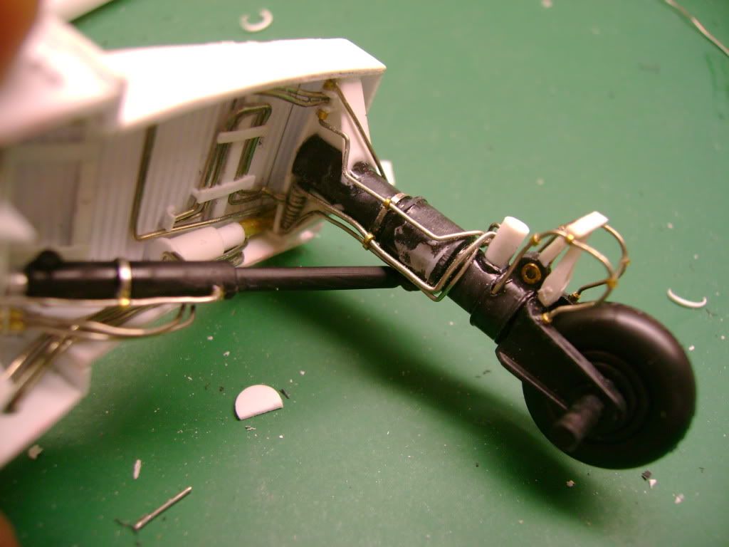

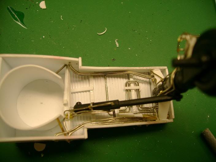

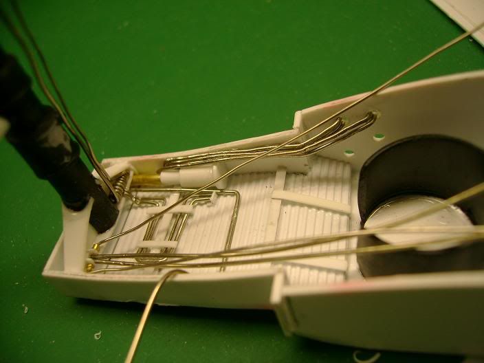

well I finished one lol.....completely rebuilt.I compressed the landing gear as 3 out of 5 planes that Ive looked at after sitting for awhile are.I took out and scratched the heat shields I left the actuator loose so i can straiten the landing gear once it is installed pics.....
more soon
