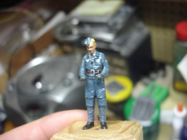

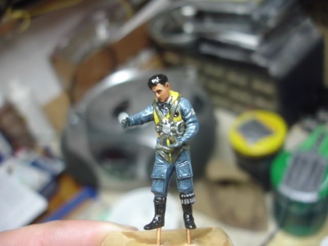

Here are some so so pics of two 1/48 tamiya luftwaffe figures i painted a little while back. They were painted with enamels for uniforms and equipment and artist oils for the faces and hair. I used the old "how to build dioramas" book by sheperd paine as a guide for using oils on the faces and the shading/ highlighting of the uniform. I also got some guidance from the historicus forum on mixing oils for the blond hair. I did have some prior experience painting 1/35 figures (10 years ago!) but none of them can even approach these two smaller figures. Not trying to brag, just trying to show what can be done with careful research and patience. Im not very familiar with acrylics so cant give advice there. I used alumnium for buckles and such and with a flat coat they look good. Using a light gray is an excellent choice for uniform items, most of the eagles were cloth anyway and buttons were often painted, pebbled or dull. Few of these items were actually shiny. Do some internet searches to find pics of the uniform items, plenty of good collector sights that can give better info that box tops and instruction sheets. ( i should have used a duller yellow on the float vest)
Excuse the gloss coat, they got a flat coat later.
