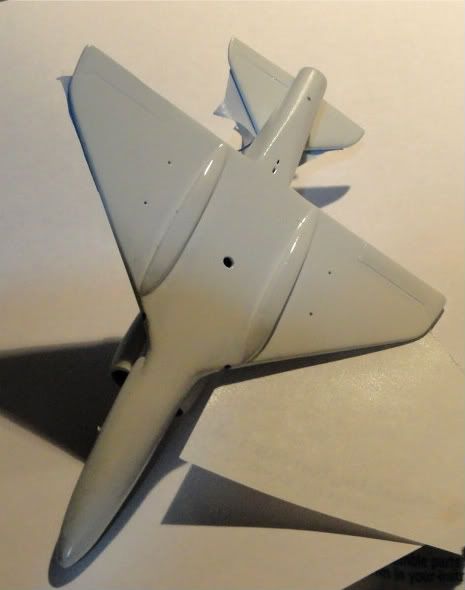

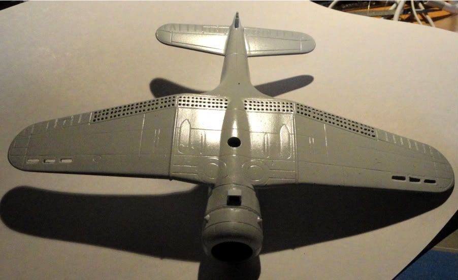

Something under helps, these two were shot at the same time, same ab, same mix. Testore enamel white, thinned 1:1, pressure ~20 PSI
A4D-1 several failed coats of gloss white sanded down and resprayed with gloss white:
SBD, 1st coat of gloss white over Testor's rattle can primer.
In person, the A4D is a high gloss, showroom finish, the SBD is more like a semi gloss.
YMMV
