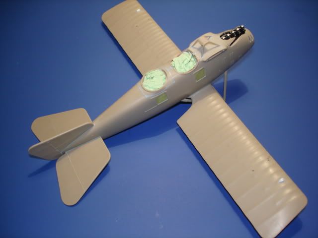

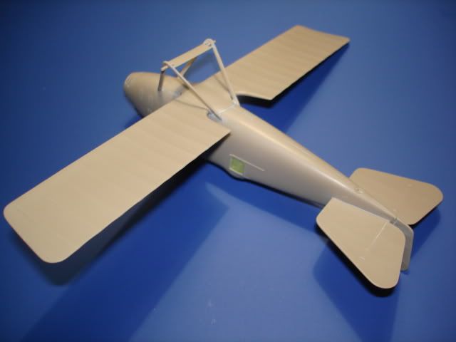

Posted: Monday, June 07, 2010 - 07:41 AM UTC
Sprayed with Allcad Grey Primer
wings testing fit

The primer shows some problems which i have to corect.
So sanding, filling with putty and sanding again.

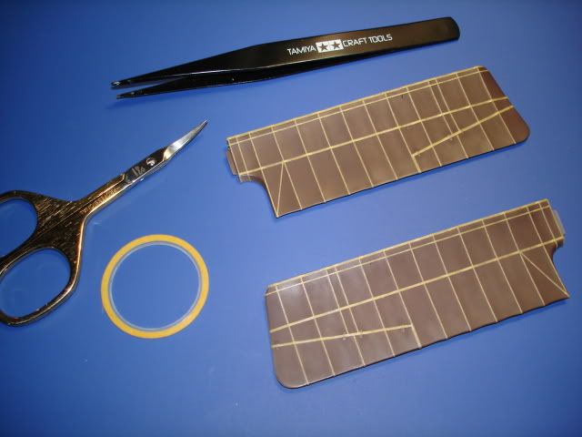

Mahogany Brown for the under surfases just for base color for presading.

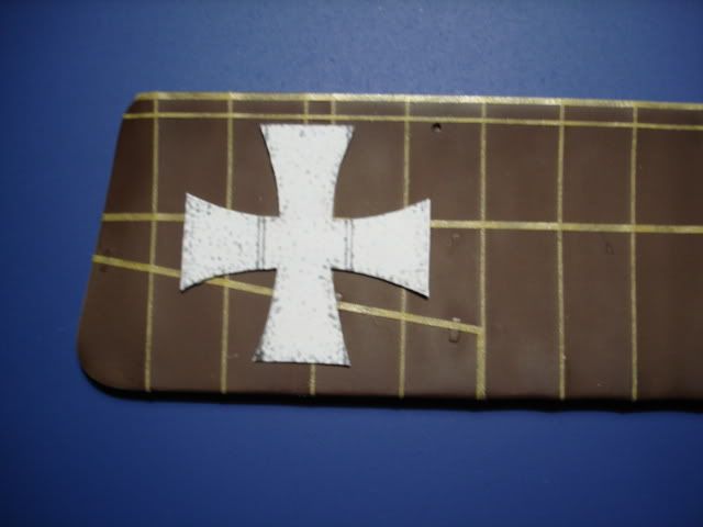

Posted: Tuesday, June 08, 2010 - 05:56 AM UTC

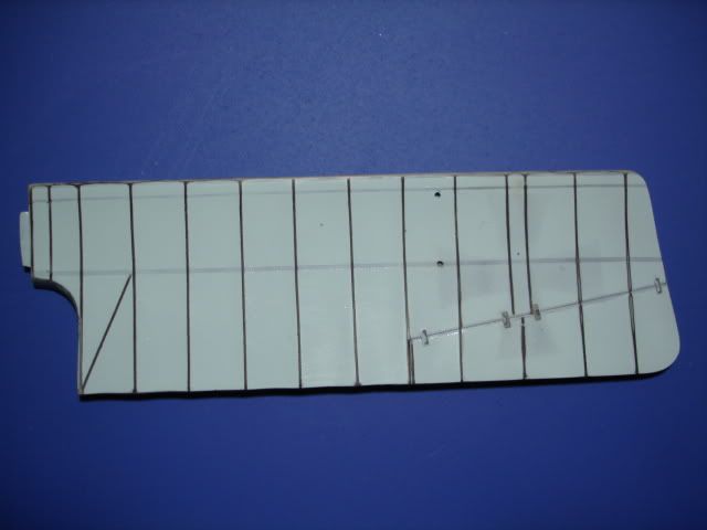

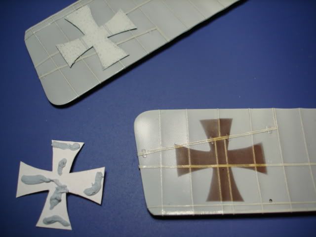

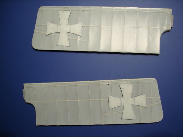

Masking the ribs, spar and the crosses.
for the color i use Gunze White + RLM78
first remove the cross
another hand of thined paint
then i remove the spar tape and give another hand of thined paint
agiosdimitrios
Thessaloniki, Greece / Ελλάδα
Joined: April 15, 2008
KitMaker: 90 posts
AeroScale: 89 posts
Posted: Tuesday, June 08, 2010 - 06:04 AM UTC
then the ribs and another one hand of paint
the same way for the lower wings and the tail
Next come the uper surfases of wings and tail

Posted: Tuesday, June 08, 2010 - 07:20 AM UTC
Great stuff and thanks for demonstrating this build.
May I ask what the masking of the cross is for?
and are the brown lines rib tapes or will they get further shading?
JP
agiosdimitrios
KitMaker: 90 posts
AeroScale: 89 posts
Posted: Tuesday, June 08, 2010 - 08:36 AM UTC
Thank you John Paul, Well the reason of masking the crosses is the same that i mask the spars and the rib tapes and for being more understood i explain. At many aircrafts of the period and especialy those covered with clear doped linen if someone look under the wings when the light cames from above it can see almost all the details from the wing structure, the absence of colour makes the fabrick almost ""transparent"", so the same is for all the Rollands painted with that pale blue-gray colour, if for instance look at almost any period photograph of the type this is an obvious evident Now the surfases that are more close to the fabrick of the under side of wings are more sharp as an image thas the ribs, the spars which are a litle more far they looking altle fade and as for the crosses that their painted black to the uper surfase of the wings, you understand that must apear just alitle. I dont know if i gave you to anderstand what i mean because of my bad English,if i dont please forgive me. Please check carfully as much photographs as posible and you willsee what i try to represent.
