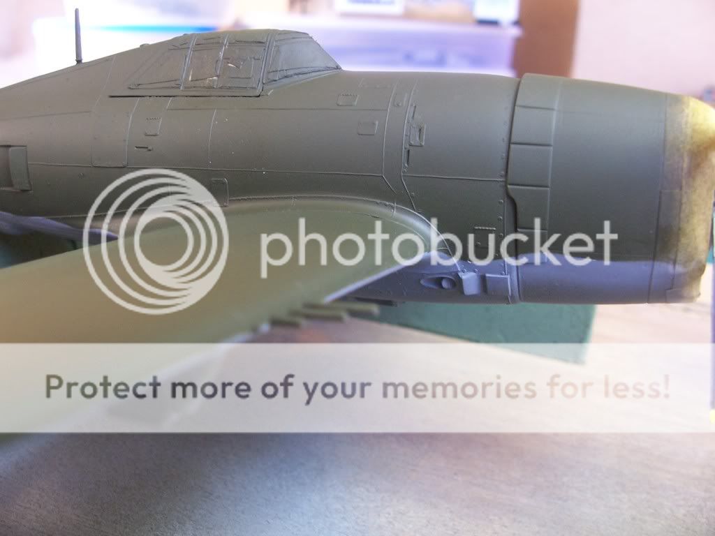

G'day Noah,
I use Tamiya tape all the time. The way I do it is to cut some very thin strips and place these around the edges of the masked areas first. The thin strips are much easier to get in nice and tight and to burnish down with a toothpick. Then I fill in the area with a larger piece or maybe two, which don't have to be cut exactly to shape, they just have to ovelap the edge pieces.
You can see it in this shot af a P-47 where there's multiple small pieces in each square of glass.
If you want to certain that there is no paint getting under the tape you can give the canopy a thin coat of clear AFTER you mask but BEFORE you paint, this seals the edges, then you go around with a sharp knife and cut along the edge of the tape before you peel it off.
