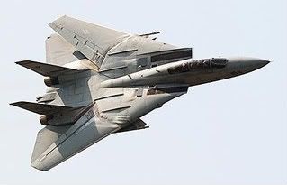

Russell, the preshading is just to add depth. It's another form of weathering. I agree with what you said about real aircraft not being preshaded before they are painted, but the whole preshading thing is for weathered-worn-used aircraft. Check out this pic:
This isn't the best photo but you see how the panels on top of the fuselage just in fron of the tail fins are shaded. This is what I go for when preshading.

P.S. I see what you mean Hermon, I understand the reasoning I just don't do it, of course I rarely weather my models because I'm afraid I'll screw them up! Ha ha
