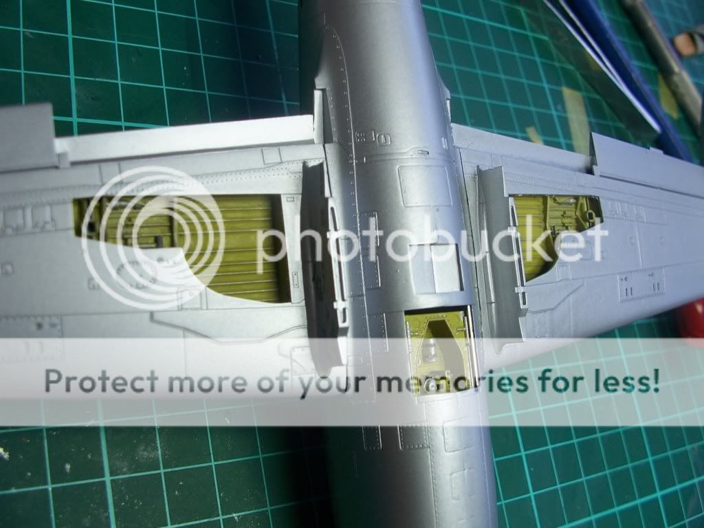

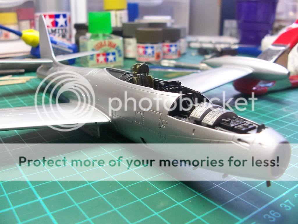

KitMaker: 6,244 posts
AeroScale: 3,486 posts
Posted: Thursday, November 12, 2009 - 08:07 AM UTC
Hi JP, I used Tamiya AS12 from the spray-can on the F-84G I recently finished (YAY!), it is easy to use and gives a great low-sheen finish.
Posted: Friday, November 13, 2009 - 12:32 AM UTC
Yes JP, sprayed straight from the can. I haven't got the intestinal fortitude to try decanting and airbrushing just yet, and I'm very happy with the finish from the can.
