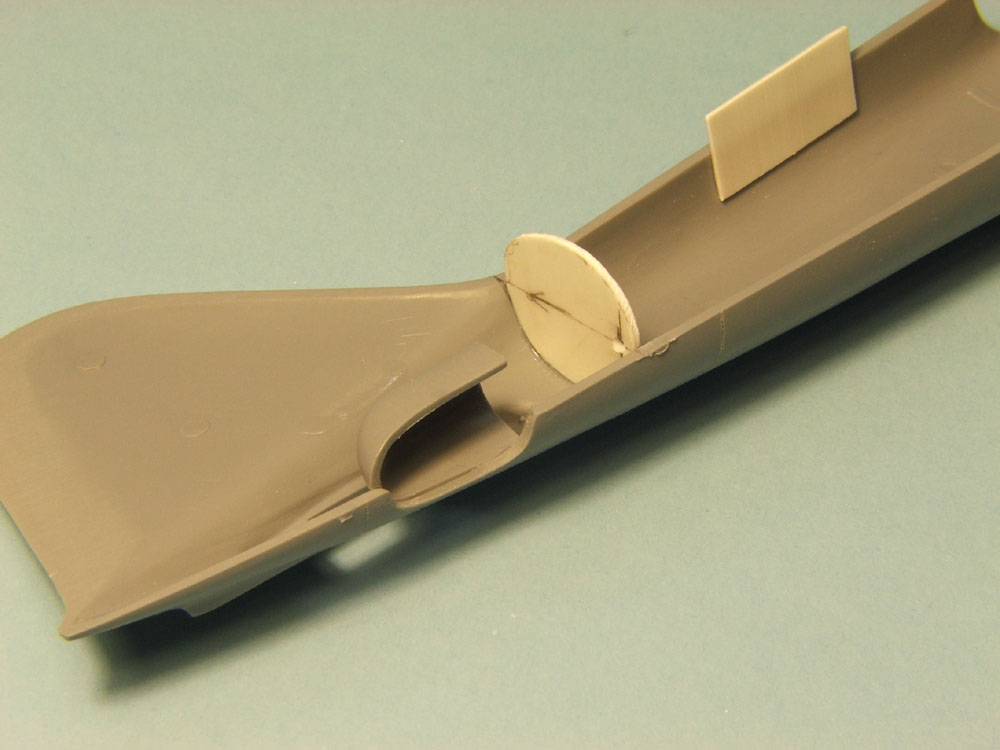

I am getting close to gluing the fuselage halves together and have a couple of questions. Where does the tail wheel assembly attach to the fuselage? There seems to be nothing but thin air where there should be a bulkhead or support to take the tail wheel parts. Nothing is indicated in the instructions and I did not see anything in the build up that Steffan linked to . And why did SH mold the tailwheel assembly, the strut and fork, in 2 separate parts? Also, in the new 4+ book "IL-10 Colours and Markings" they state that some of the Czech built B.33s were painted with a topside fuselage colour of "Smalt Avion 2036 Khaki". Does anybody know of a hobby paint equivalent of this colour?

Here is the only picture that shows that area clearly .. and Kubrt built in the wheel at a much later point of the construction
Posted: Friday, January 30, 2009 - 07:37 AM UTC
Hi again
here is a pic from Monogrfie Lotnice 22

Thanks for posting the pic of the tailwheel assembly bulkhead. That helps alot.
