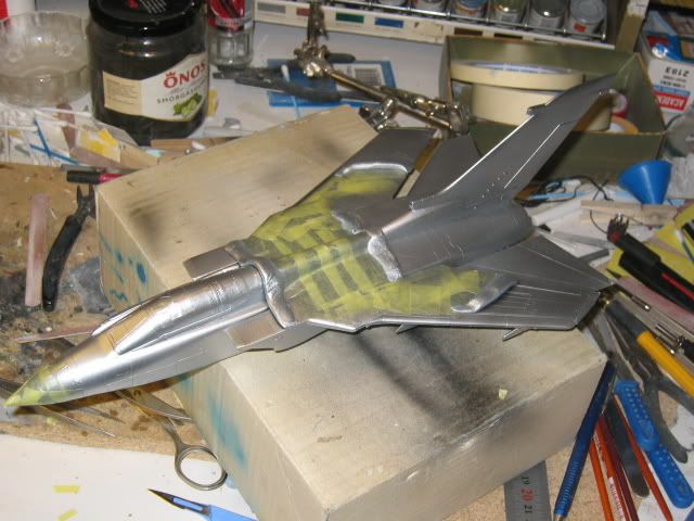

Now I have painted the seams grey to check for any blemishes as you can see here;
There´s one or two spots that will be treated once again, but overall it looks good.

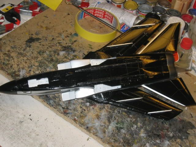

i have been working hard on my stubborn Tornado, and I´m making some progress!
Really....

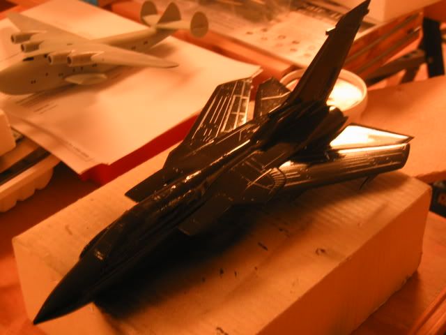

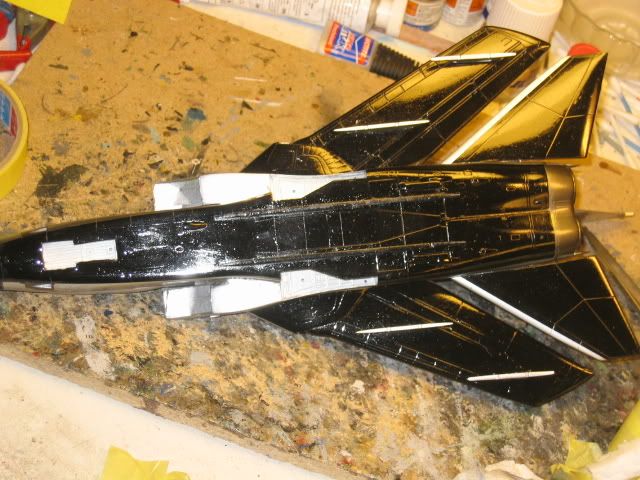

After some small seam-correcting tasks, I gave the model a final coat of grey primer.
Then i could paint the whole aircraft in a handsome gloss black.

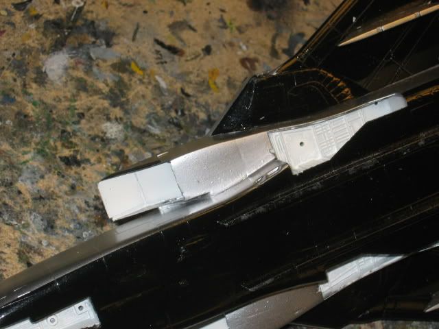

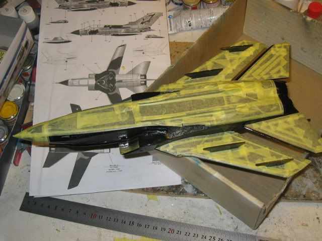

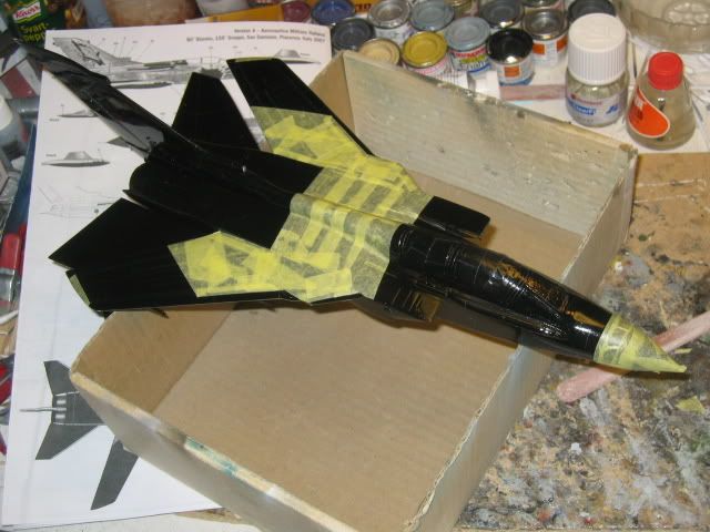

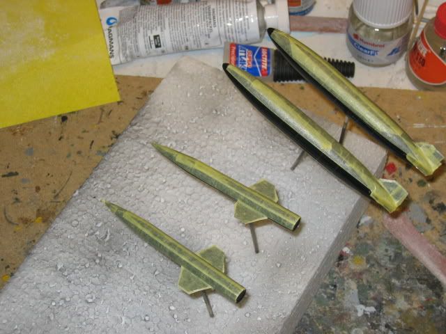

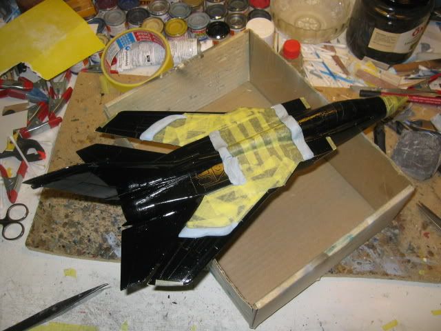

I left it for a few days, and then it was time to do some masking.
It´s more masking then you can believe on this kit, actually!

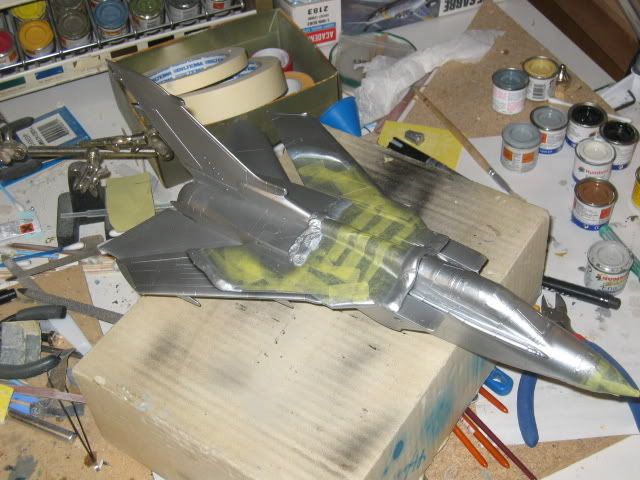

To get a softer edge I used blue-tack "worms";
Then a coat of Alclad White Auminium;

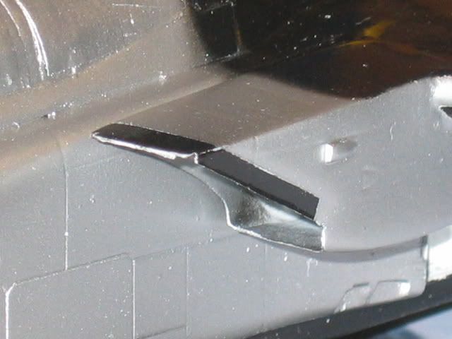

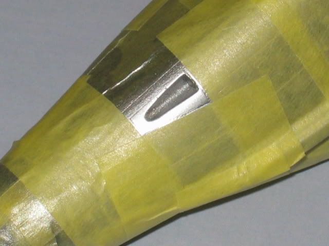

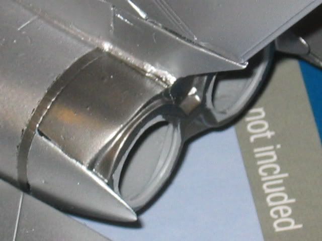

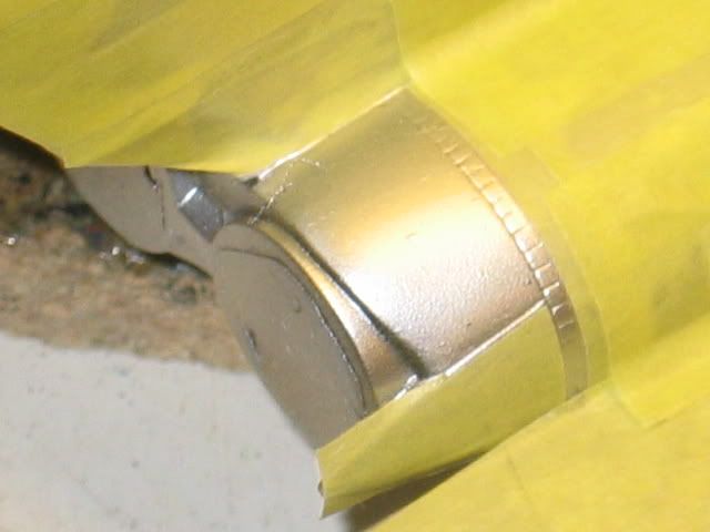

More masking to paint the panels around the exhausts Alclad steel;
same around the guns;

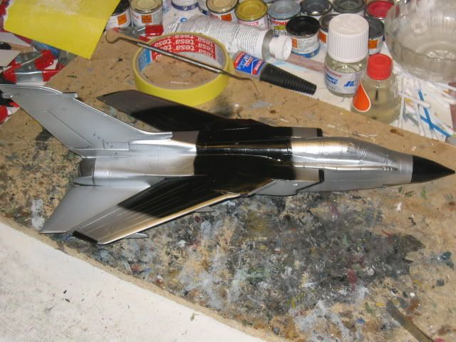

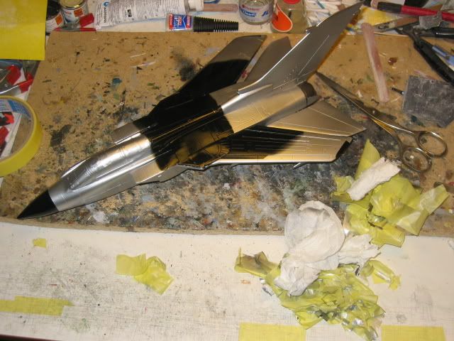

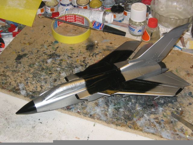

Then it was off with all the masking!

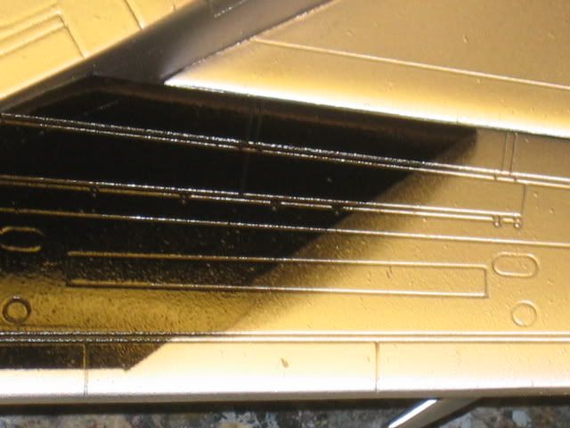

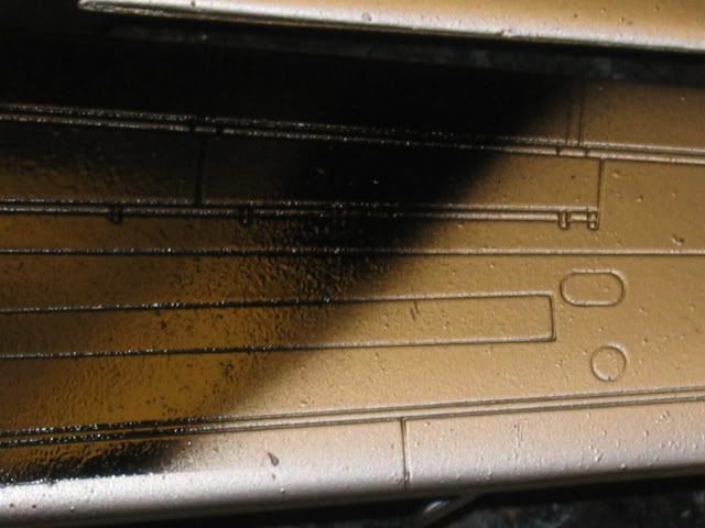

I wasn´t careful enough when masking the wings so I got this;
Not good enough so I did a respray freehanded;
Much better now, eh?
The model after painting is completed;

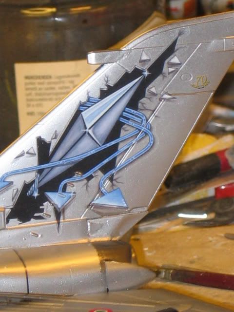

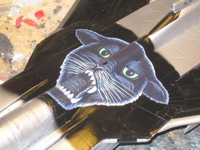

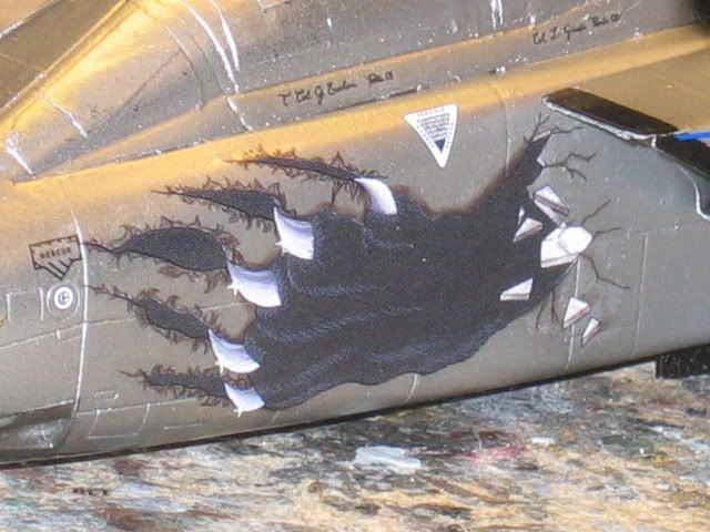

Then it was time to get some decals on the Tonka!
These are from Cartograph and posed no problems whatsoever!
Beautiful colors, perfect print, opaque and very easy to use!
Only hard spots was over the vortex generators(?) on the fin, and the big cat-face on the spine.
But with Micro-set and -sol, and a bit of careful slicing with a scalpel, it worked like a charm!

Stefan, nice save on the painting. The decals look great in place. This is going to be a colourfull bird.
