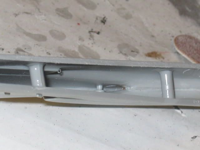

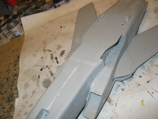

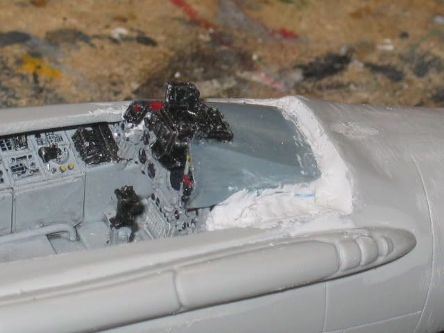

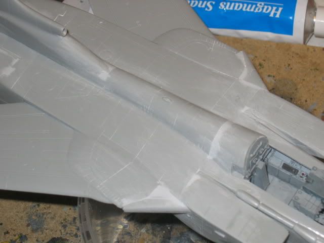

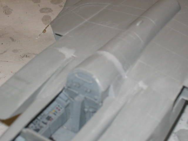

Time for a new update on the troublesome Tornado!
First I had to fix the problems caused by myself when I joined the front and aft fuselages.
It took a great deal of filling and sanding, but I believe it´s acceptable now.

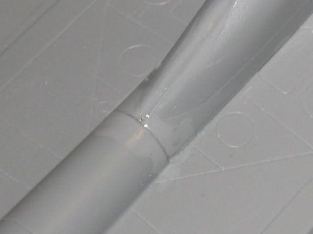

Then I assembled the fin, and found it to be a tad too narrow to fit properly, easily fixed by a pair of spreaders made from sprue.
The fit could have been better where the fin meets the spine!

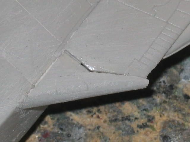

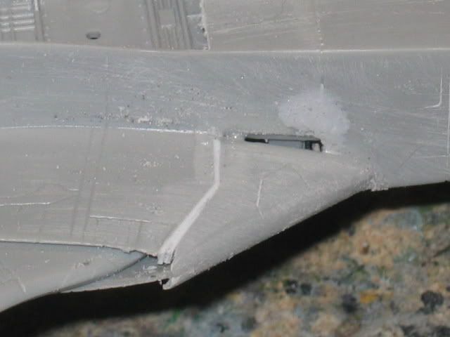

The glove vanes(?) at the leading edge of the wings was a really poor fit, almost non-existant!
This was the best I could do on the upper side.
Below I had to fill the cavities this caused with small pieces of plasticard, cut away the excess, then mucho filler and sanding followed!
The nose cone was added, plus some weight to avoid tailsitting.
Well, some sanding was needed here too!

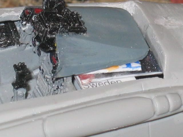

When I tried to mount the hud I realized I had removed too much plastic so I had to build a base from plastic card again.
Worked good tough and It won´t be seen when finished!
Really can´t blame the kit for this!
Some filler around the edges help hide the filling!

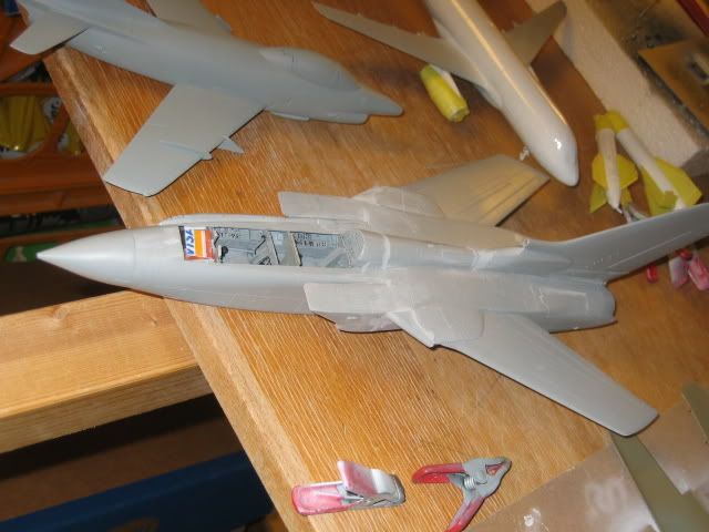

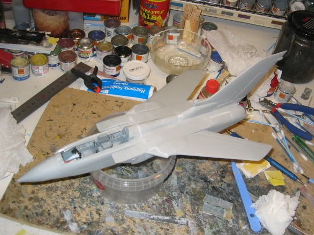

Now she´s beginning to look like a proper "Tonka";
Here you can see how much filler I have been using, almost every join needs filler on this kit!

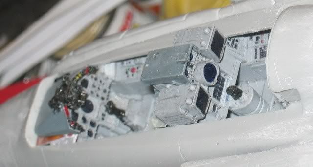

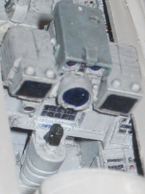

Rear seaters instrument console glued in place.

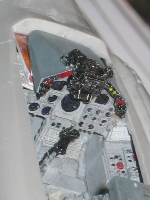

Pilot´s office;

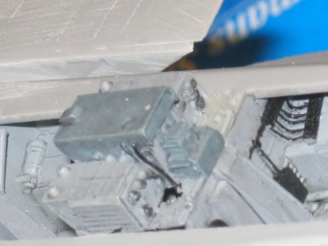

Completed cockpit (seats are done but not fitted yet);
I have been sick and tired of this kit for a while, thus the slow progress!
But now I feel the painting is next and the build is starting to get that good feeling again!
More later!

Stefan! That is really some impressive lack of fit! By the way, you seem to use up quite a lot of credit cards, doesn't your bank get curious when they end up in you builds at this rate?
