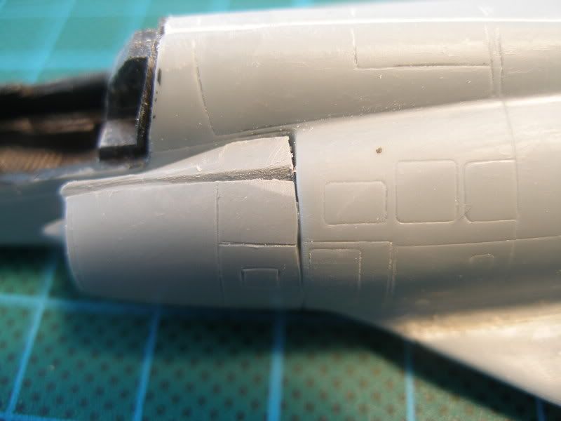

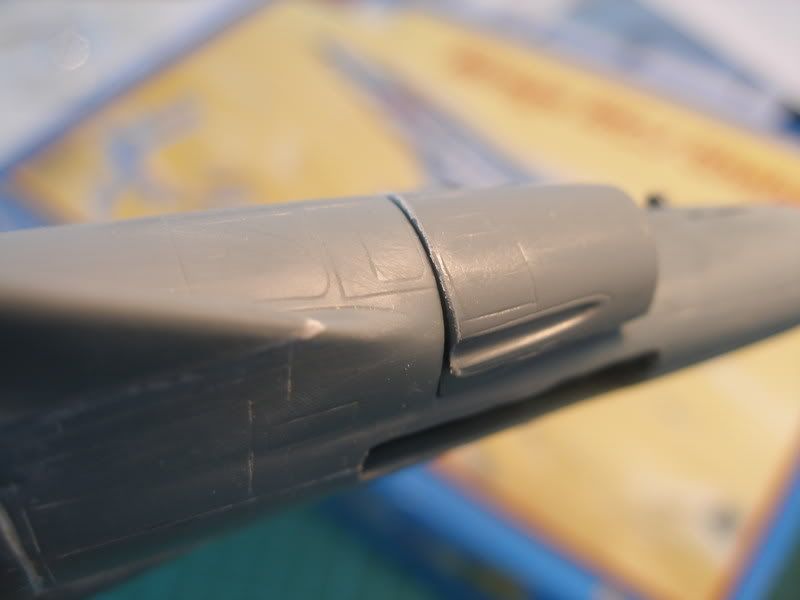

My plight with the AML Mirage IIICJ continues... I've been forces to make my own special sanding sticks in order to reach all areas that need sanding, i.e. every single seam!
Unfortunately, the fit of the short run kit is not up to par! The plastic seems way to thick! Here are a couple of progress pics that illustrate the problem.
A) Dryfitting the intakes. The intake (2 parts) sticks out at almost 2 mm (not good in 1/72)!
B) In order to avoid having to destroy the surface detail, I had to do some heavy sanding and trimming on all other areas. - This is not a pretty sight!
C) I've tried to fill the gaps (read canyons) with superglue, but I find that method very hard to work with. I'm not sure I'm doing it right. (Can't see the glue = Can't see the result). Instead, I'm doing some "filling without sanding" (masking of all other areas except the gaps, filling them with putty and using Q-tips with acetone nail polish remover to smoothen the area). It looks good so far, but how will it come out under a highliy polished aluminum finish!?!
Anyhow - Who said that modelling should be easy / fun / painless...?

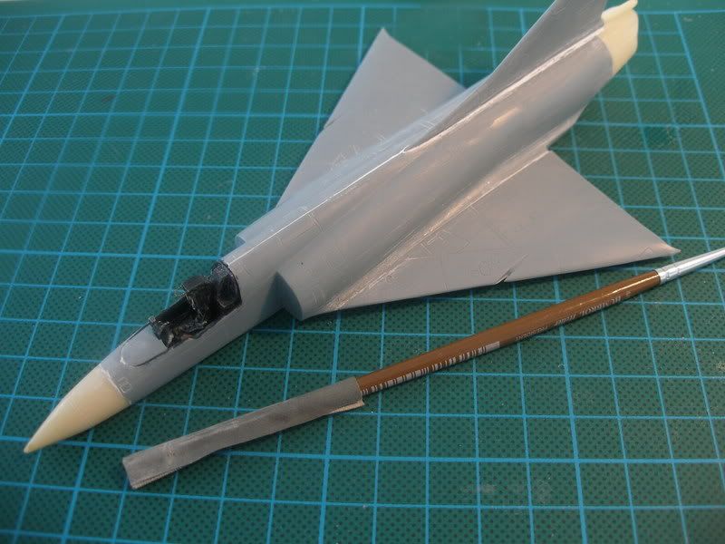

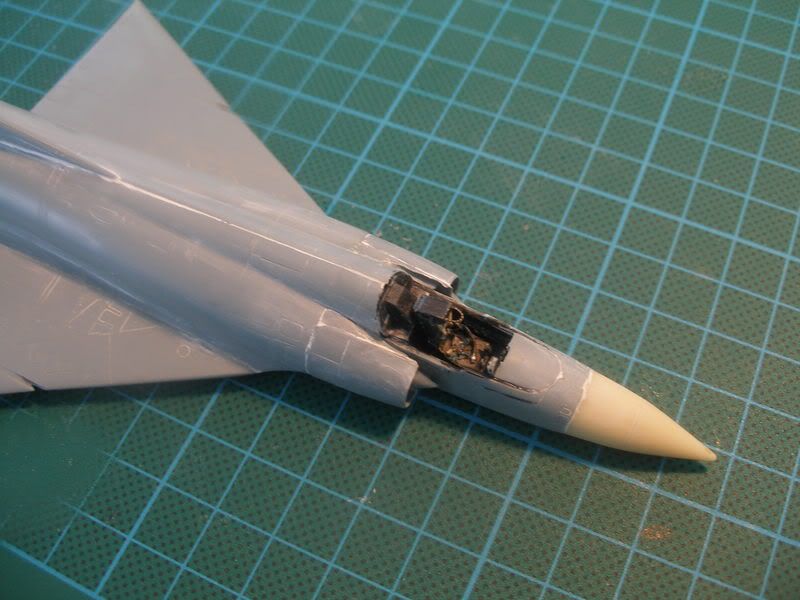

Thanks for the nice words, Tony! Your 109 is comming along nicely, btw! Too bad about the auto-censoring! Now go wash your mouth with soap!
I will not give up just yet! I needed to attack the canyons at the wing roots. I did not want to sand down the upper surface of the wings and loose all the panellines and surfce detail. Instead, I decided to try and raise the plastic at the very wing roots (there are no panellines there etc).
First a layer of carefully placed putty and some sanding. The canyons became more shallow, but the surface became rough and ugly (= a "no go" for the NMF). Since it is more or less impossible to do any delicate and/or effective sanding at this area, I needed to try something that would come out smooth from the start. The method that I opted for is to apply multiple layers of future (approx. 10 by now). After each layer, I've raised and dipped the model every now and then for short period in order for the future to cure as smoothly as possible . Then a long wait until the next layer...
Remember that this is an experiment! It starts to look pretty ok, albeit that some sanding will be necessary. The question is, though - Will it be good enough for NMF!?!
