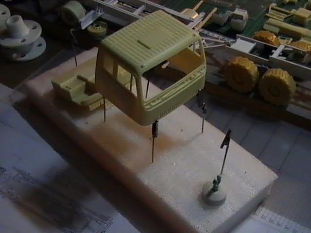

Hi there
A good cheap purchase to to add to your list includes tooth pics and crocodile clips. Buy the type with a cylindrical end that you crimp the electrical wire into. Instead, crimp the clips onto the end of tooth pics.
Get hold of some pieces of polystyrene packaging of various shapes and sizes and you can use the crocodile clips for holding small or large parts for spraying, detailing or glueing parts together. A whole vehicle can be supported on a sheet of styrene as a cheep and very versityle model clamp with clips stabbed in where ever you need.

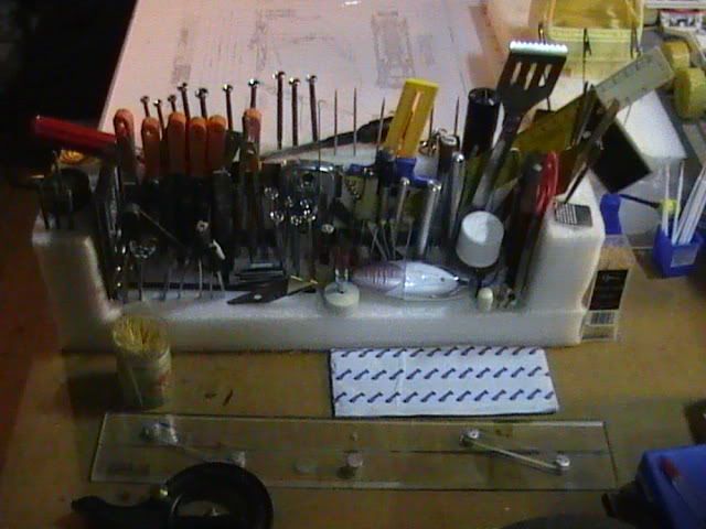

Tools including tooth pics (with or without clips on) can also be stabbed into a strip of styrene keeping them handy on your work bench.

This is a good way to work on your models and is dead cheap. Polystyrene or foam packaging is free and plentyfull to make support platforms for work station platform , spray paint booth supports, drying area support, tool steady and hand support for painting by brush.
Now I have space in my shed, I have pressed craft knives and other tools into several foam bases dotted about the shed set up for the various purposes, painting glue setting, cutting area, drawing, etc.

Nice one Nige!!!
Excellent advice.
